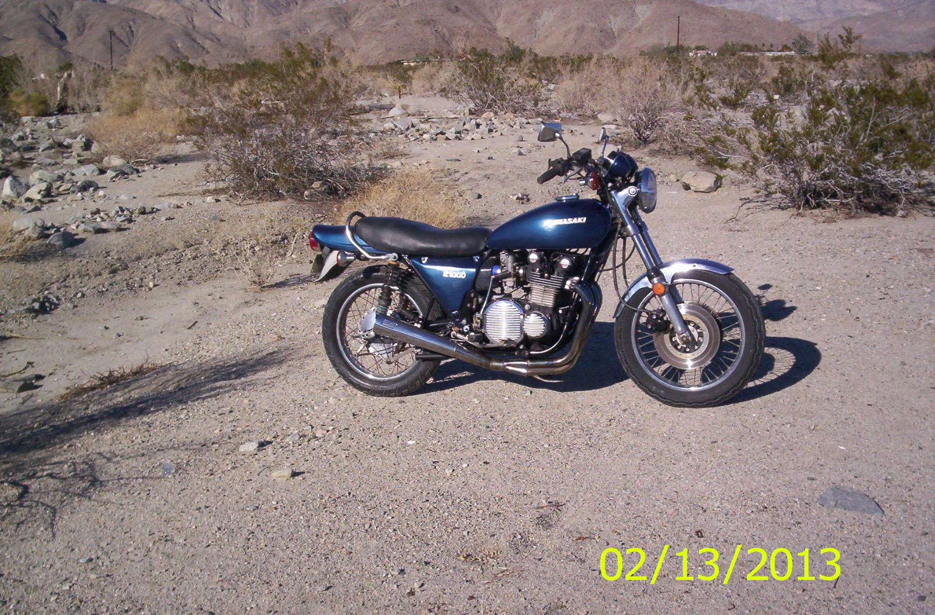

Can you post a side view pic?

Of course. The comparison of the two is in one of my clips. I didn't think to take a snapshot of the two. As you can see the tire is further back closer to the fender.
My swing arm mod would be 3" longer and I would have to lose the fender.
