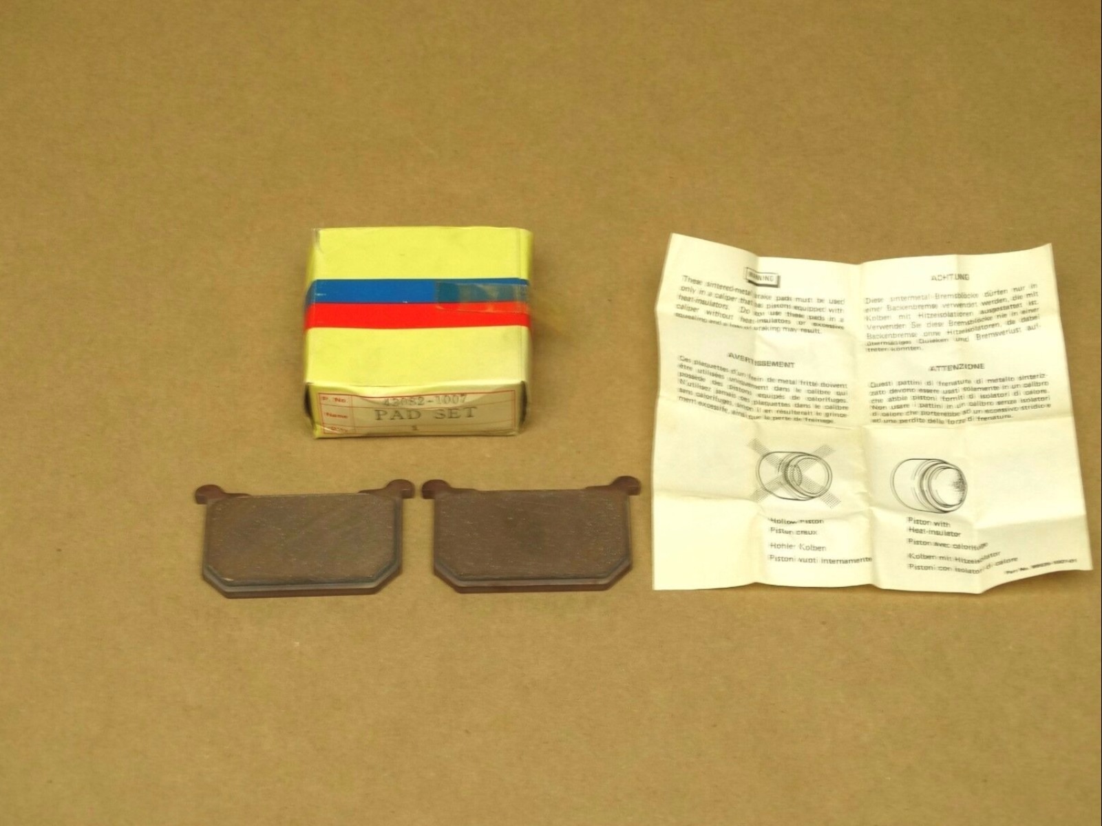

Without knowing you specific bike, I found this photo of OEM pads. Next to it is a pamphlet that looks to identify different pistons possibly used in the caliber. Possible there are different pads relative to the piston configuration?
Last edit: 29 Jun 2020 11:21 by Mikaw. Reason: Spelling

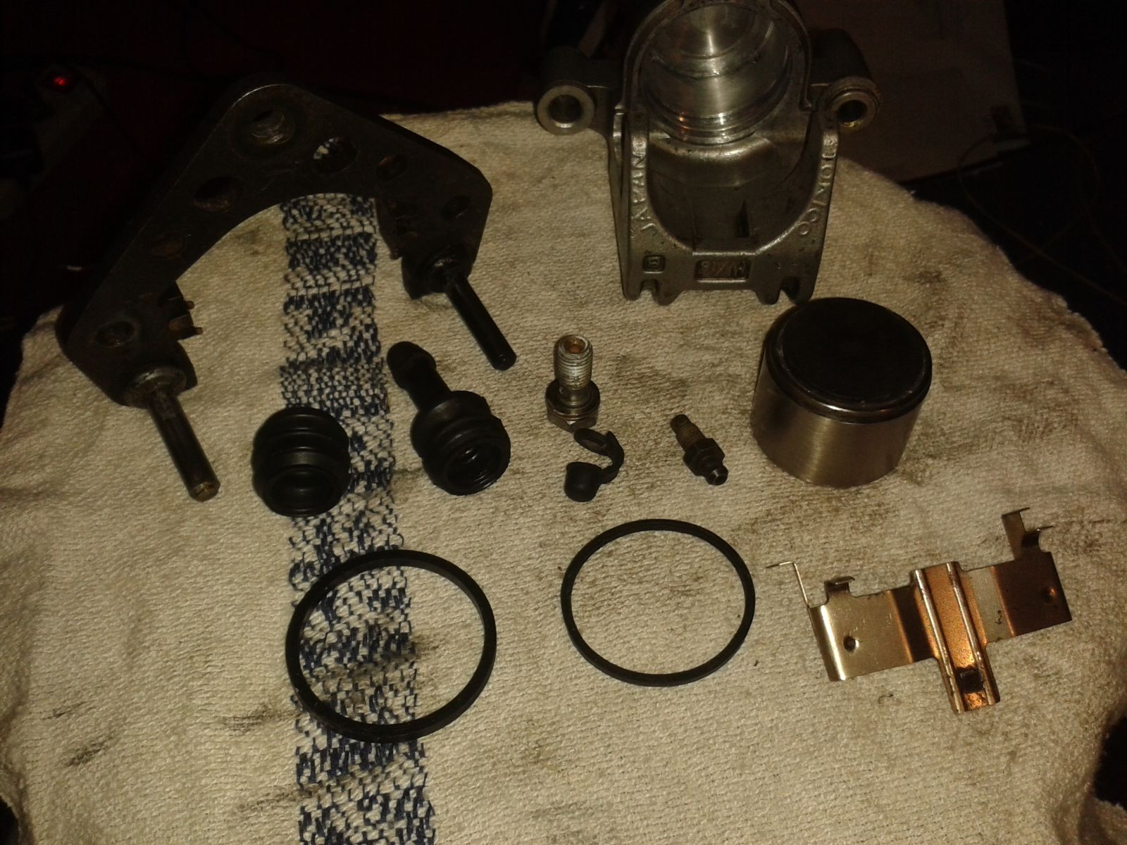

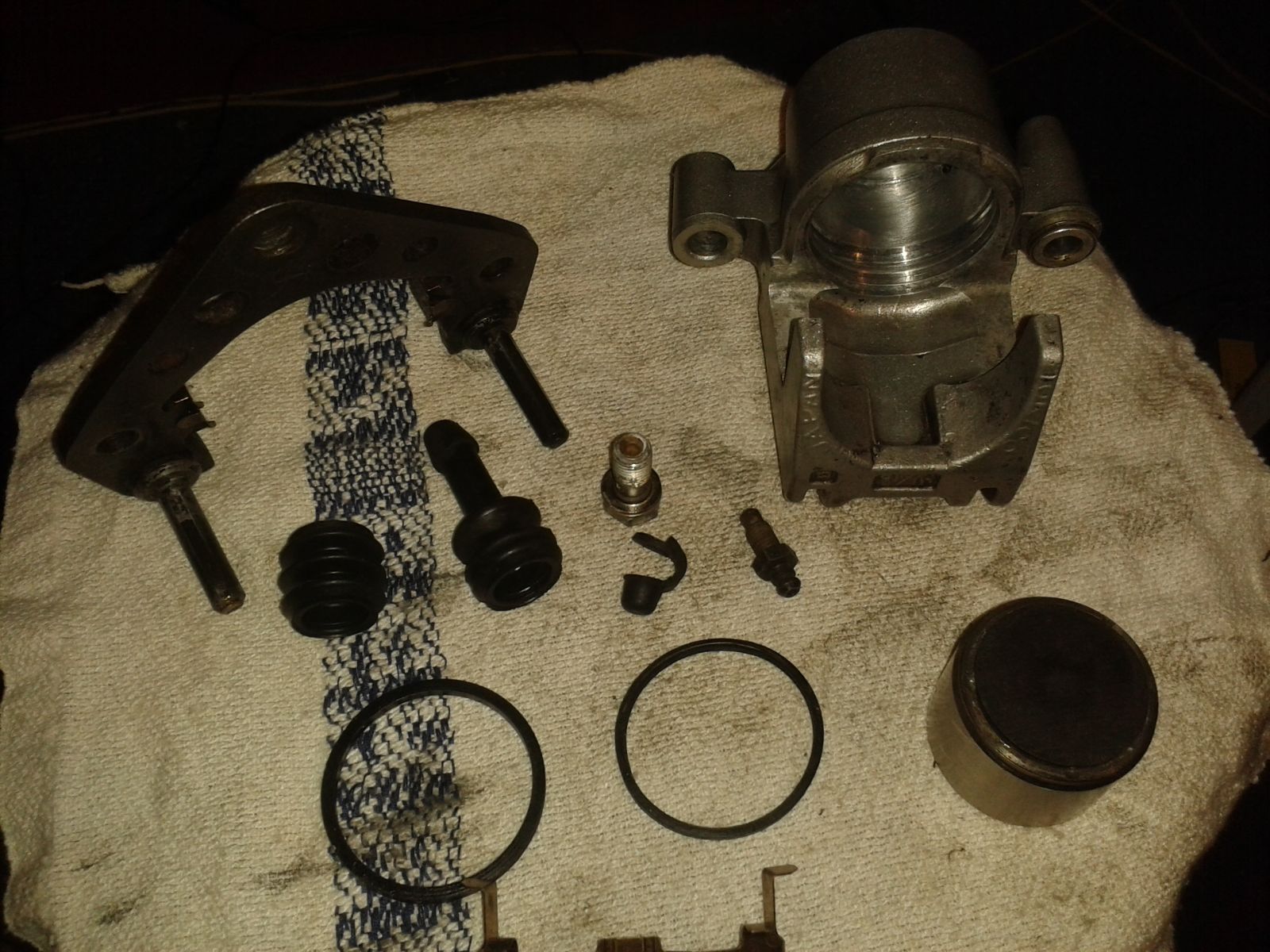

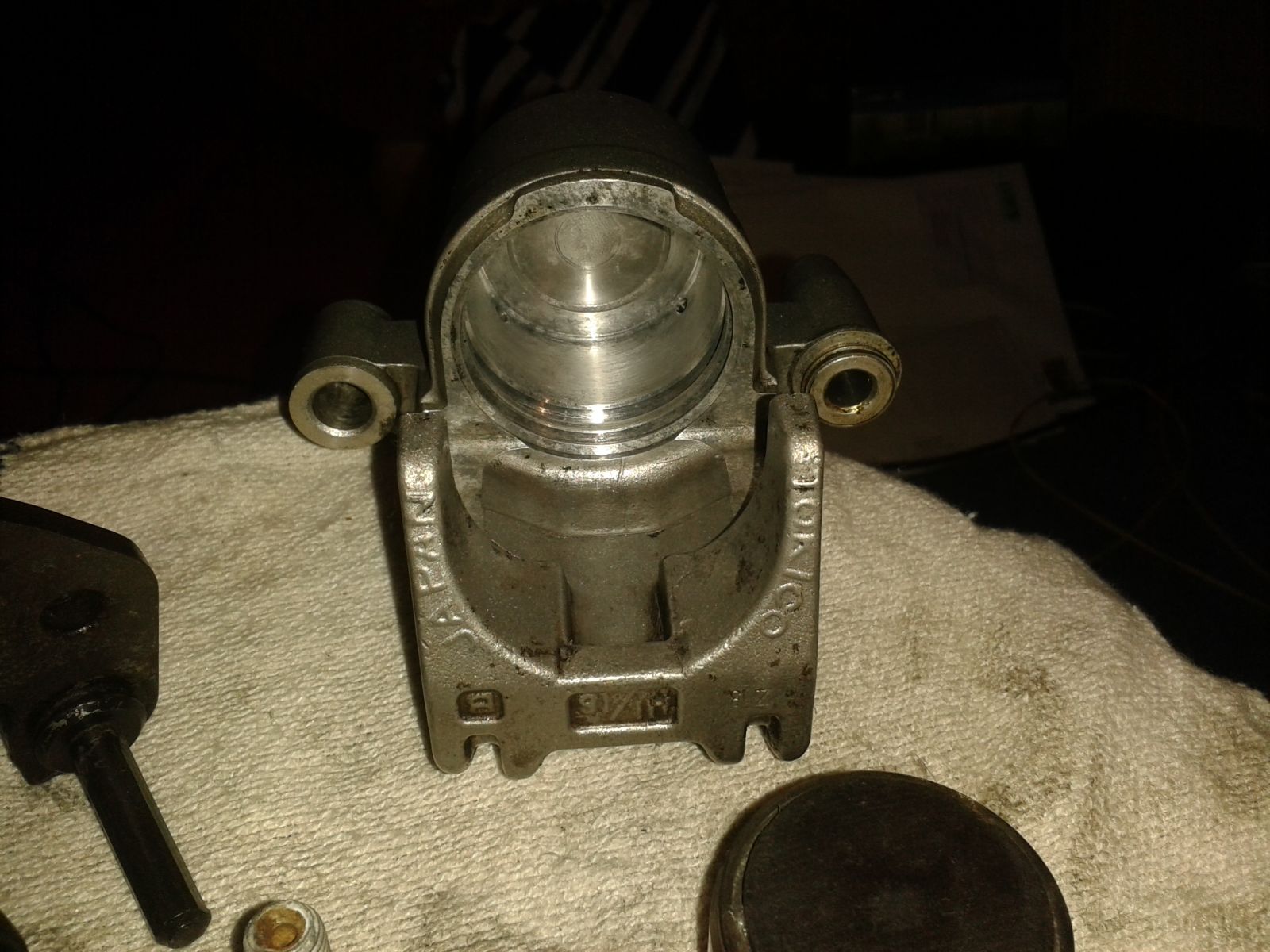

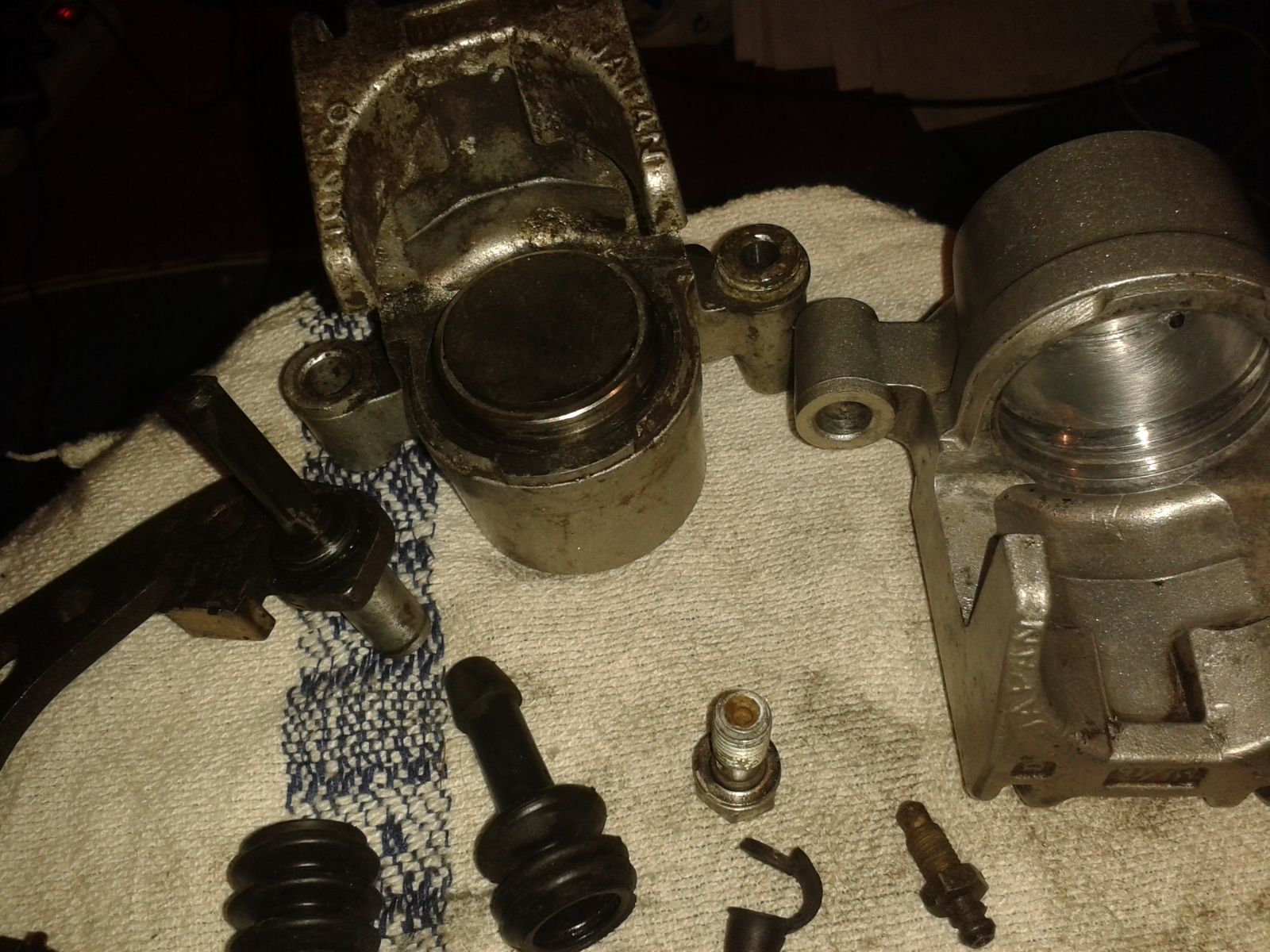

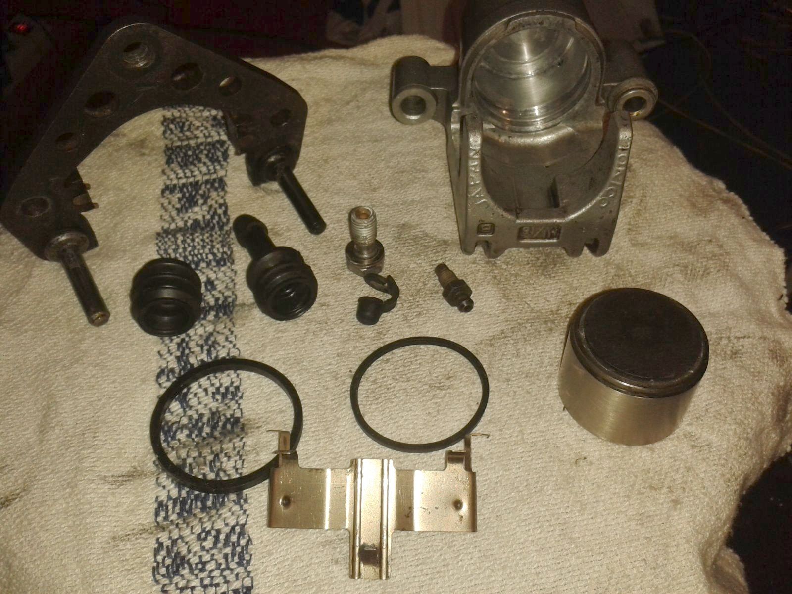

Re: Brake Pad Replacement - KZ750
29 Jun 2020 14:00
You have to give all caliper parts a good clean!!! This required a total disassembly of all parts!!!
You will be surprised what you will find inside the caliper, don“t trust the first view from oudside!!!
