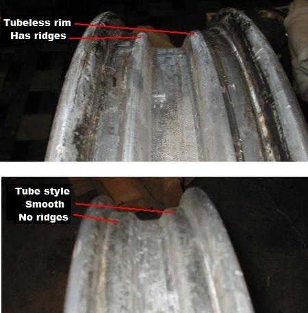

The tire doesn't care if there is a tube inside; whether or not a tube is used depends on the rim. Tubeless rims have been checked for porosity and the stem hole is properly profiled for a tubeless stem. Most tubeless rims have a profile with two humps too, to keep the rim on the bead in case of a deflation, but not all tubeless KZ rims do. It's another of thoes condrumdrums which shows there are no definitives when it comes to this sort of stuff.

As an example, the rear wheel on my K1977 KZ650-C1 (and on some other models) has two rim lock holes in addition to the valve stem hole. Those holes are there to accommodate rim locks which will keep the tire from slipping on the rim during hard acceleration since that slippage can tear the tube valve stem off the tire (this happened to me on my BSA). Obviously, if no tube is used those rim lock holes will immediately leak air, but even if one was to weld them closed the valve stem hole is not made to accommodate a tubeless valve stem type. Besides that, even of one was to also modify the valve stem hole the wheel casting is not necessarily without small air leaks since it was built for a tube, and the wheel shape is not designed to hold a tubeless tire in place if the air pressure gets too low. Below is a picture of the humps that Nessism mentioned. Ed

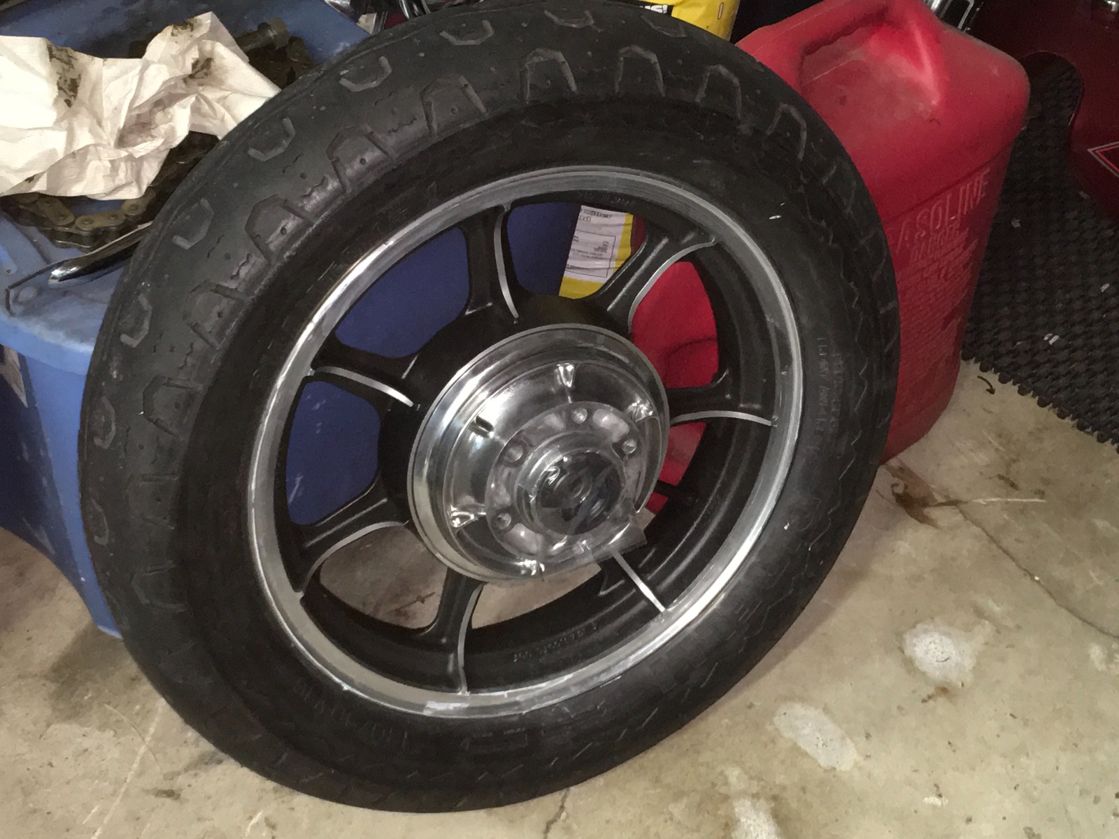

The idiot that owned this bike prior to me had used fix a flat in both tires. A LOT OF IT!! I cleaned the f*** out of 'em, .. cleaned them the best I could. Both tires leak in several places between rim and tire. Stumped!
Some people should not be allowed to own nice things. I guess tubes are your best option short of replacing the wheels.

I just finished cleaning up and light polish on the rear mag. Still need to buff off wax. New crush drive, bearings and seals. Tube is going back in. Wheel replacement is not an option . Tire will be though this fall.
