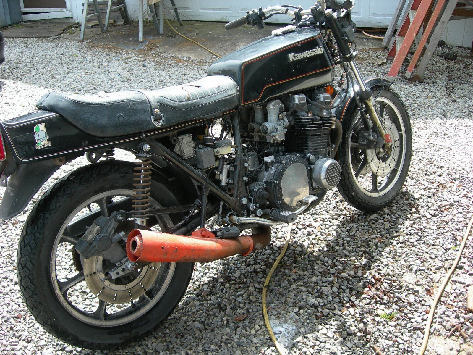

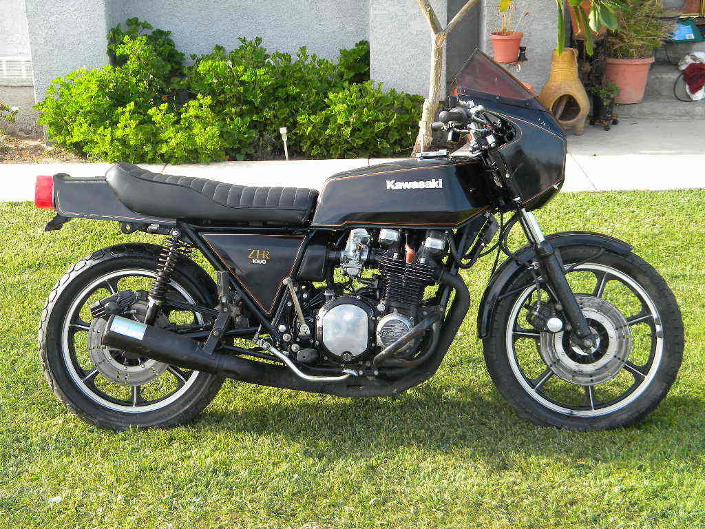

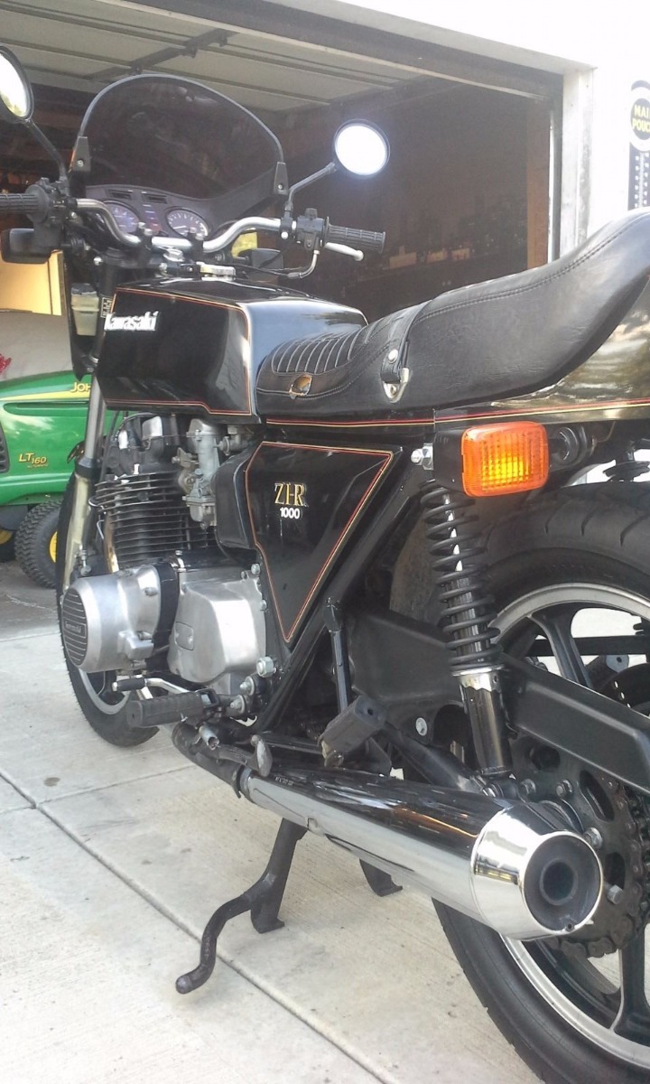

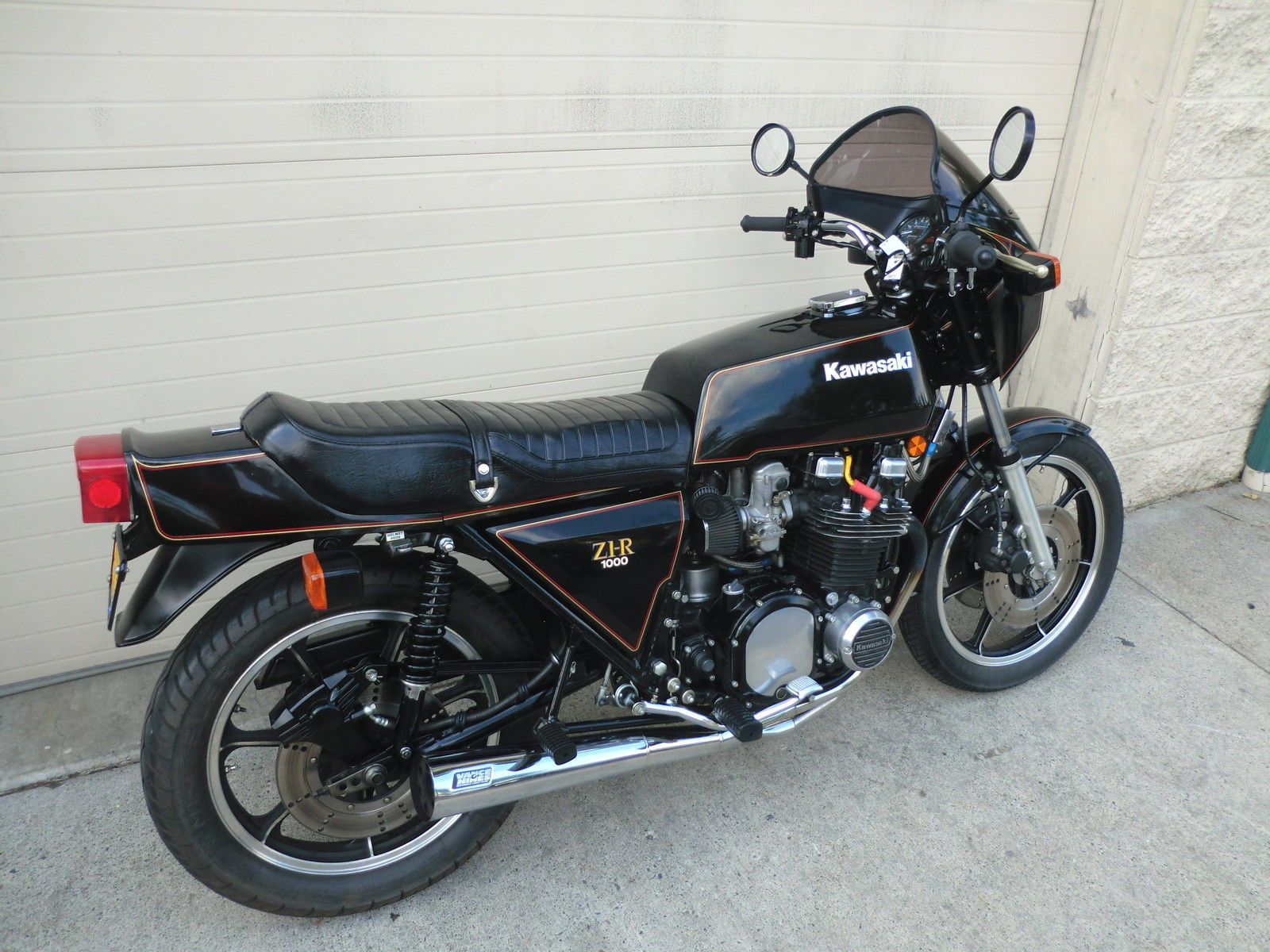

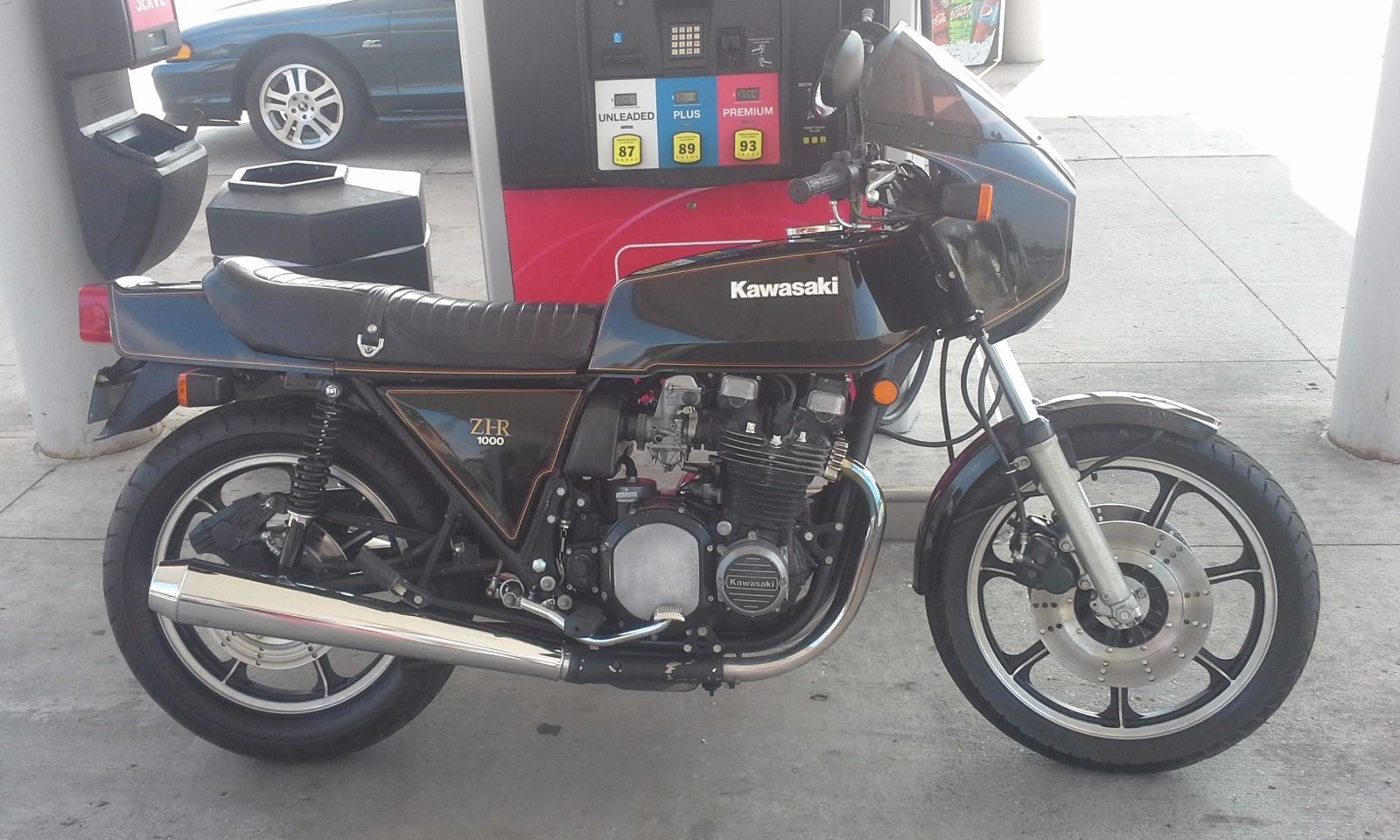

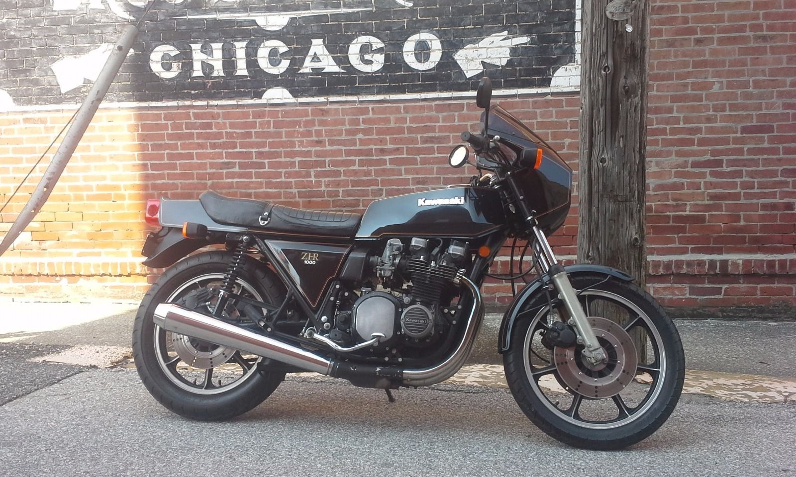

Here are a bunch of pictures from past ebay auctions. Most of these are from different bikes, but one or two might be the same bike. They aren't great, but I don't see a rubber bumper in any of the pictures I've been able to find of OE shocks.
'78 Z1-R in blue
, '78 Z1-R in black,
'78 Z1-R in pieces
My dad's '74 Z1
'00 ZRX1100
My dad's '74 Z1
'00 ZRX1100

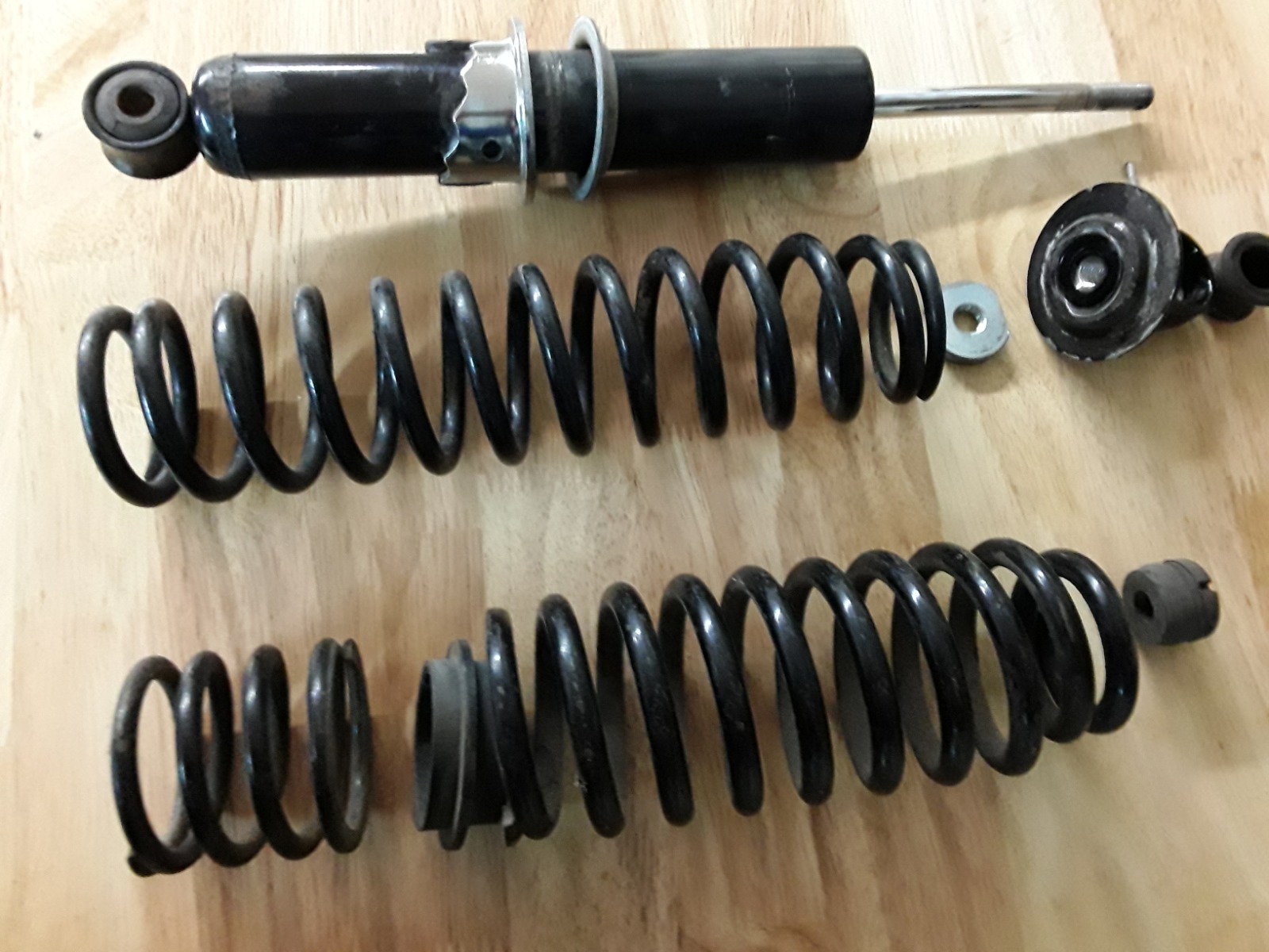

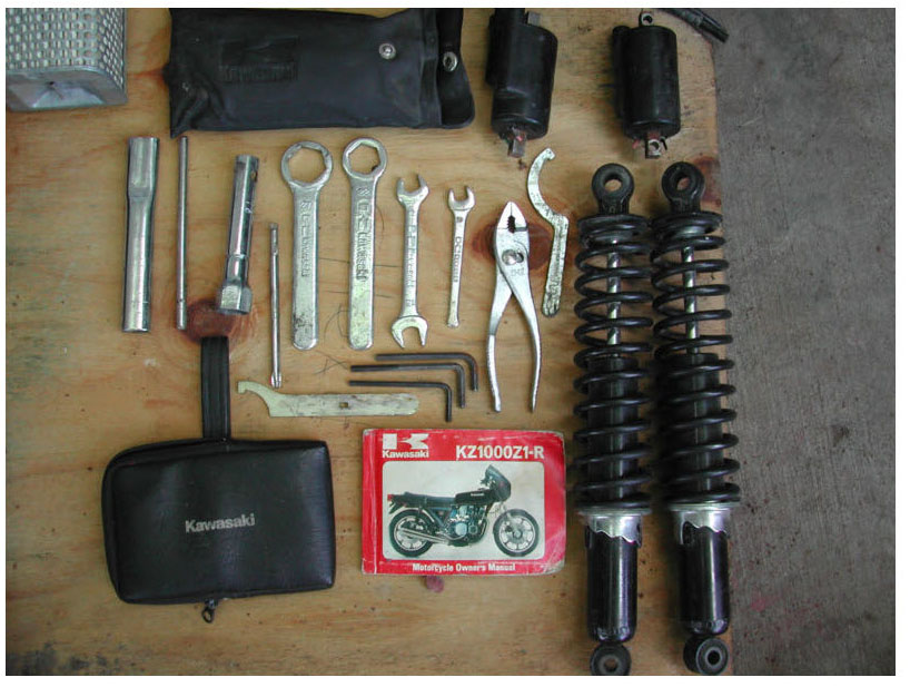

Thanks DOHC ..... I will say they could not have all had the bumpers fall off. I will go with the no bumpers on the 80 redo. For feference, 80 and 78 shocks look the same...78 has dual springs and the bumper.....see pics

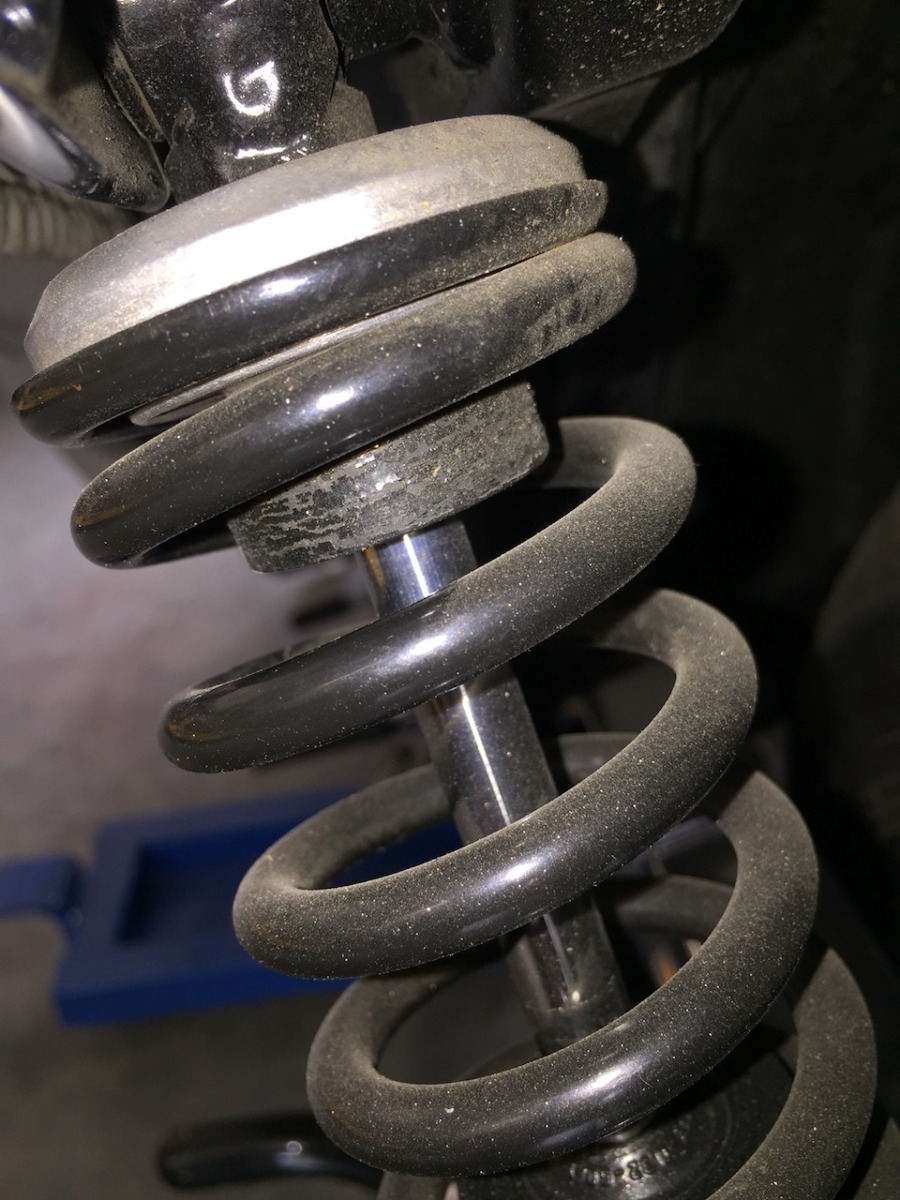

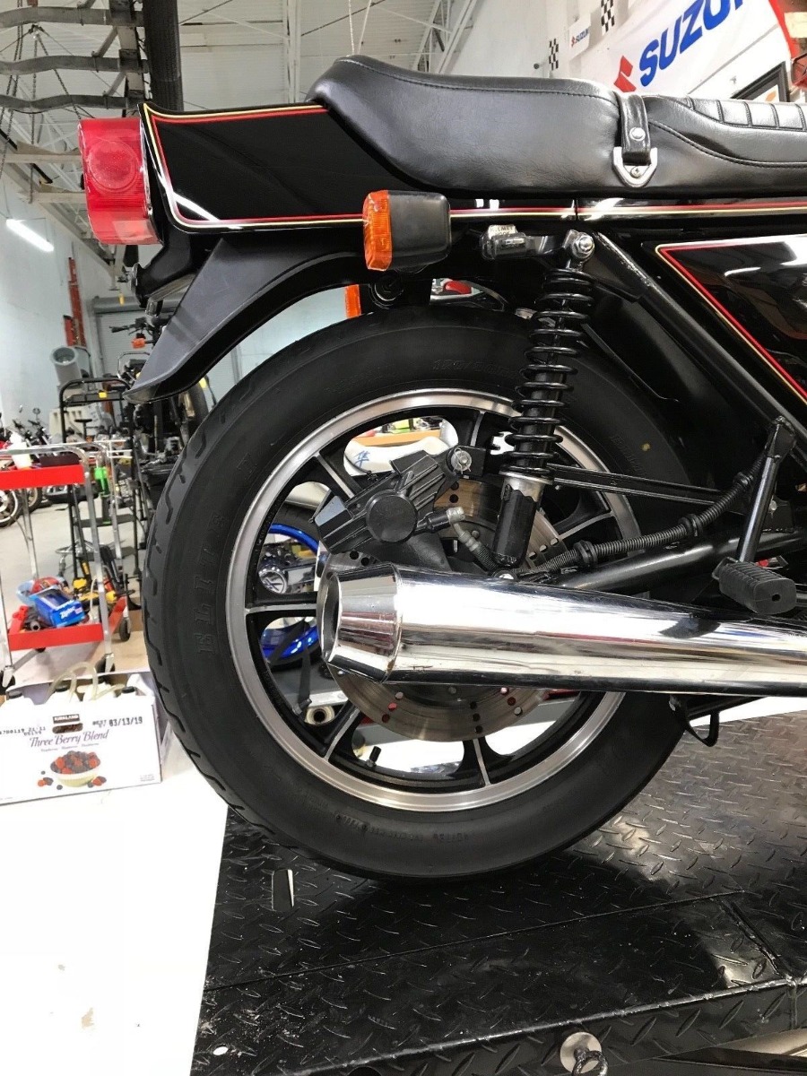

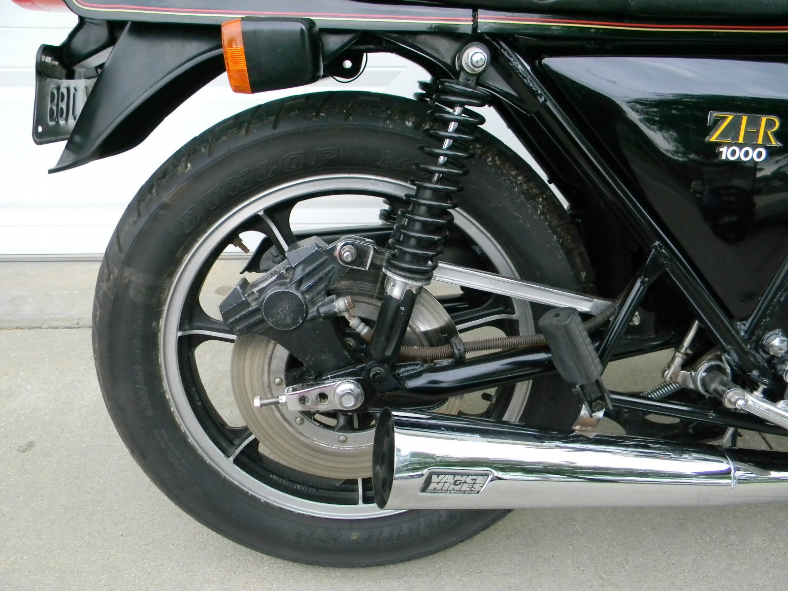

Photos below are my '80 LTD that I was working on in 2015. The first photo shows the shock on the RHS. Looks the same as the Z1R to me. I believe the shock was original to the bike. If you look closely you might see the bumper near the top.
I took the second photo this afternoon. It clearly shows the bumper.
Last edit: 06 Apr 2020 19:35 by hardrockminer.
- DOHC
- Those Doe-Hawks really go!
- Posts: 1271
- Thanks: 600
Re: 1980 Z1R rear shock restoration question
06 Apr 2020 19:58
I believe the LTDs came with Mulholland branded shocks. In any case, yours have an aluminum disc at the top of the spring. The Z1R has a solid black top.

LTD spring and shock are different that Z1R
