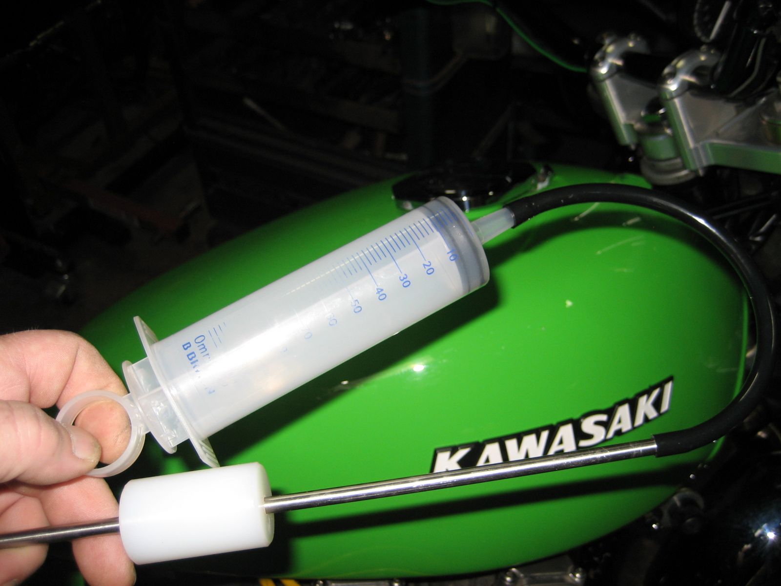

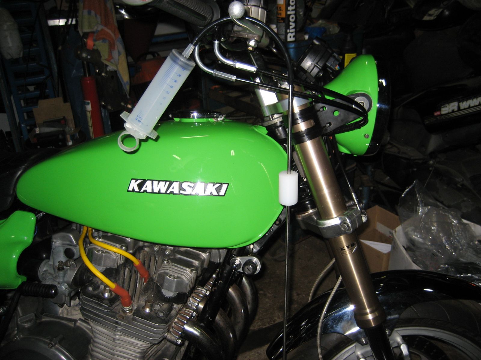

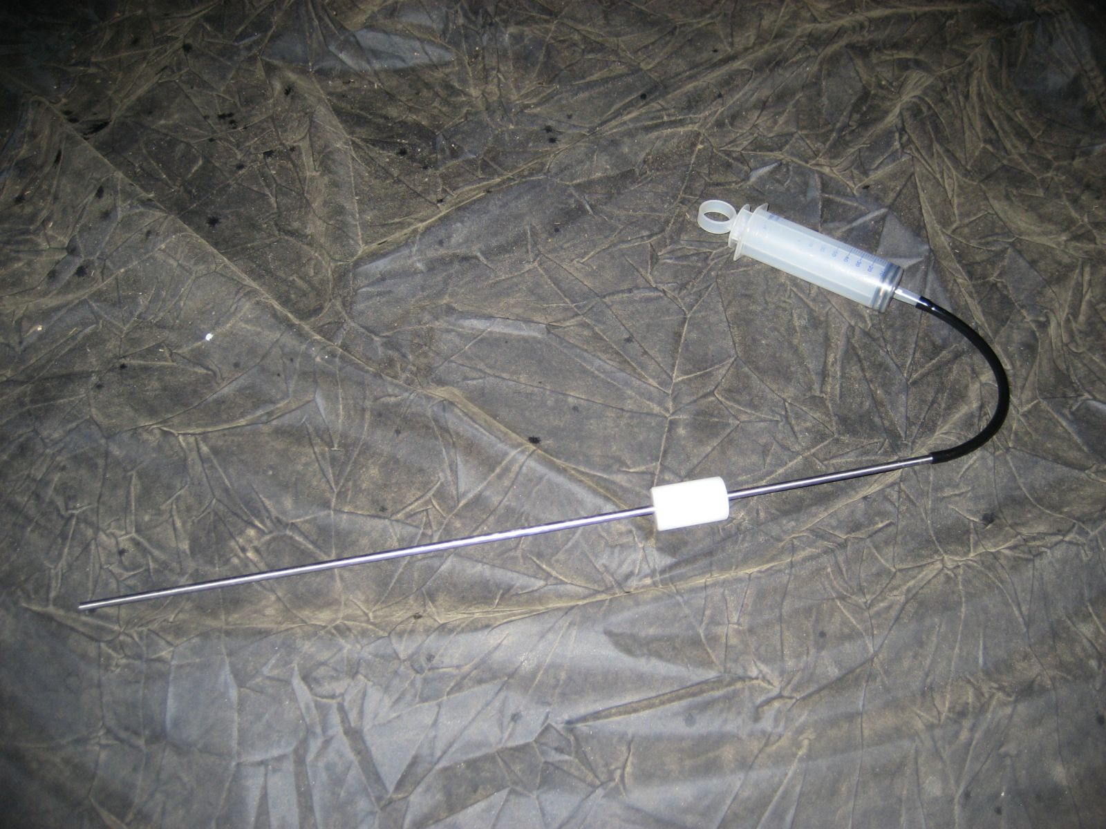

If you do a complete fork rebuild (all internal parts out and dry), you will need more oil as the Workshop Manual prefer!!!
Do fill up oil into the fork tube fully compressed to the 185 mm Level and you are on the save side.
I made this cheap tool to adjust the fork leg oil level.
kzrider.com/forum/5-chassis/606694-harsh-ride?start=24#768981
