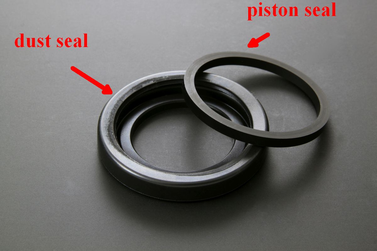

Gonna do a complete brake rebuild soon. Have refurbed the master cylinder already. Pretty confident on the rest of it, do have 1 question though. When replacing the caliper seals, do they go in a particular way or can they go in either way round. Wasnt sure if they had a slight lip or not !!

The caliper Piston seals can go in either way round, they have a square cross-section. The dust seals on the caliper need restictiv position to seal for.

Cheers for that Sirrocco, not quite sure what you mean re the dust seals ??

Thanks for that, is there a clip or ring holding the dust seal in or just a push fit ?

- Thanks: 2263
Re: Caliper seals.
Yes, there is a ring
z-fever.de/shop/en/product_info.php?info...ing-bremssattel.html

Genuine factory parts are available and cheap. I don't see a ring listed anywhere. The part number at Scirocco’s post shows as the rubber piston seal at Partzilla.
www.partzilla.com/catalog/kawasaki/motor...z1000-m1/front-brake
