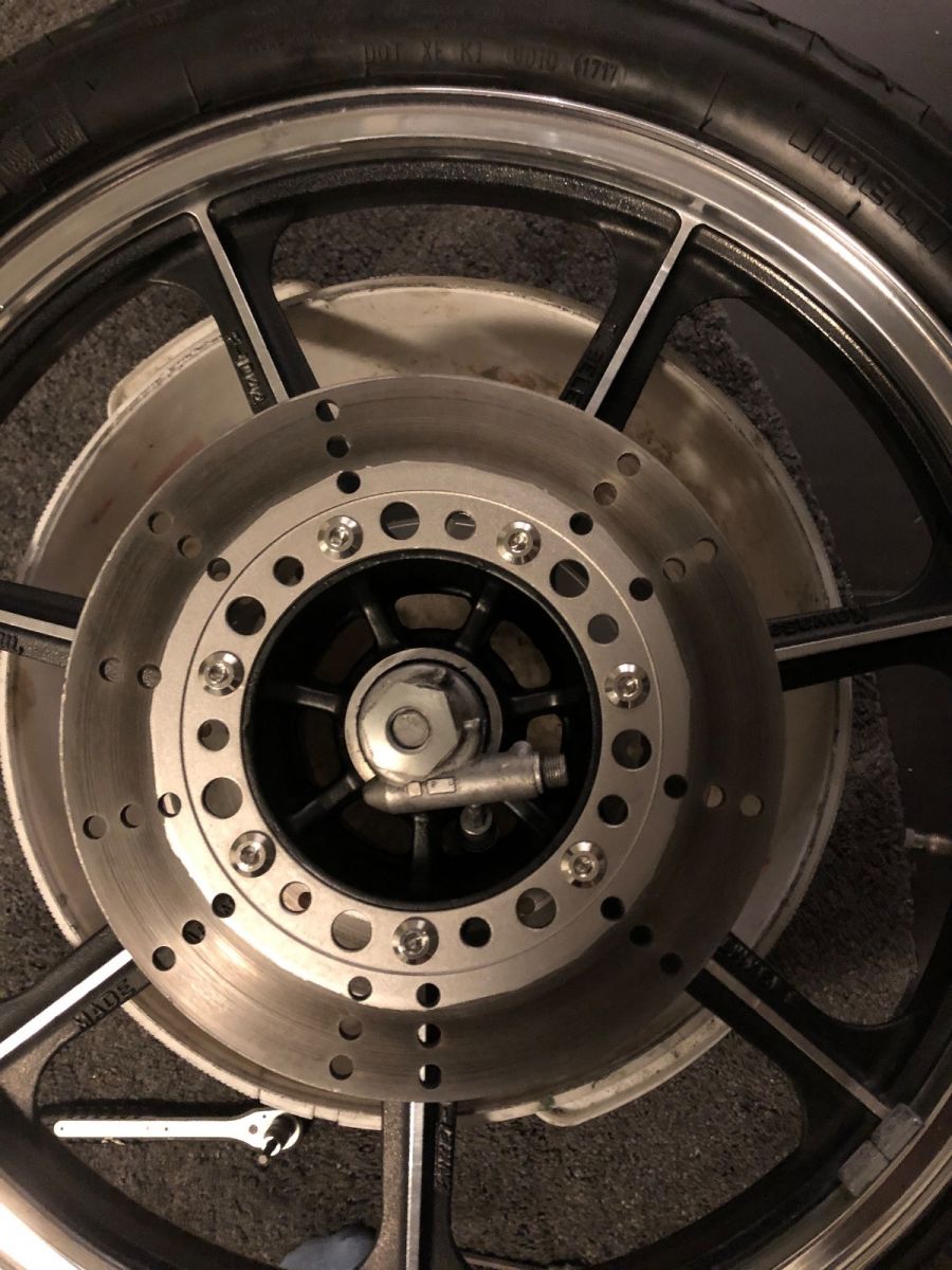

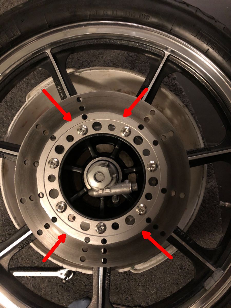

I have masked 95% of the area before paint, and lets the pads make a nice edge between braking area and not braking area.
I will double check by measure the pads, but I’m quite sure the shall not use the whole surface.

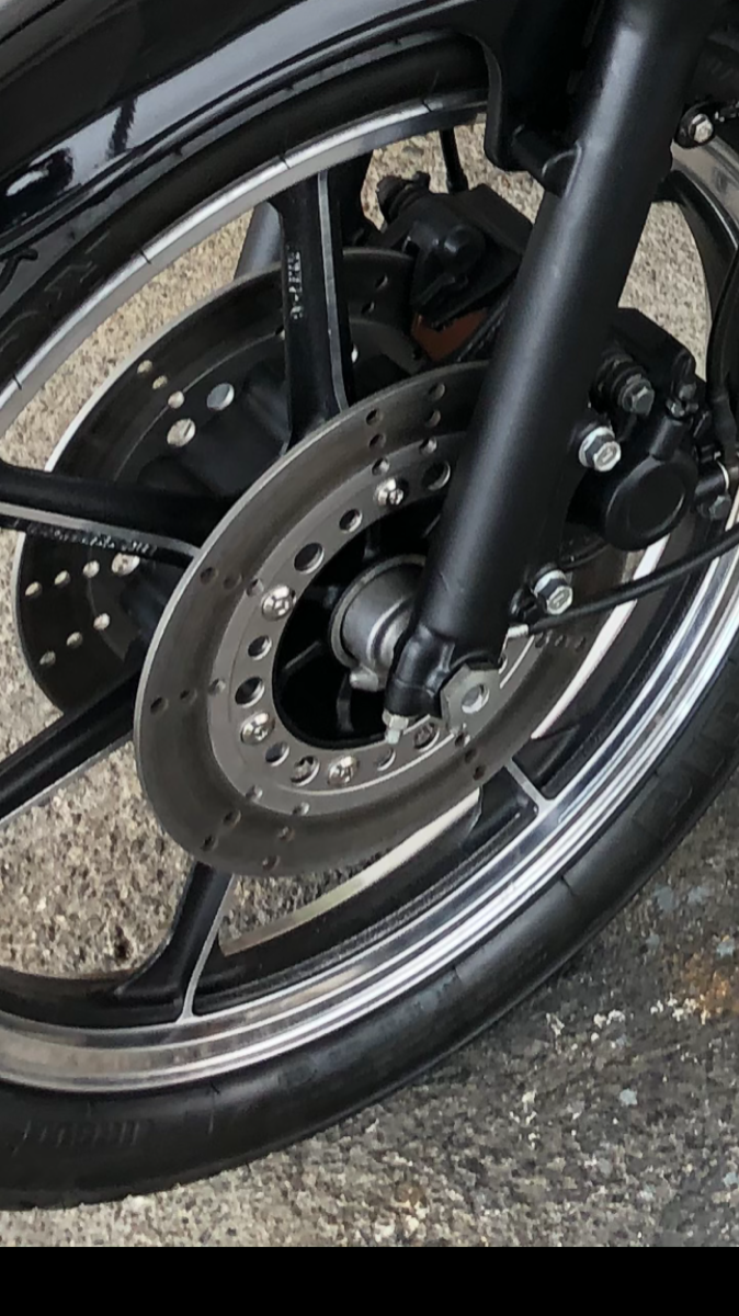

Rear wheel ready to be reinstalled.
I’m happy with the result, just let the pads do the rest.

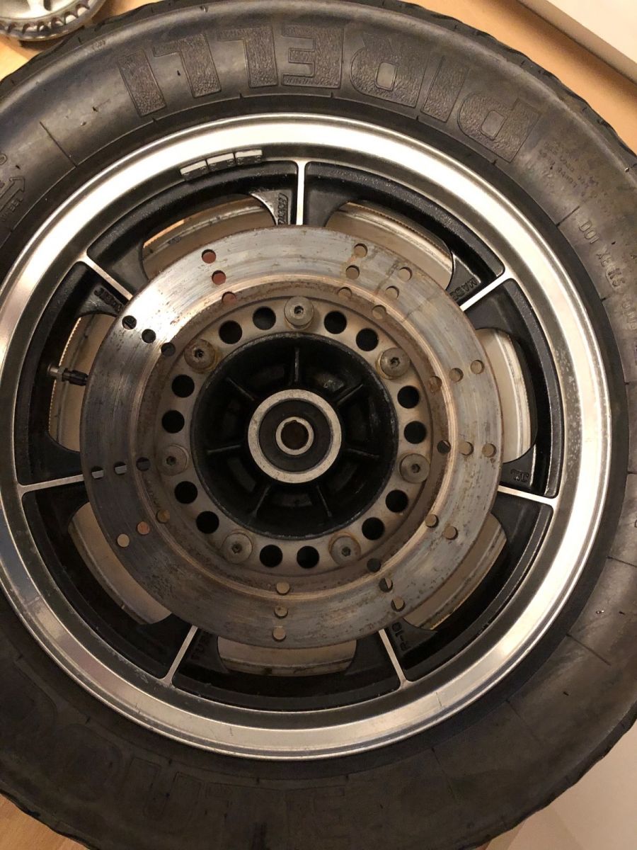

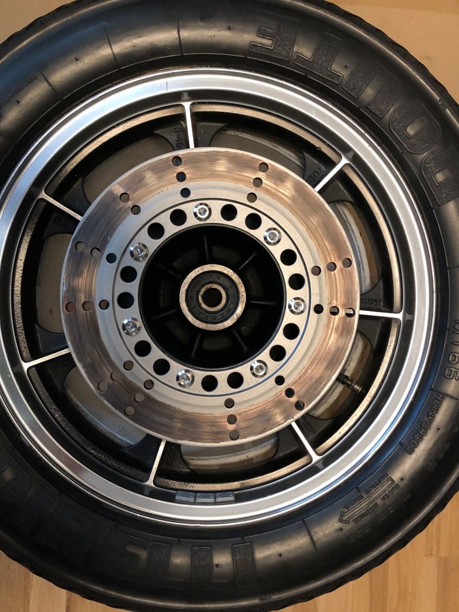

Before:
After:
Before:
After:
