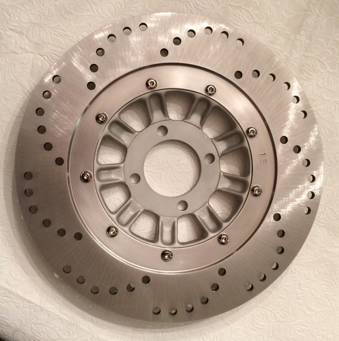

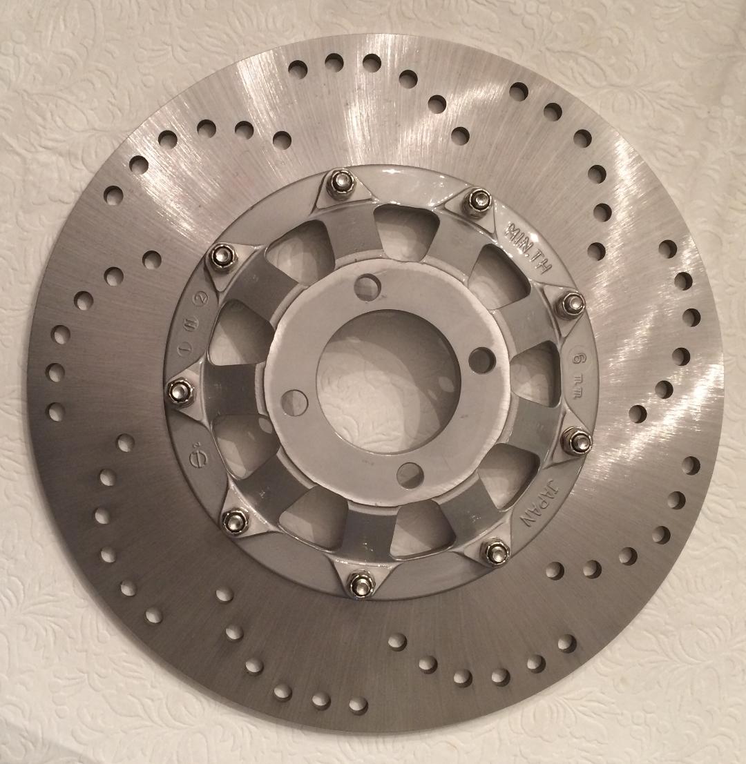

Here's a picture of new KZ650-C1 discs. Notice where they are painted and where they are not painted. Cleaning the unpainted portion should take less than 1 minute per year, so why paint that portion? Ed

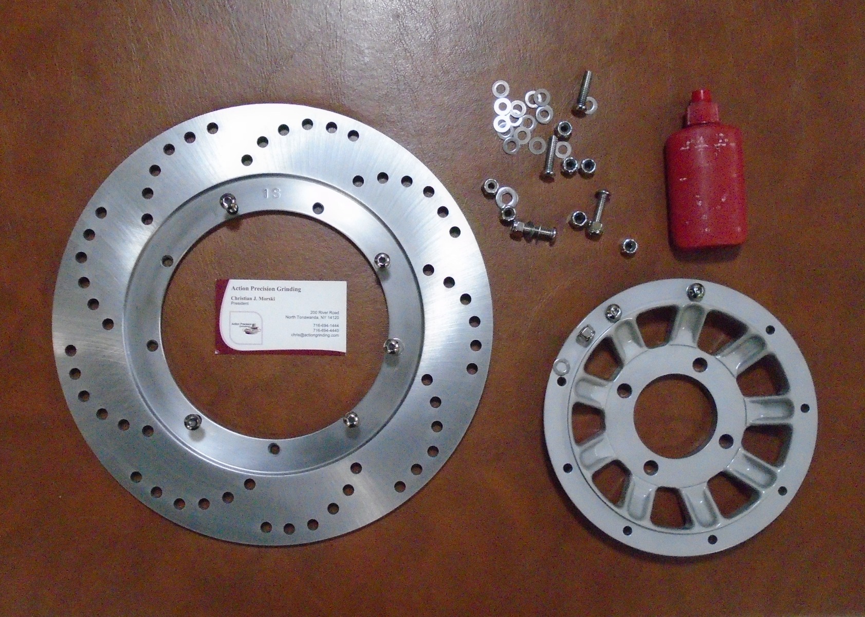

I just sold one I painted with automotive clear coat (2K).
You should separate the 2 parts, glass bead the aluminum carrier.
clean the disc. Keep it waxed, (not on pad surface) and it should not rust.
This is what I just did:
Unless your road racing on a course or stopping after a 150 mph 1/4 mile pass at the dragstrip.

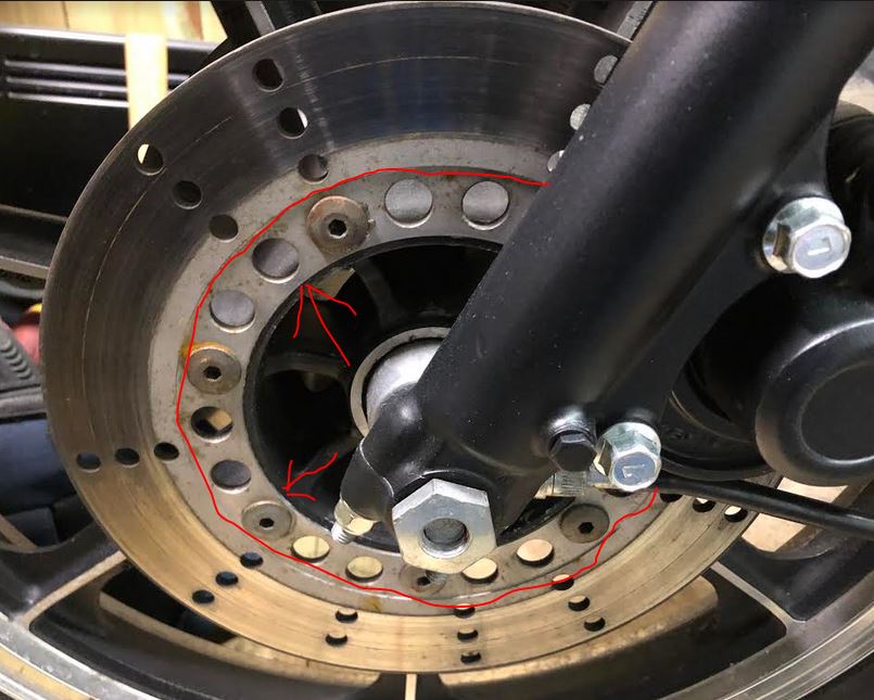

My orginal plan was to paint the area where the bolts is located, please see picture below.
But maybe I shall mask and paint everything that the brake is not touching.... maybe that looks niceer ?
hem...
I assume the brake pads will just wrap of paint if it has come some pain on the "zone" where the pads is working ?
Mask as good I can...
hem...
