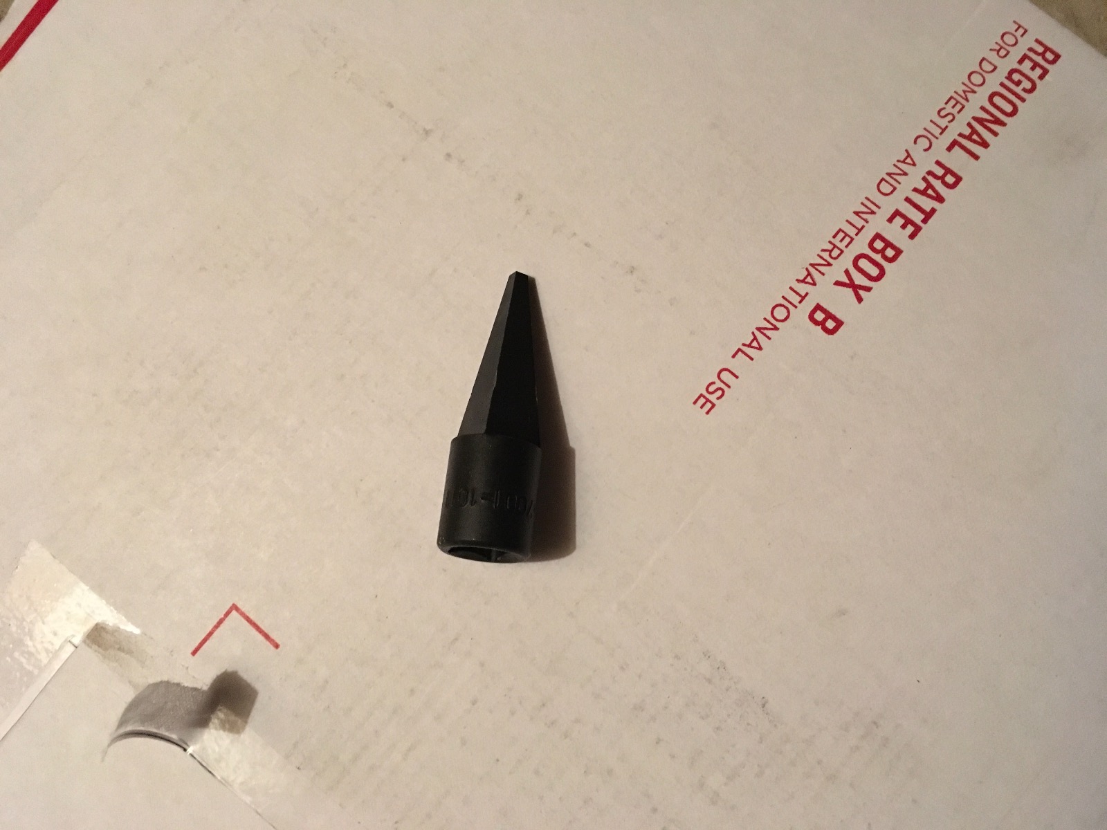

I have this tool but not correct for the 900’s
So that also rules out the broom handle trick...

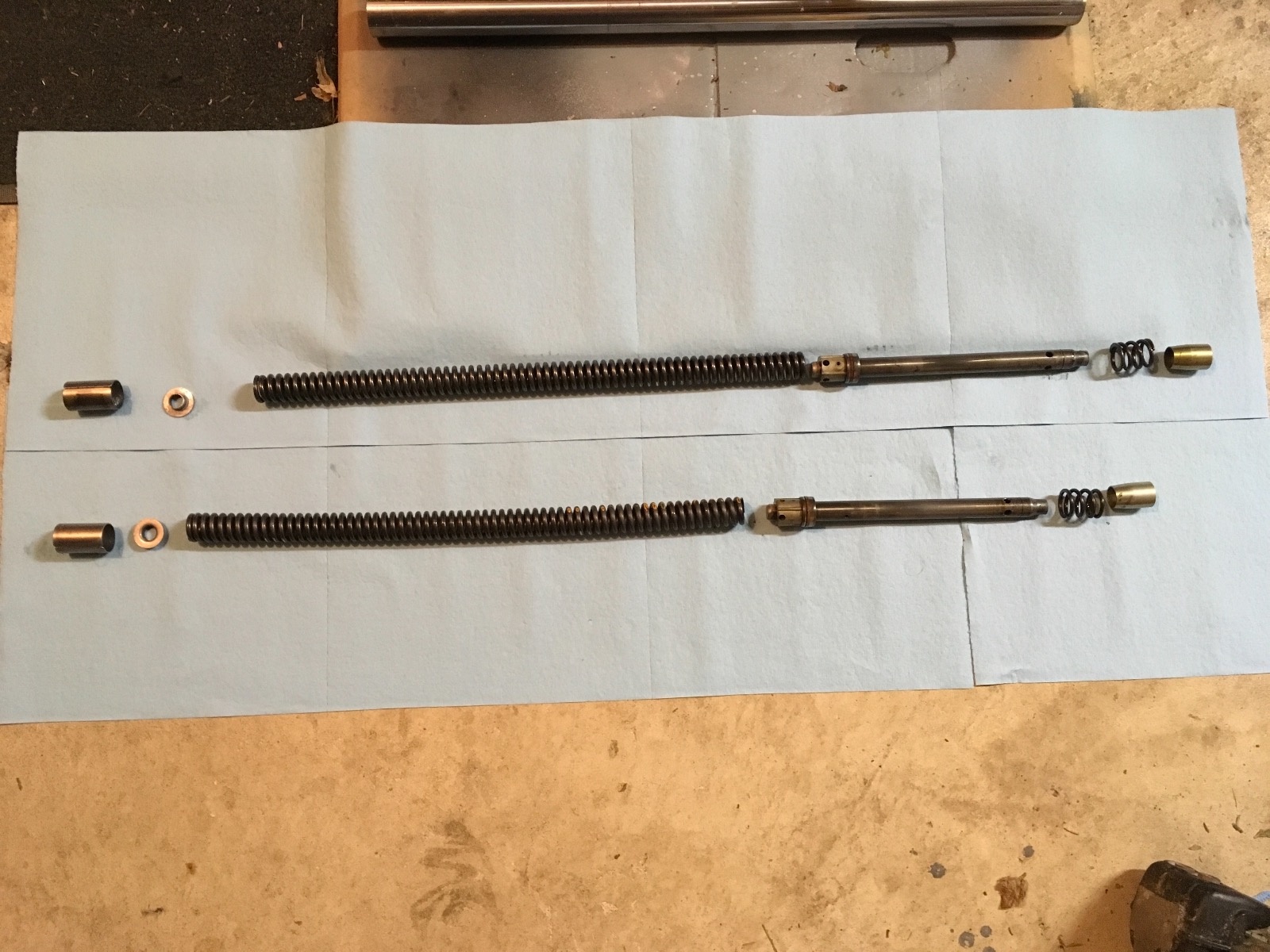

Ronkz650 got me thinking, electric impact...!!! Well S**t I have one of those. And it worked... They are apart... Now the hard part of getting the old seals out...
Re: 1976 KZ900 fork disassembly
27 Dec 2019 20:41

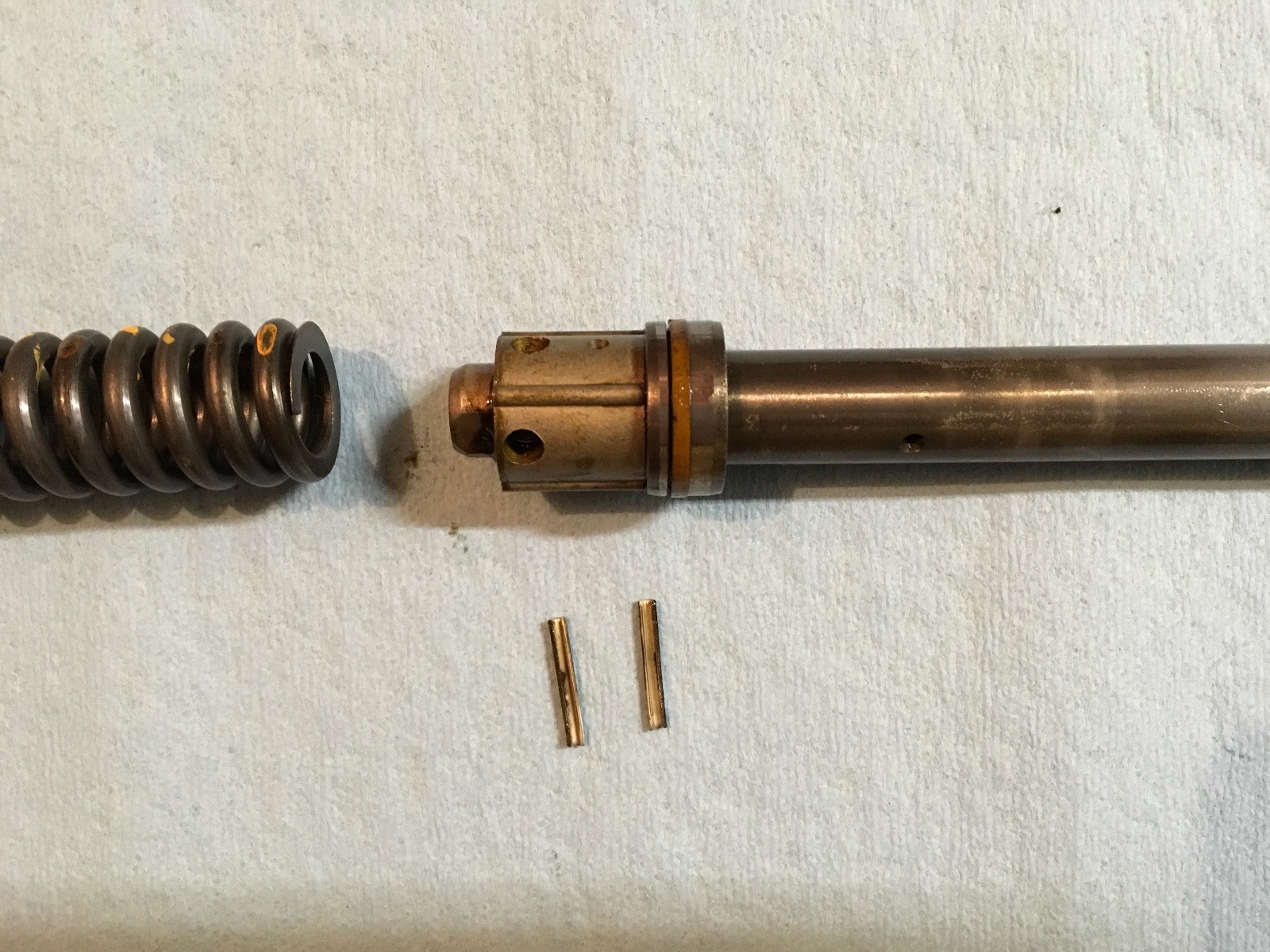

Here’s what came out. Doesn’t look like enough stuff compared with the FSM...
Broken roll pin that holds the top on the damper...
