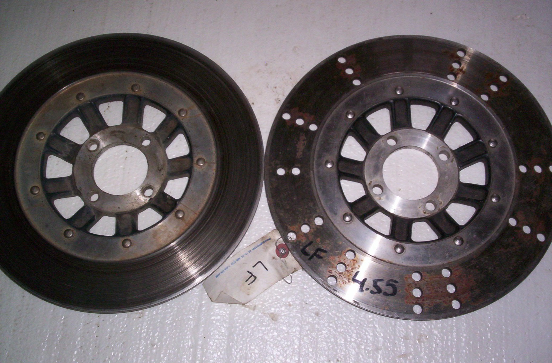

Just wondering? Did the Z1 dual disc set-up offered as original supplied equipment across the pond get the same thickness of each 6-bolt disc as the USA versions single disc?

I have asked on Z1OC forum for you. Reply was "there is no such thing as a 6 hole thin disc". Early Z1's until the A4 had 6 hole discs. A4 onwards had 4 Hole discs.
6 hole discs were only made in 7mm thickness and 4 hole in both 7mm and 5mm thickness.

Thank-You for the reply Warren! Too bad the USA got robbed of this feature and had to pay extra. I knew the 9999xxx Accessory RH disc upgrade got the thick(7mm) just wondering about other markets.

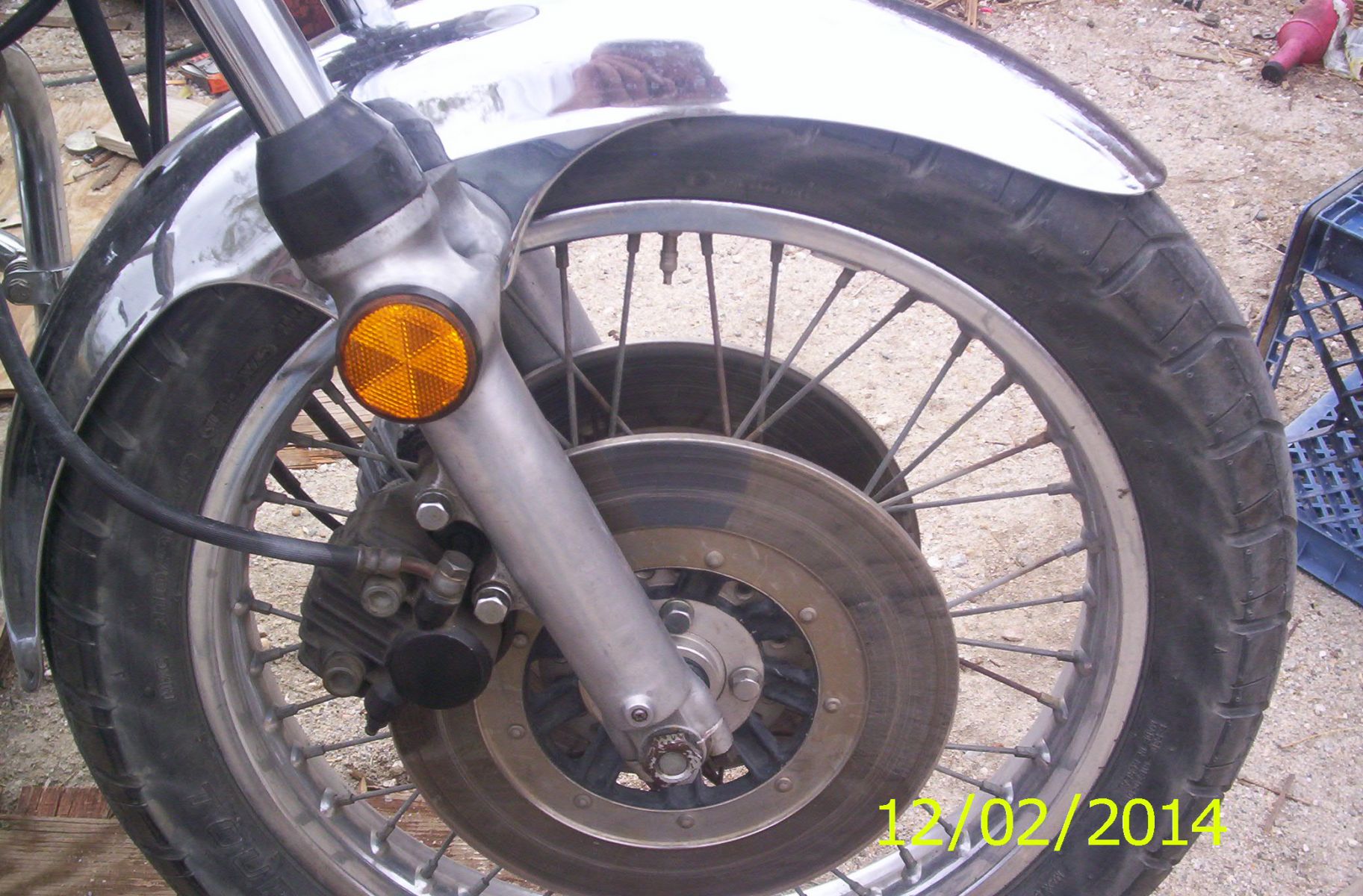

I switched to duel disks in 87. I was wrenching at a salvage yard restoring bikes that were worth it. Some were too far gone.
Combined the parts from H2's,GPZ 750 and two KZ 900's to do it. I already had a front wheel from a KZ 900 parts bike I had on hand. The disks were heavy but didn't cause any problems. Later I put in progressive springs and the whole setup worked great. In 15 I picked up two factory drilled disks from a later model Z 1000. One caliper is upside down but there's no issue bleeding it at the banjo. The one bracket has a cutout on the bottom and a washer cured that. I like the H2 calipers even though they're heavier than stock, I think they're sexy. :evil: Been planning on drilling and tapping the one and installing a bleeder but that's not a high priority.
