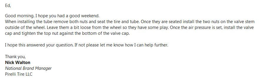

I recently replaced the worn Pirelli tires on my KZ650-C1 with new Pirelli tires. I thought (for once) that I would ask the folks at Pirelli about those two valve stem nuts in case I had been using them wrong for the past 54 years. Here's the reply from the expert at Pirelli. Fortunately, I had been doing it correctly over the years, but it was good to get an answer from an expert. Ed

I don't like Pirelli's answer >> they don't give a reason why & didn't mention what to do with the other nut.

29 Oct 2019 12:02 - 29 Oct 2019 12:03martin_csr wrote: I don't like Pirelli's answer >> they don't give a reason why & didn't mention what to do with the other nut.
I think they actually did address both nuts. One is still against the wheel and the other (top nut) is to be tightened against the cap. Ed

By 650ed: I think they actually did address both nuts. One is still against the wheel and the other (top nut) is to be tightened against the cap.
No, he didn't actually specify. And why tighten the nut against the cap?
