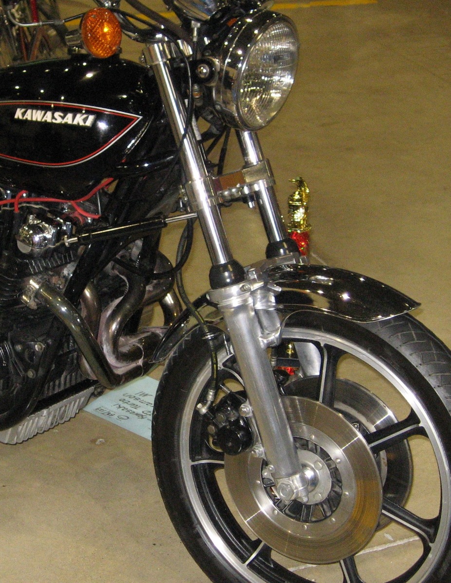

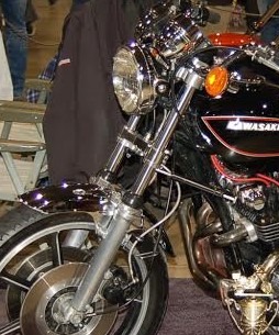

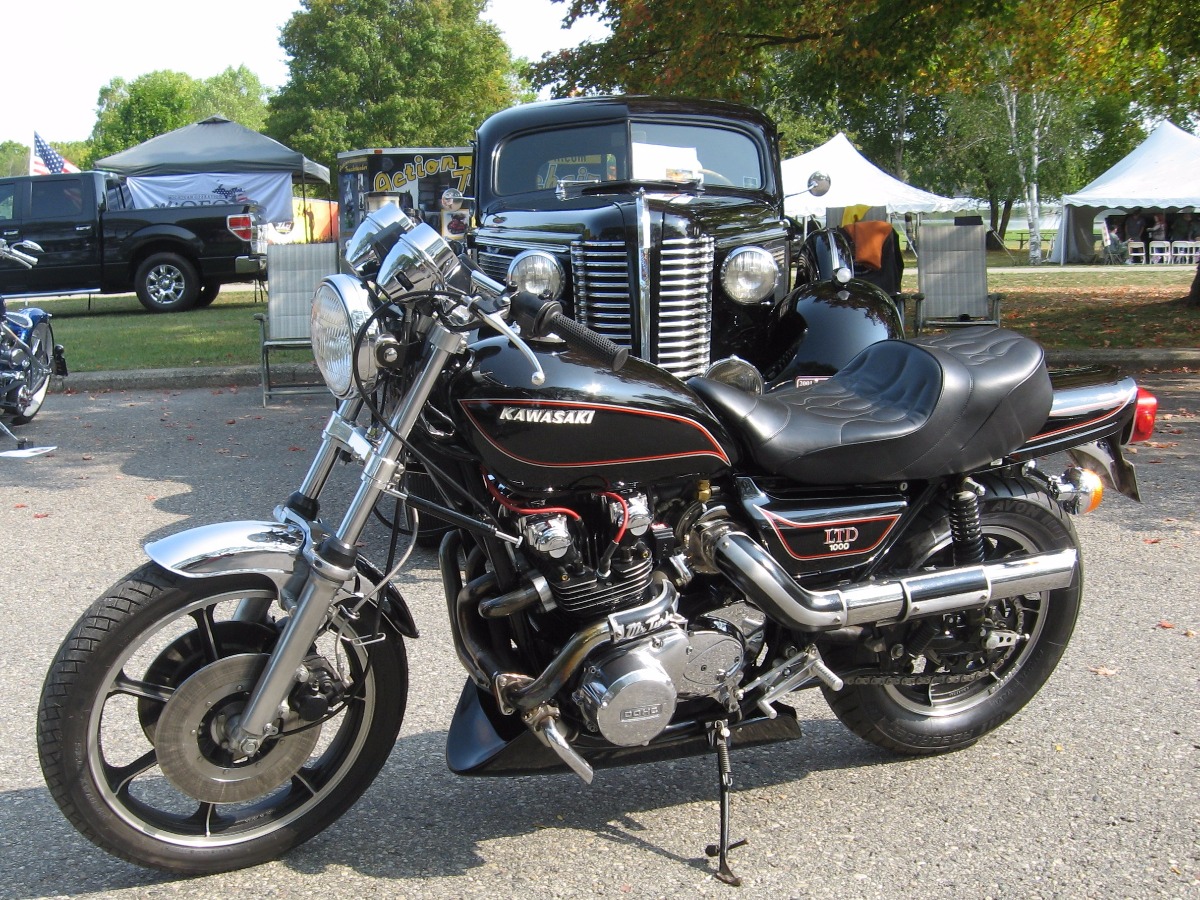

Here are pictures of my LTDs stiffened front forks.
You may think this is over kill , but at warp speeds my front end dont shake .
This is on a high boost turbo bike .
A custom PDM ( Les Holt ) triple tree with built in brake splitter,
Fork brace at fender
and dual steering dampners
Last edit: 01 Sep 2019 17:22 by Street Fighter LTD.

@ S-F LTD Very nice front end set-up and bike. It looks like from the pic that of your dual dampners that you utilized the upper frame reflector mounts ,(reflectors removed) , as a mount for the dampner, as I did also. Both of my reflector mounts eventually failed, cracked, and I had to remove the dampners. . Any solution to my missing mounts, or is welding the only option ?
- Posts: 5192
- Thanks: 2340
Re: Fork stabilizer
01 Sep 2019 17:42urankjj wrote: @ S-F LTD Very nice front end set-up and bike. It looks like from the pic that of your dual dampners that you utilized the upper frame reflector mounts ,(reflectors removed) , as a mount for the dampner, as I did also. Both of my reflector mounts eventually failed, cracked, and I had to remove the dampners. . Any solution to my missing mounts, or is welding the only option ?
Thank You
I welded in triangle shaped gusset's to make the reflector mounts plenty strong enough.
Never had a problem since done when frame was braced 35 or so years ago.
