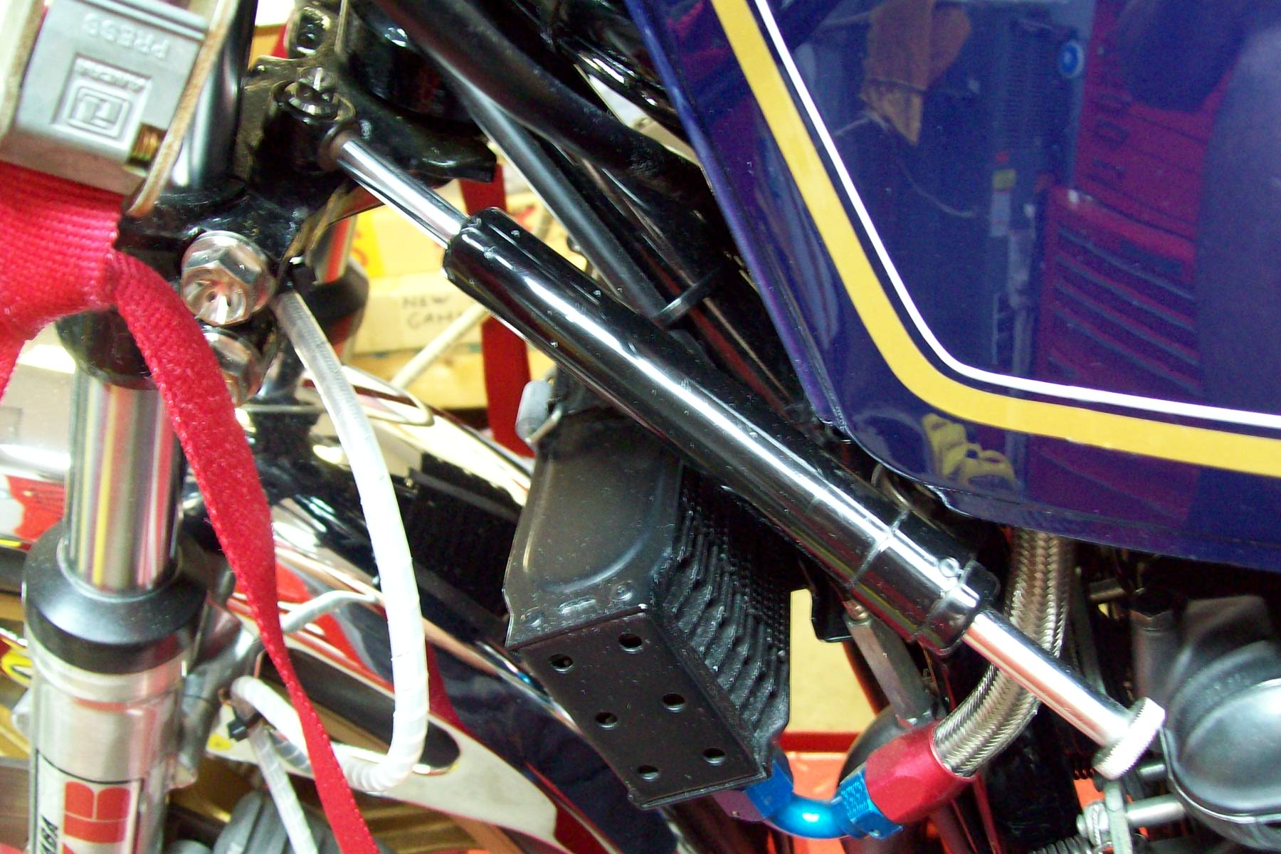

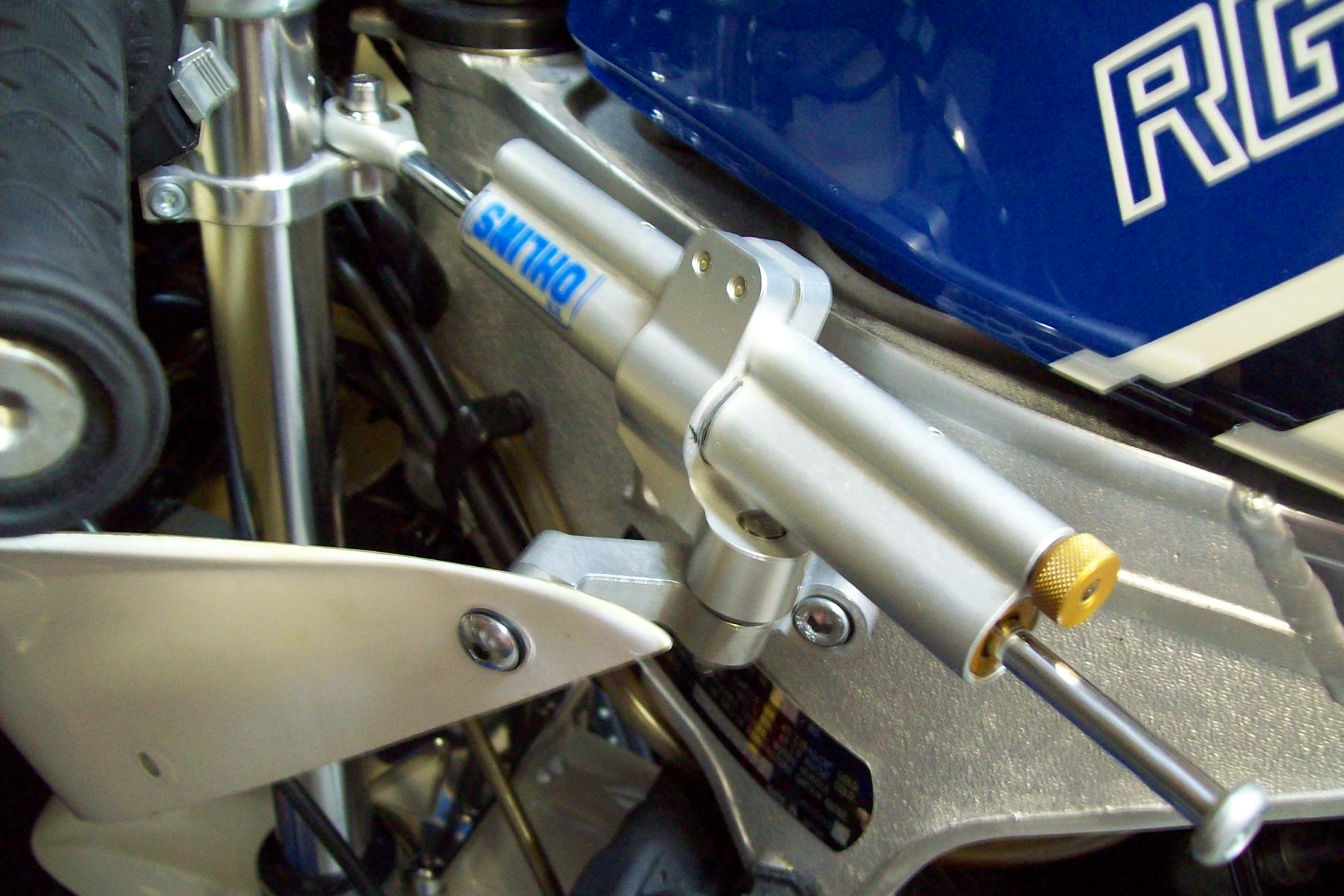

A fork stabilizer, do you mean a fork brace?? Never used a fork brace on any of the bikes I owned or built over the years. One thing that is a must have for me is a adjustable steering damper. I would not ride any motorcycle at high speeds without one!!!! End of question!!!
I don't think its much fun when your big inline four Japanese bike hits some rough pavement at 120MPH or so and goes into a massive fork shake or what some folks call a speed wobble!!! Been there Done that!!! I had a '79 MK. II demo from the dealership I worked at back then that went into a speed wobble at high speed. It was so bad that my knee broke off the spark plug cap on the #1 cylinder!!! I did manage to save it without crashing that day. That was the very last time I rode any bike without a steering damper. What I used to do after I put a bike together was go out on a nice piece of straightaway. Get up to near redline in top gear and purposely shake the bars back and forth. If I did everything right, the bars would stop going from side to side almost instantly. If not it was back to the shop and find out what I did wrong in setting up the bike!!!!

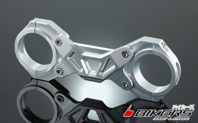

I know that back in the day that a set of steering dampeners-stabilizers were a must for high speed applications on almost all double down tube framed in-line fours. Especially in drag racing. Many riders also coupled them with a one-piece fork brace that joined the two fork tubes together, (as pic in your example) . Are they necessary or be an up-grade ? Motorcycles are like relationships, so anything that you can do to add stability is probably a good thing .:blink:

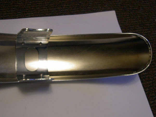

31 Aug 2019 08:09
Regarding fork braces one thing to consider is that many folks remove the stock front fender without realizing that i provides at least some fork brace function to the forks. This is because along with the fender itself there is a rather stiff metal support riveted to the fender that during normal riding keeps the distance between the two fork tubes constant. A stout fork brace will provide a stiffer support and may be worthwhile for use on the racetrack, but I doubt there are many, if any, situations in normal street use where distance between the two fork tubes will vary with the stock fender in place. At least I can say I haven't found it to be a problem on my KZ650-C1 for more than 42 years, 62,000+ miles, of riding, some of which were quite spirited. Ed
