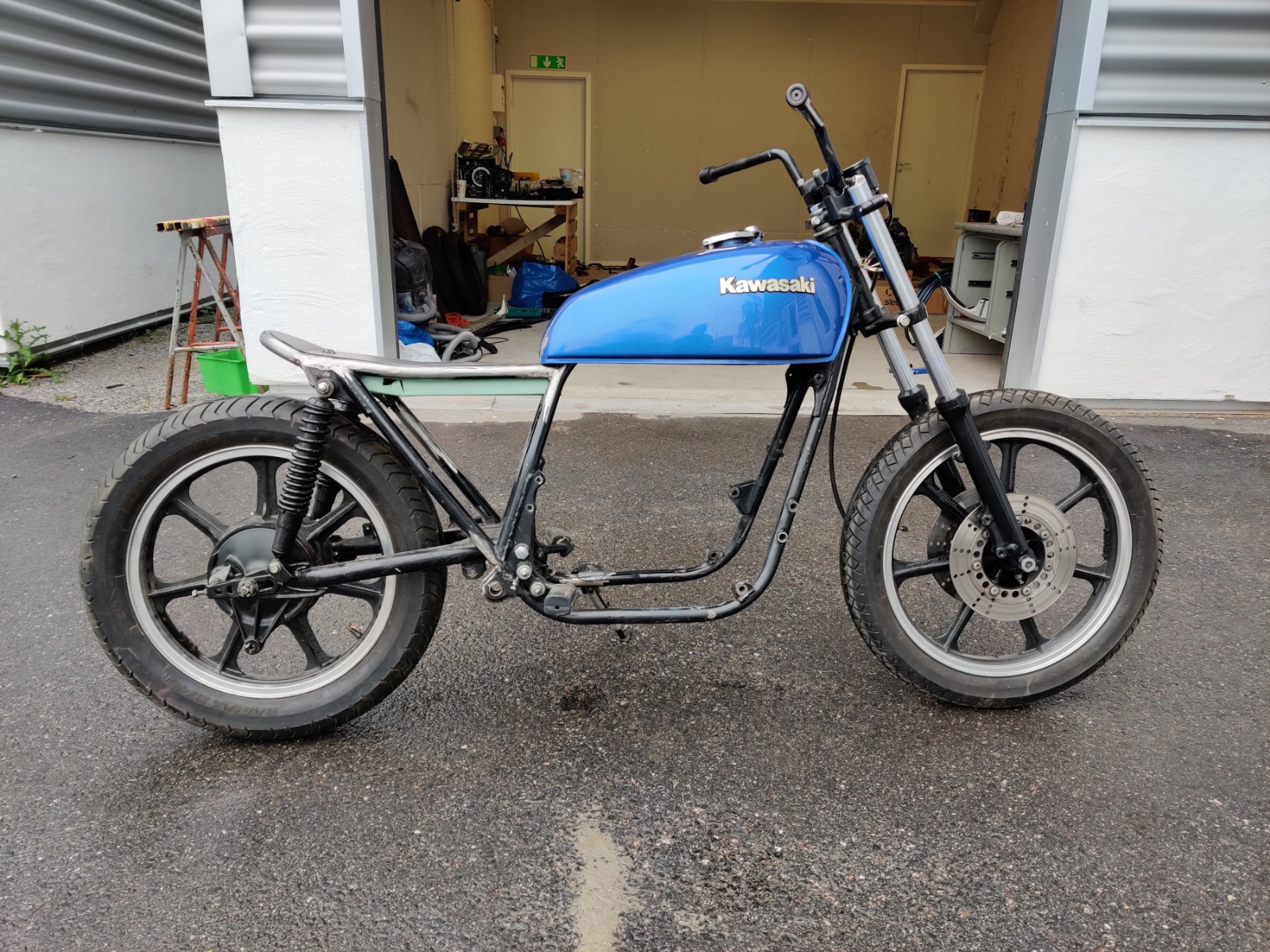

I'm in the process of modifying a Z650 F2 -81. I'm from Sweden and here it's called Z650 not KZ650 this makes googling parts compatibility etc a hassle!
Right now i'm looking at options to swap my 19" dual disk cast alloy wheel for a 18" to be able to run matching tires front and rear.
This is how the bike stands today.
This is the the wheel I would like to fit on there
From searching the forum I get that the Z1R alloy wheel fit but if this police version fit is unclear.
So any help before I order this wheel from the UK to Sweden would be nice.
Regards - Marcus

We never got the 650F1 in the US so its harder to find info. This topic has been discussed before on here but i don't recall seeing if it was a straight bolt on swap. Your disks will fit on that bolt pattern, and the axles are the same diameter which are the critical areas. I would guess that its probably a direct swap. you may need to get some wheel spacers made. which is relatively inexpensive.

So I got the wheel today and noticed some big differences in the width of the center of the rim.
My original wheel is 105 mm between the discs and the Z1000P is 130 mm.
So I will have to get a new front end or if I'm lucky new top and bottom yokes that is wider than the Z650.
I have measured my stock front and the legs seems to be 40 mm in diameter and 185 mm between them.
If I'm right this would mean I need a yoke with 210 mm center to center? Does anyone know if this exist? Or if there is a list with specs of the different models?

My logic say a Z1000P front wheel needs a Z1000P top and bottom yokes or front end.

This sunday's vacuuming of the internet seems to tell me that the Z1000P have 41mm fork legs so the yokes won't be enough I will need the complete front end. And then I haven't found anything on the caliper fitment yet..

That’s a bummer. Always a risk when you’re blazing trails like this. I have quite a few parts on the shelf I bought to see if they would fit and it didn’t work out. I would opt for getting a complete kz1000p front end at this point. Not the cheapest alternative but probably the easiest. I would cross reference the steering bearings between the two models before going deeper.
