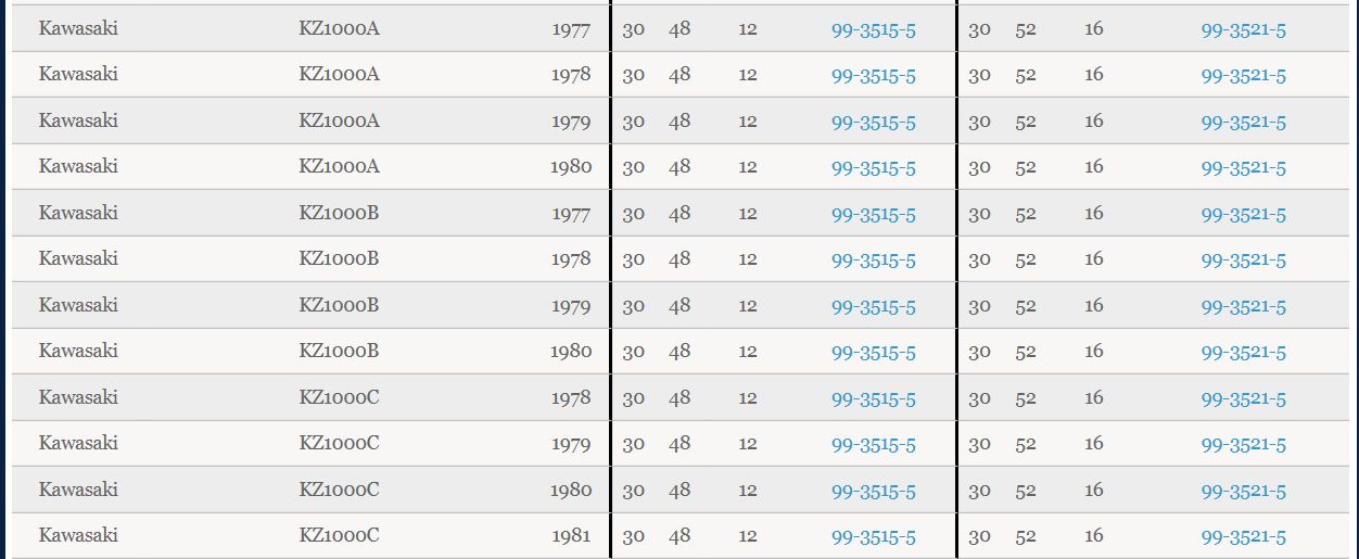

All balls can create a fork conversion chart for your 1977 KZ 1000 steering head bearing.
All listed forks will fit with the top and bottom bearings listed.
The stock steering stem cap ID maybe need to be modify if the new stearing stem OD is bigger.
Some fork conversion need a steering stem swap too.
www.allballsracing.com/forkconversion

I don't think he wants to change forks, just convert from ball bearings to roller bearings in the stock setup.
The output of the chart will listed roller bearings for your stock 1977 KZ 1000 steering head bearings too.
www.allballsracing.com/99-3515-5.html
www.allballsracing.com/99-3521-5.html
