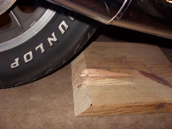

My 1976 KZ900-B1 LTD came stock without a centerstand. My earlier owned 1973 Z1 and 1976 KZ900 street model each came stock with a centerstand which functioned rather easily as intended and wasn't at all difficult to use. For servicing the 1976 KZ900 LTD, I fitted a 1976 KZ900 street model centerstand, but found the LTD to be extremely difficult to lift onto the centerstand.
Rolling the rear wheel up onto a wood block makes putting bike on centerstand a piece of cake, even for a ninety pound weakling. Almost fun! :laugh:
Once on the centerstand, it's easy to push the block out from underneath the tire.
The block pictured here is made from a short length of 2x12, and with a hi-tech tapered edge.
Good Luck!
Good Luck!
