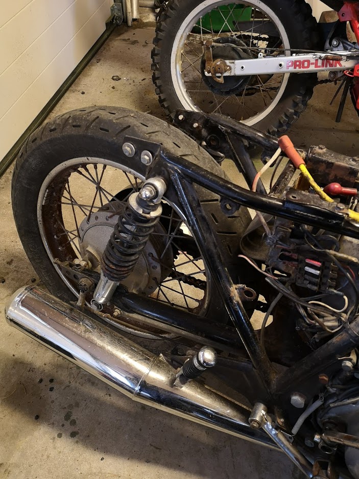

Hey, just bought a 77 z650 project bike.
Do the frame looks right here. whats missing ?

Someone cut that frame; it did not leave the Kawasaki factory in that condition. Notice that there is no frame cross member anywhere near the top of the shocks - bad idea since that means the top of the shocks can move left and right. Ed

Hmm, need to find the welder, and find out what to do with this bike.

In addition to the frame cross-bracing repair, you should also replace the rear brake shoes if their age is unknown. The adhesive that binds the linings to the shoes can fail over time, so a lining can break loose then get jammed between the shoe & drum, locking the rear wheel. It happened to me, so it does happen. Mine looked very good, so you can't tell by looking at them.
