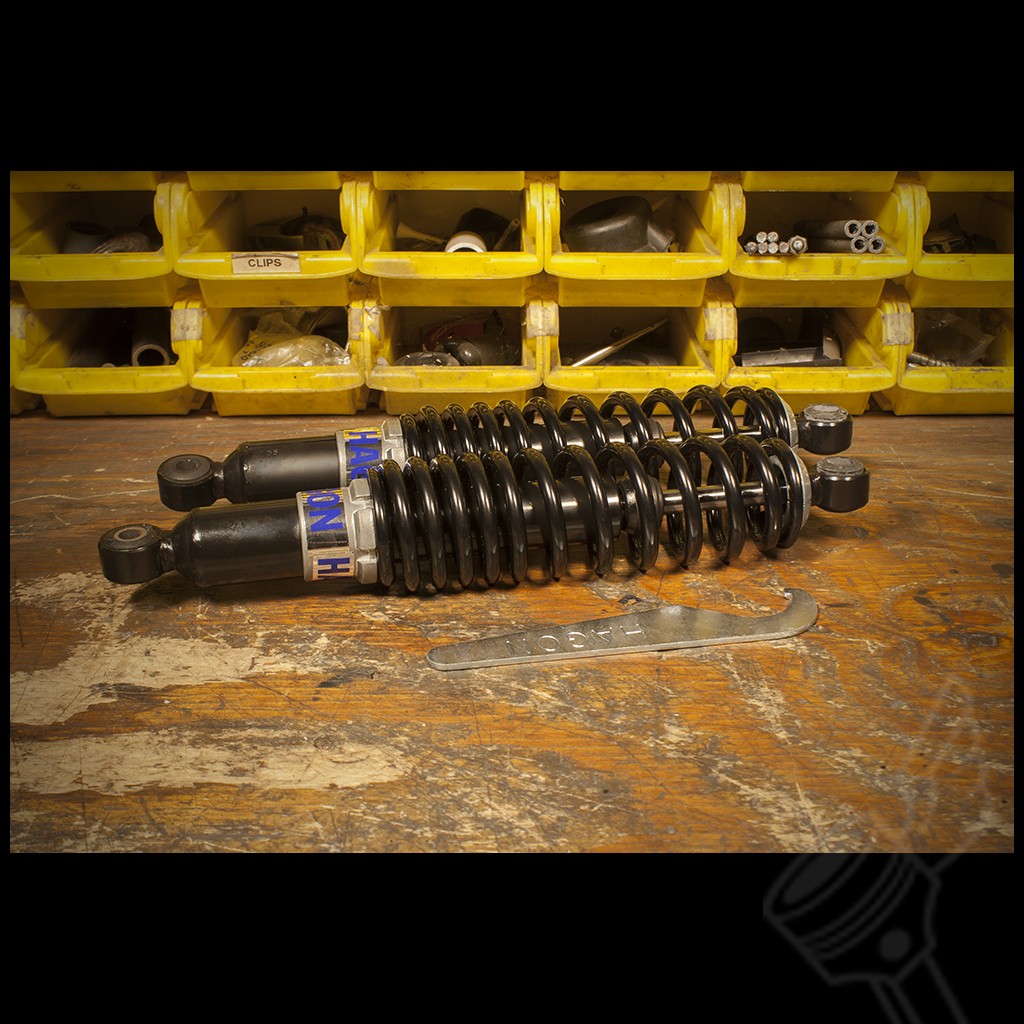

If your son's KZ650 still has the original rear shocks they probably are contributing to the ride problems. The original shocks on my KZ650 were shot before I had put 10,000 miles on it ( about 2 years). I then installed S&W shocks and they were great. Since 2007 I've been using Hagon shocks (see image below). They look similar to stock but work FAR better; they still work and look like new after about 20,000 miles. I really like them a lot! Ed

Think his boy has RFI shocks which are known to have stiff springs.
Road riders have a supple casing.

We have bought another KZ an will be doing a mild cafe to it. I dont want to change my bike as its mostly original. so we now have another to play with. I will be purchasing these shocks as they match our color scheme idea
