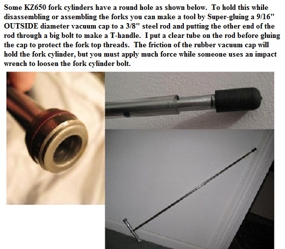

You will need to see whether your bike's fork cylinders have a hex depression or a round hole in their top end. If they have a round hole like the ones on my 1977 KZ650-C1 you may want to make a tool like the one I made (below). Another option if the fork cylinders have round holes is the "Damping Rod Holding Tool" at
www.racetech.com/page/id/70
