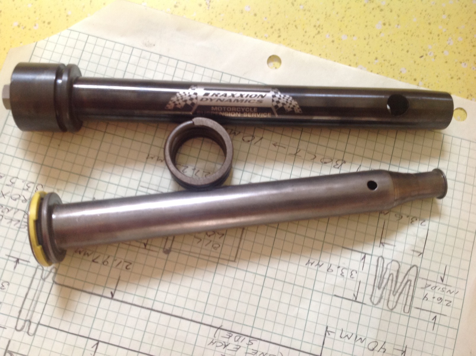

Here's a couple of pics comparing the stock with TD.
Note the 5mm holes for compression damping in the factory damper rod. There's two, one on each side.
Note the real compression shim stack in the TD unit. This was set up by TD.
