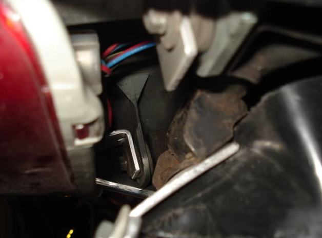

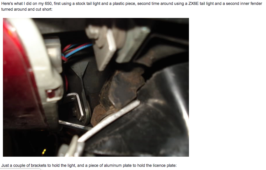

I think I found the solution. Poster RSTNICK posted back in 2010 his way of attaching the light (the same ZX6E I have) to his KZ650. Looks SUPER easy. just 2 "L" brackets!!

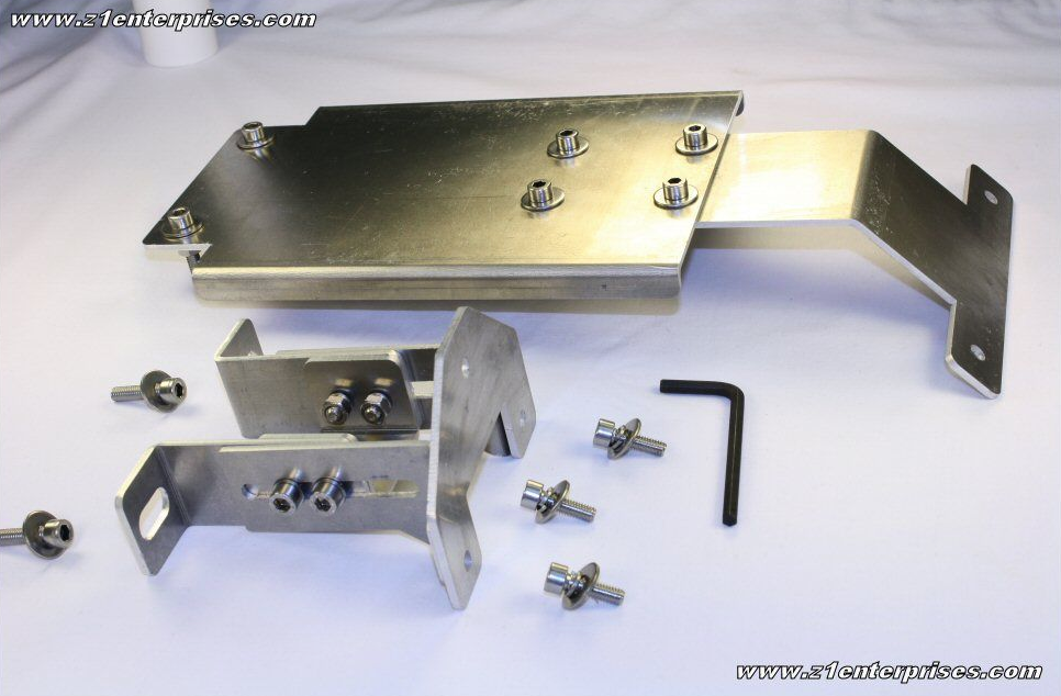

The fender eliminator kit from Z1E fits the 650. I fitted one years ago. I also painted it satin black. I didn't use the light mount plate as it was too big for the small LED cat's-eye tail light.

Did you drill a hole through that crossbar to mount the tail light bracket? I mean right here:

13 Jan 2019 20:07 - 13 Jan 2019 20:15stone fruit wrote: The fender eliminator kit from Z1E fits the 650. I fitted one years ago. I also painted it satin black. I didn't use the light mount plate as it was too big for the small LED cat's-eye tail light.
I just had a look at this again. Im not going to get the Z1E. You must have done some modifications. Theres a part that slopes down that is not present in your photo like it is here. Ive added a photo of someone else's DIY. You can see the part that bolt to the frame nearest to the light dips down at a slight angle. The Z1 kit wouldnt accommodate that angle. Yours is straight so you must have bent it. i dont want to alter anything on the frame at all. So no Z1E for me..

Yes mine has been modified to fit. The fender bracket was changed by a previous owner for a fender relocation, so it wasn't original and I just worked with it the way it is.

14 Jan 2019 15:36stone fruit wrote: Yes mine has been modified to fit. The fender bracket was changed by a previous owner for a fender relocation, so it wasn't original and I just worked with it the way it is.
yep. Z1E emailed today and told me it will not fit. So glad I didnt buy it! It will be easier to make my own at this point.

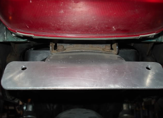

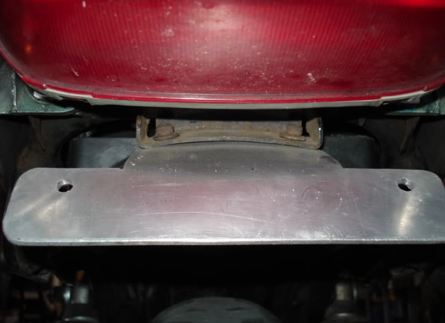

- rstnick
- Posts: 4691
- Thanks: 577
Re: Can anyone recommend an AFTERMARKET tail light? *PICS*
14 Jan 2019 17:31 - 14 Jan 2019 17:32
You have my pictures above for mounting the ZX6E tail light with brackets.

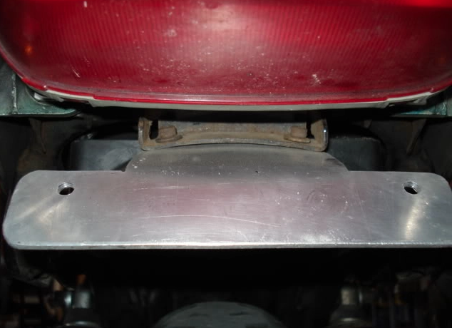

Second time around I did it like this, used a metal parking sign:

- rstnick
- Posts: 4691
- Thanks: 577
14 Jan 2019 17:34 - 14 Jan 2019 17:37
Used a second plastic inner fender, cut it short, and put it behind the stock front inner plastic fender.
Licence plate bracket attached:
Second set of holes in the bracket raises the tail an inch to close the gap between the tail and "that hump seat":
