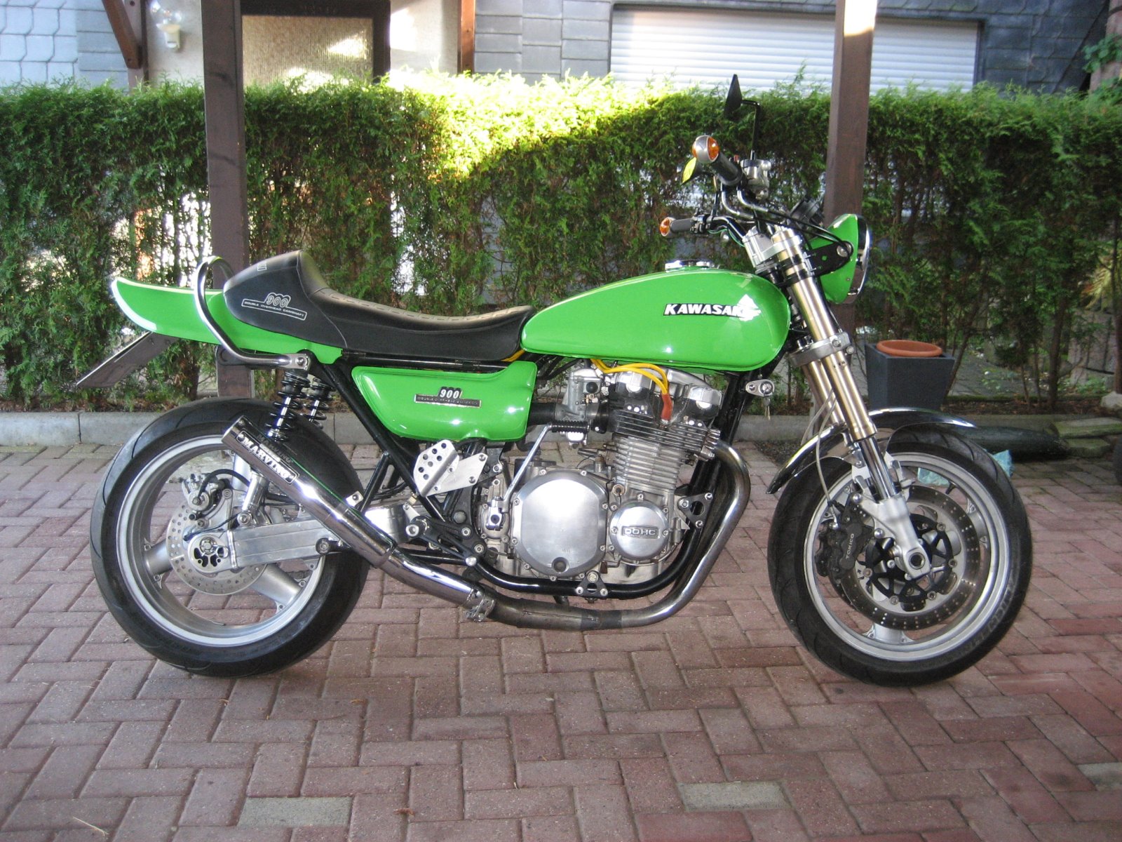

I use the same ZX9R fork, exept for the 6 Piston front brake caliper mount spacing, on my Project bike.
Never had any problems with the ground to header (Marving) when cornering hard.
