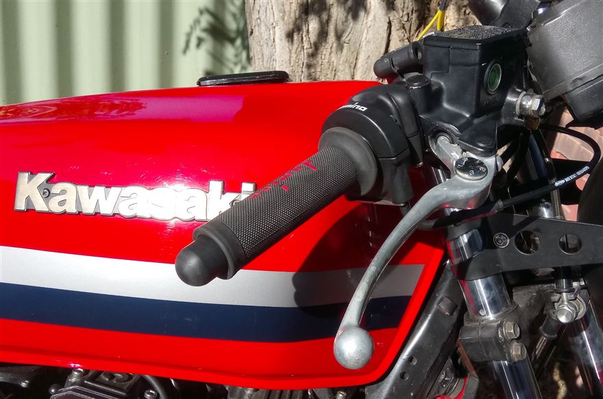

1995-1997 ZX6R integrated reservoir
also used on the 1995-2002 ZX6 and others
1998-up ZX6R remote reservoir
used on other models as well
Somewhere around 2005 they stated using radial master cylinders
The integrated reservoir looks similar to the early stuff but is a lot more compact with adjustable levers. This type is designed for handle bars that angle downwards like clip-ons to keep the reservoir level, . this is what i am using on my bike at the moment

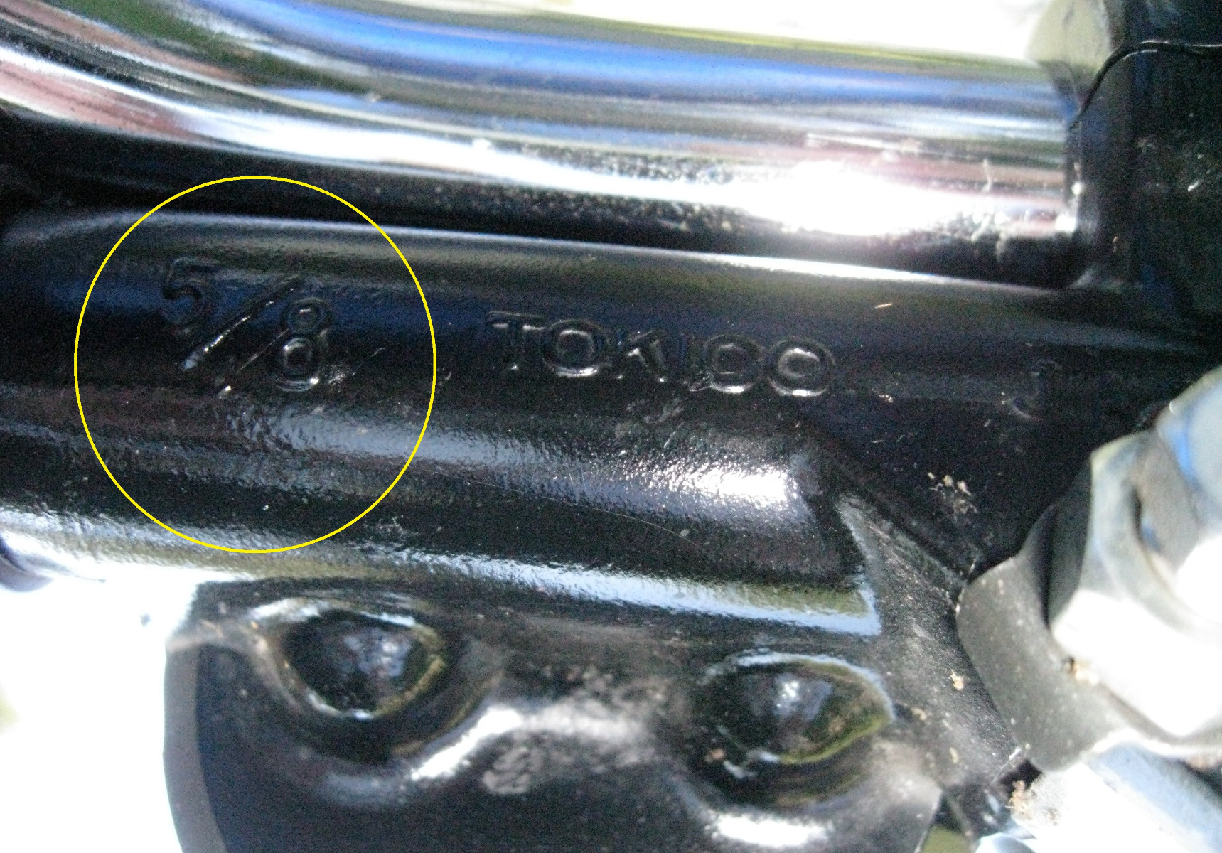

24 Dec 2018 06:02zed1015 wrote: ................Most dual disc use 5/8ths and singles use 3/8ths or 1/2 in so as long as you use an MC from a dual disc bike for your dual disc set up you shouldn't go far wrong.
Exactly. Here's an image showing the bottom of the stock KZ650-C1 (dual rotor) master cylinder. Ed

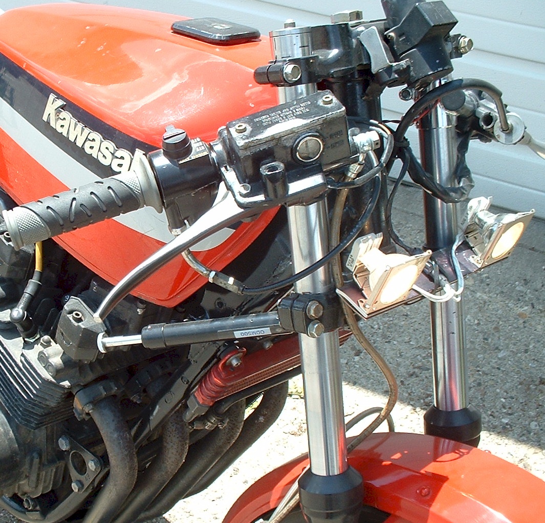

I've got an EX650 master on my 750 and it's 5/8". Not sure of the year.

I should mention, just for reference, the 1981 Gpz550 front master looks like the other early Kz550 masters, but has a different bore. The output port is axial with the bore and is extended way out. This often leads to interference with gauges when using lower bars or clip ons, that is, if you have gauges, ha.
You can see it clearly since the fairing is gone on this otherwise factory-fresh bone-stock example.
The 1982 and later Gpz550's had the output port facing forward.
