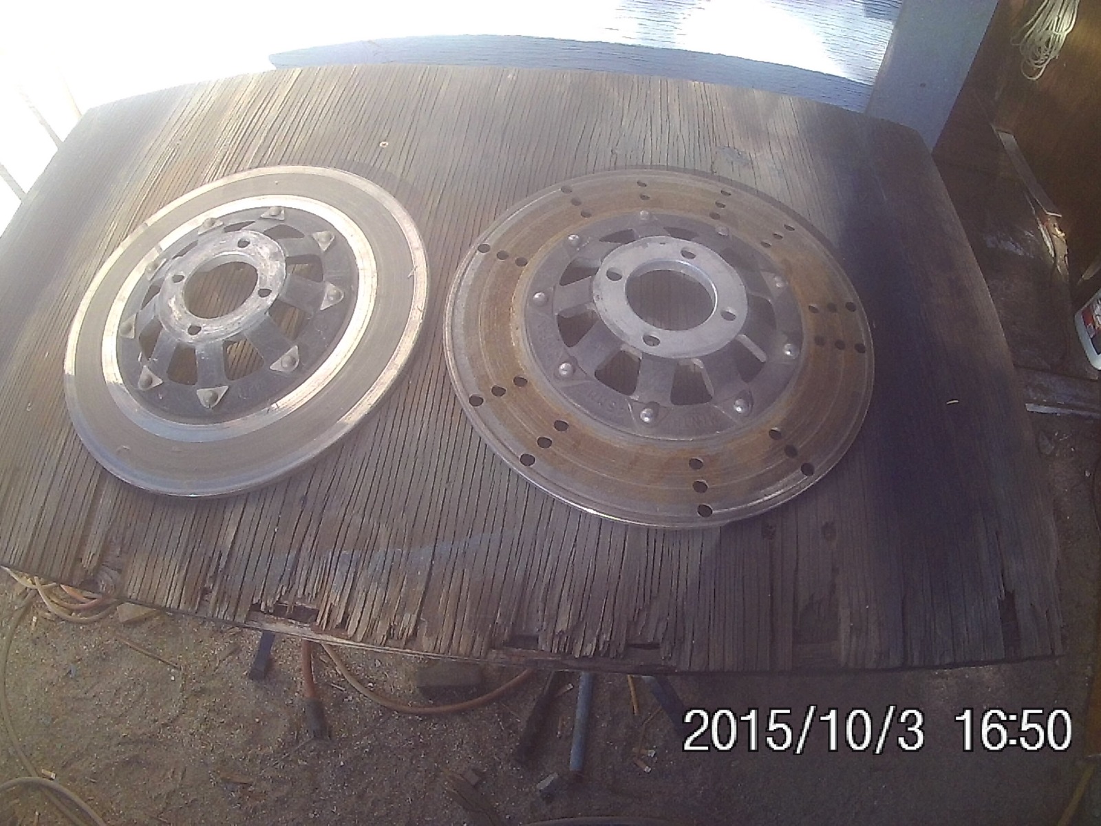

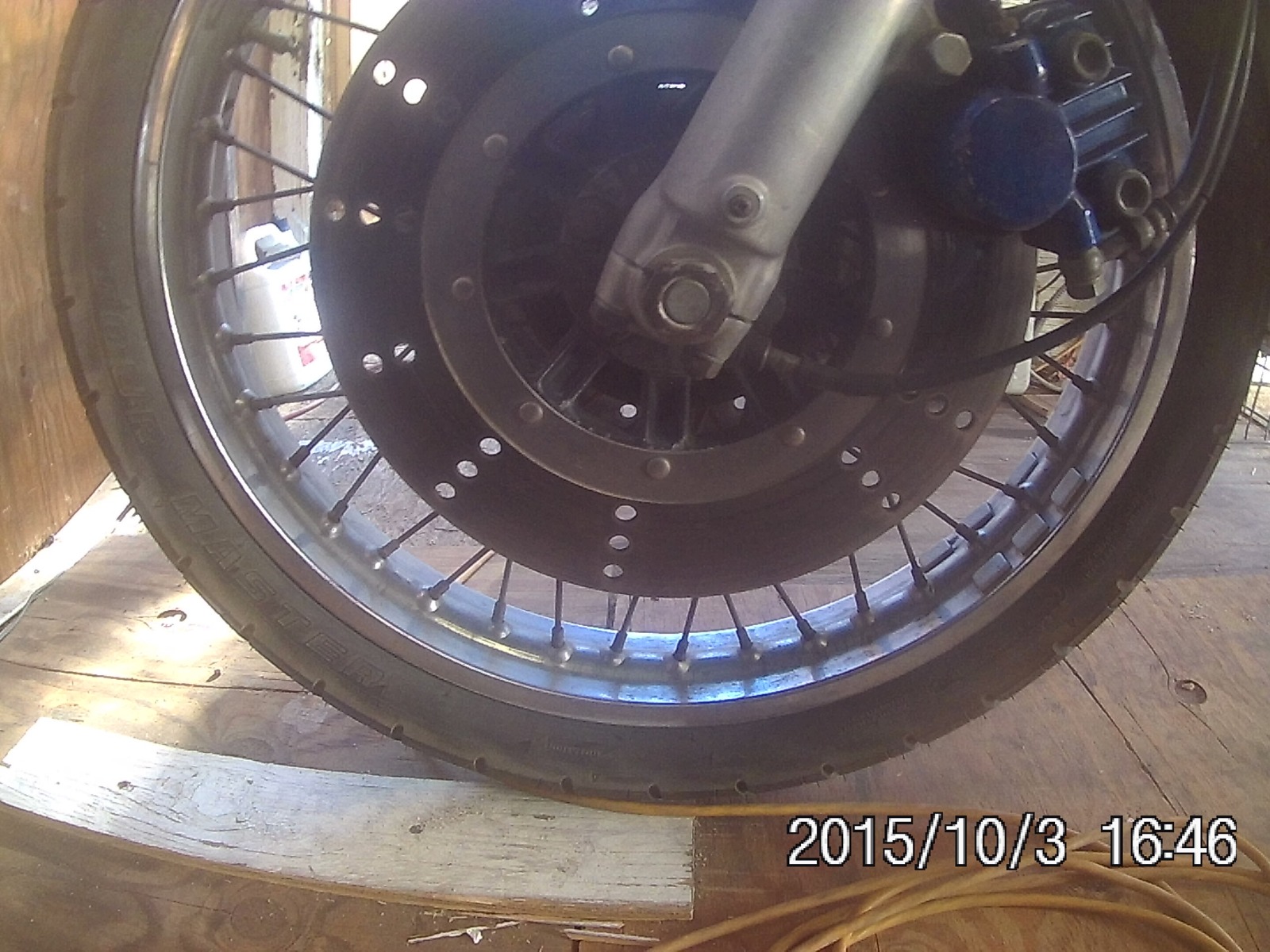

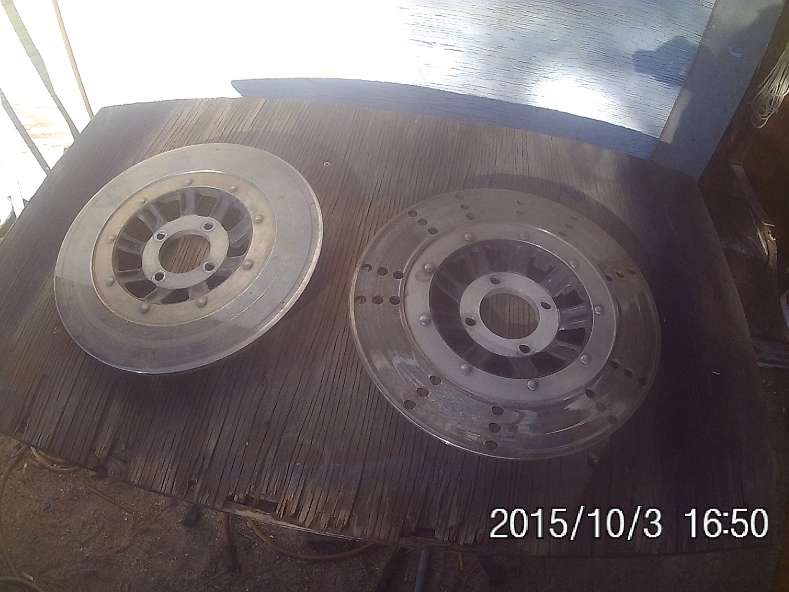

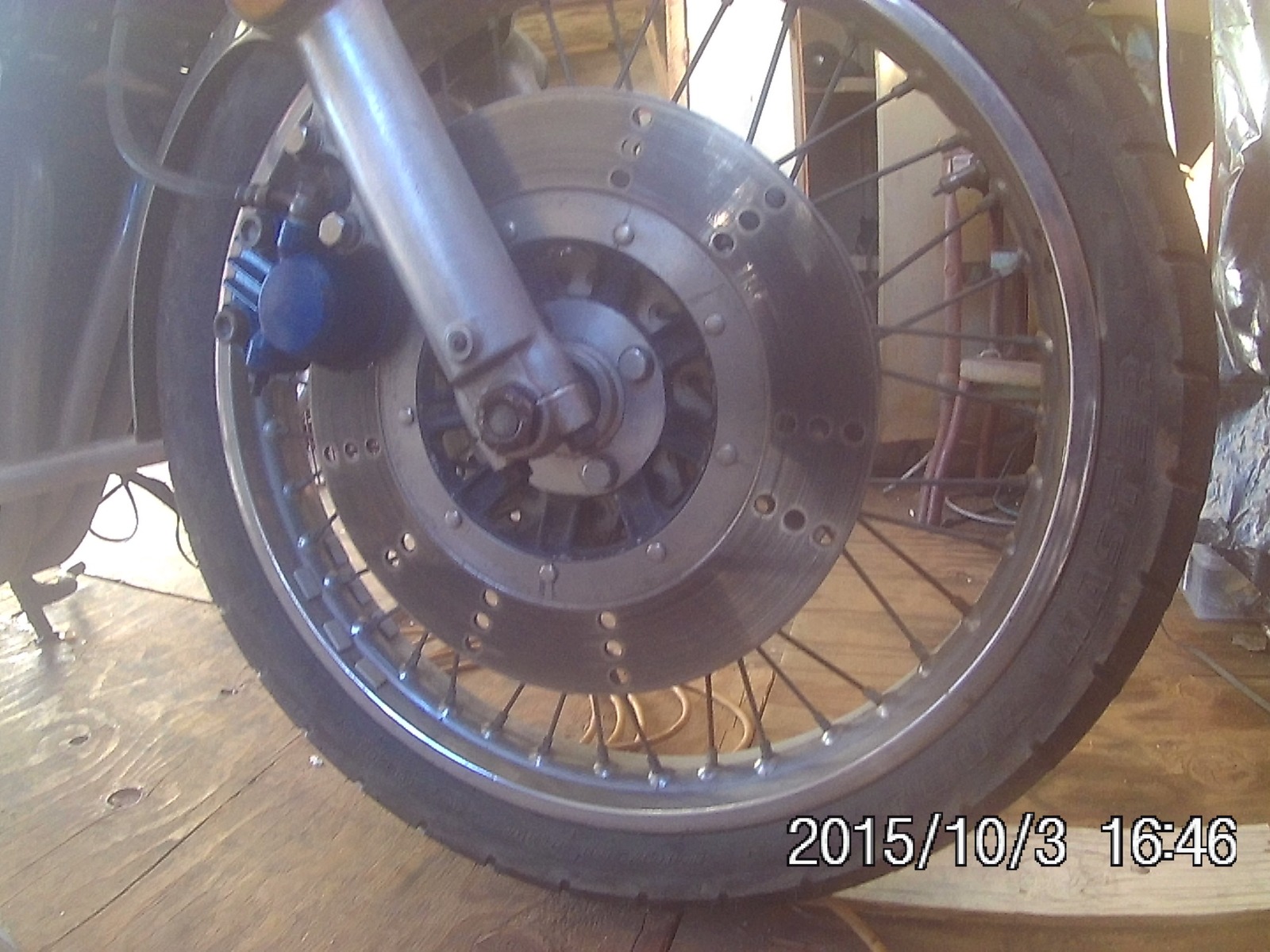

No eBay APP ID and/or Cert ID defined in Kunena configurationI've always used organic brake pads until I put on late model rotors. They are drilled and I got a notchy feel when I put on the brakes and the pads wore out quickly. I then bought sintered brake pads, now the brakes are smooth. There are harder ones so I guess these are somewhere in between. I bought a rotor that came off a earlier KZP that was near the limit just to see if it was the rotor or the pads. (The KZP's had the harder pads) No difference so that's why I got the sintered pads. Glad I did.
No abnormal wear and the brakes work great.
