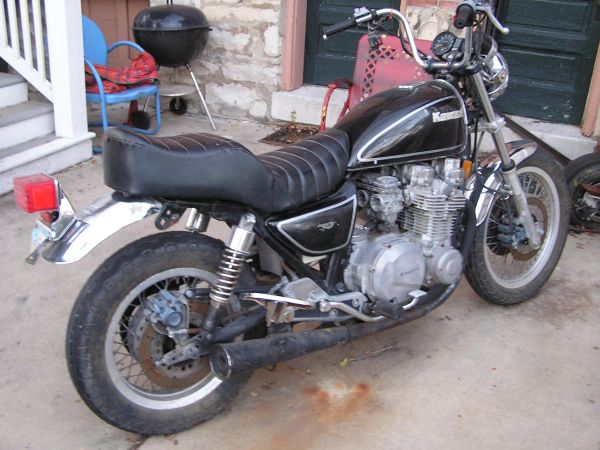

My rear brake pedal was seized on my LTD too, when I first got it. And my 81 CSR had sat so long, I had to remove the calipers to move it from the spot , and get it to roll n my trailer.. There were rust stains in the concrete under my CSR when I bought it.
Note the rust stains in the concrete. It sat for a bit.
Take special note on the bent over Kansas License Plate. This bike was purchased in St. Louis, sitting outside for many years dead, behind a brick duplex row house type apartment building. Rather than taking that clean title and registering it after writing down ALL of his info on the back of the title AND a lien release from a bank in Kansas, THIS hoosier just bent over the expired plate so that police could not tell it was expired. No sense in spending ALL of that ~35 bucks to title it. duh.
Also note no air box, or air cleaner of any sort. Whatddya need that for? Another nut and bolt rescue.
