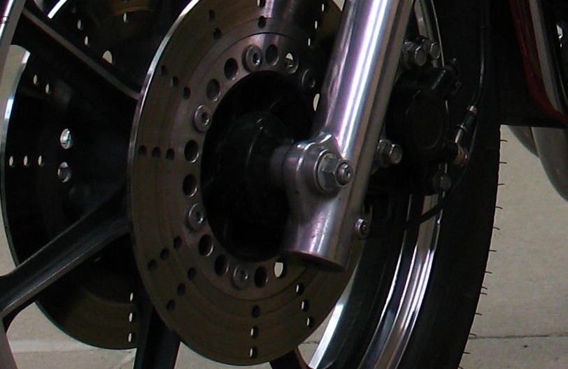

A pic would help.

When I get home I'll back the axle nut off and take a pic. It looks like daveo's pic now but I used the axle nut to clamp the forks together, and that's why I'm concerned. I dont know If that is normal or if it should have all lined up off the bat.

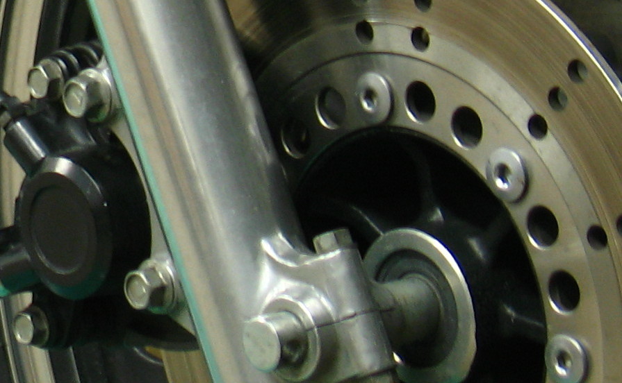

Pictures as requested. Although while taking these pictures I believe I have discovered the forks are in fact crooked still. Sticking my calipers between the forks and tightening them down then sliding it up the fork tubes causes it to be pushed out as I travel up so either the top clamp or a tube is bent.
I guess this is a classic case of I just needed somewhere to think out loud to work out the problem. Guess I'll get to tearing this front end back apart and see if i can find the culprit

With the bike on the locked center-stand, and the fork clamp bolts loose, spin each upper fork tube and note any change of the lower relative to the wheel at the axle.
If no change, then most likely the fork tubes are straight, and the triple tree is at fault.
I'd try this, but maybe there's a better suggestion or two.

If one clamp is bent chances are the other is too. Turning the fork tubes is a good test.

Case closed. After all these years of buying things on ebay you would think I would have learned my lesson by now. If I had checked these pristine looking tubes before I installed them I would have easily seen this small bend in one of the tubes and had this fixed 24 hours ago. I guess now all that's left is to use one of my old tubes and message this seller about the rating I'm about to give him after he promised me in messaging both of these tubes were straight. I appreciate the feedback guys. I just needed someone to confirm the forks should have sat flush against the wheel and I wasn't insane for wanting to pull the whole thing back apart again lol
