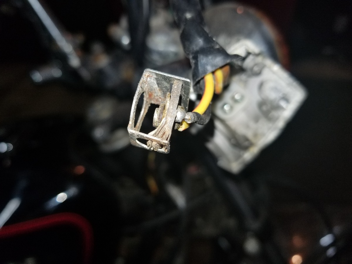

Re: Handlebar push start button issue
31 Oct 2018 14:37 - 31 Oct 2018 14:41
This might vary between models, but on the KZ750 and KZ250 I have experience with, the starter button was held in a little metal cage with the button on one side, and the contact with the wires on the other.
From this (bad) image here you can see the cage and how it clips onto the contact with the wires. What's not shown in this picture is the spring and button - to install a new spring and button, you remove the cage, fit the spring and button (it goes into the hole on the left opposite the contact), and then clip the cage back on. That way the button, spring, and contact are all one unit.
If you don't have that little cage it will probably never work correctly (unless it's not supposed to have it on this model - I don't know). If that's the case, buy the reproduction control unit, that $50 will save you a lot of hassle.
