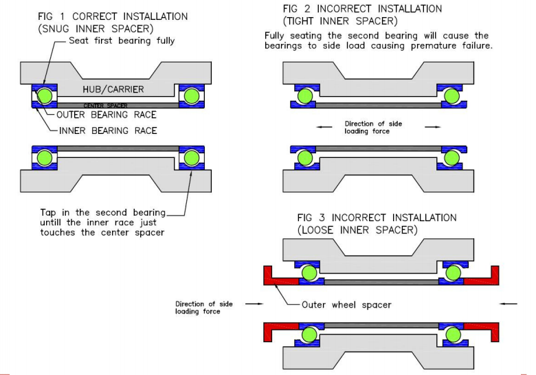

I too am late to this but I saved this pic years ago when I was explaining side loading to a friend. Sounds like the OP got his answer but this pic explains it well. Basically the second bearing should be tapped in until it just touches the center spacer. This prevents the bearing from side loading when the whole axle is tightened up as the center races, inner spacer, and outer spacers get "pinched together". The wheel hub just rides on the outer races and does not matter if it isn't seated all the way in the hub. Every bike I've had and currently have are this way.
