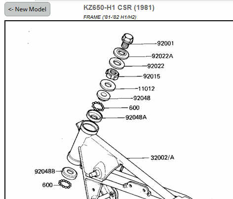

14 Sep 2018 09:10 - 14 Sep 2018 09:12KZB2 650 wrote: Been slowly gathering all the goodies I need for a rebuild from the front tire to the brakes and tapered bearings....... glad I saw this as I could see me making the mistake of leaving the stock races alone if they look good. I take it they come with the bearing kit from all balls ? and has anyone beat them out another way as the dremel scares me and I don't have a welder. Suppose I should look through the manuals but you guys usually have all the answers.
If your bike has the stock ball bearing races you must replace them with the tapered roller bearing races if you install tapered roller bearings. This is because the tapered roller bearing races are very different than the ball bearing races. The All-Balls kit comes with the correct races and bearings.
Removing the old ball bearing stock races is not particularly difficult and does not require a welder or Dremel. The inner circumference of the stock ball bearing race is slightly smaller than the inside diameter of the steering stem tube, so there is an edge of the old race that you can tap against to remove the race. The way I did it was to use a metal rod that would reach through the length of the steering stem tube. I put the rod through the steering stem tube and against the inner edge of the bearing race and gently tapped the race out of the tube. Be sure not to tap repeatedly against the same spot on the race; move the metal rod to opposite spots on the old race so you don't jam the race in the steering stem tube. Just gently work on it until it comes out of the tube; no need to beat on it with a lot of force because doing so might jam it. Once it is removed clean the steering stem tube and apply a small amount of grease to the area where the new race will seat. I used a piece of PVC pipe against the face of the new race when tapping it into the steering stem tube; that way I didn't hit the race with the hammer. Be sure not to repeatedly tap on the same spot when installing the new race or it will jam in the tube. Another tip for installing the new race is to put the new race in the freezer for a couple hours before installing it. That will cause it to temporarily contract a little which should make it easier to install in the steering stem tube. I read that tip after I had finished installing mine, so I didn't try it, but it sounds like a good idea. Ed

15 Sep 2018 13:37 - 15 Sep 2018 13:37martin_csr wrote: In his last reply he said the conversion had been done already. Is the bearing properly seated? I would carefully measure & compare the old stuff to the new. Maybe the previous conversion was done using Kawasaki steering bearings & perhaps the oem race is different than the All-Balls. From the diagrams at Partzilla the KZ750-L3 for example came stock with roller bearings, so you could use eebbaayy pics for comparison. I would think they'd be the same, though.
He stated he has a 1981 KZ650 and stated ".....glad I saw this as I could see me making the mistake of leaving the stock races alone if they look good." The 1981 KZ650 came with ball bearings in the steering stem (see image below), so assuming his statement that the bike has stock races is accurate it would have ball bearing races rather than tapered roller bearing races. Ed
