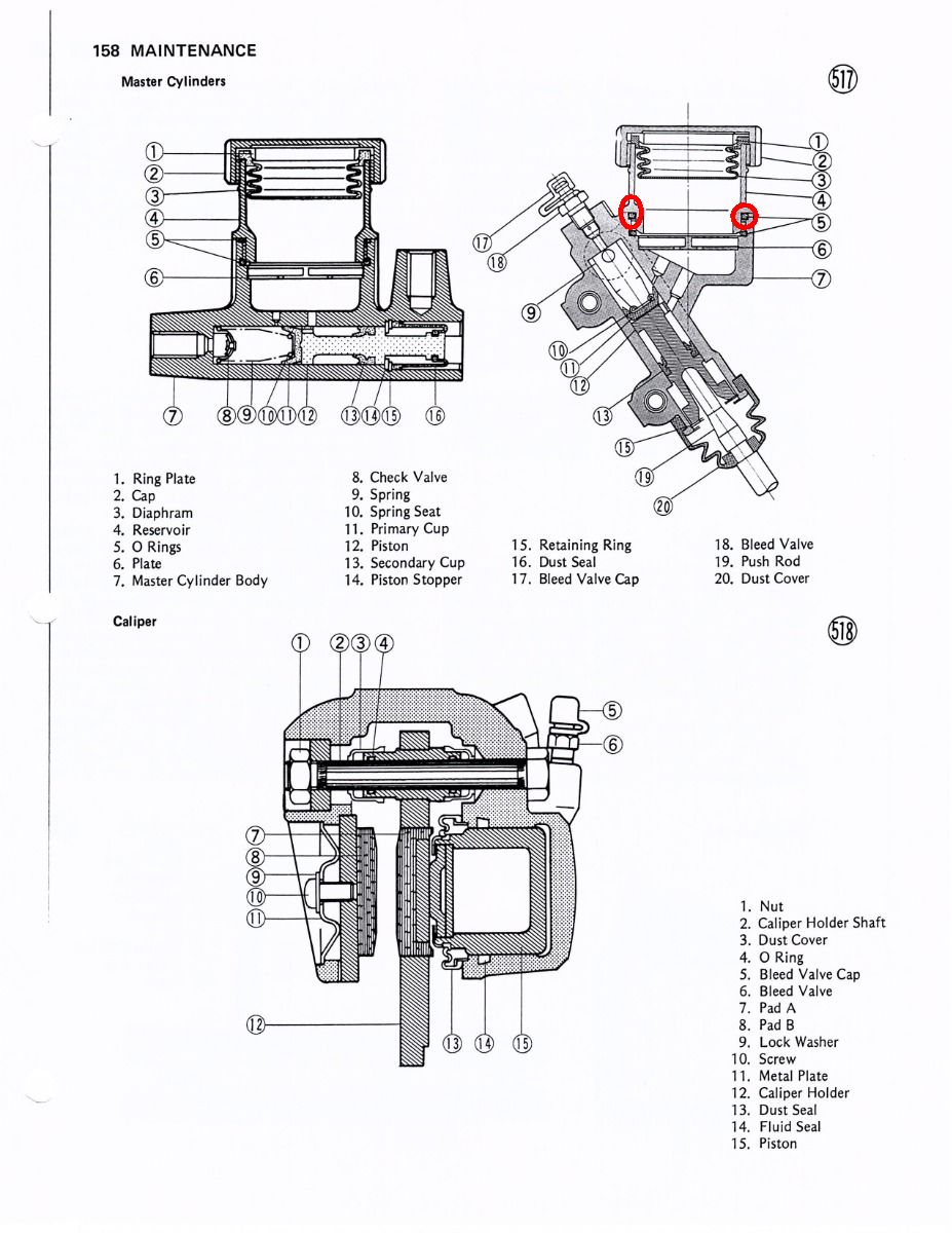

Any pics of the reservoir inside
The o-rings hold it together, a little force/pressure is needed to separat the parts, like some air pressure through air bleed valve #18 with the cap #2 on.

Scirocco thanks for the input. I did try, plugged all the ports and put air to it. Unfortunately it didn't move the reservoir (air leaked out of the reservoir o-rings). but got a little more of the gunk out.
So between kerosene and vinegar/ATF baths
and blowing we got it pretty clean. The supply port is not plugged anymore, but not sure about the relief port.
Its building pressure at least, but haven't been able to get a good bleed yet. Wouldn't be surprised if the lines/caliber or gunked up also.
Just more playing around we get to do.
Thanks for the thought and thank you Rob for all the help.
