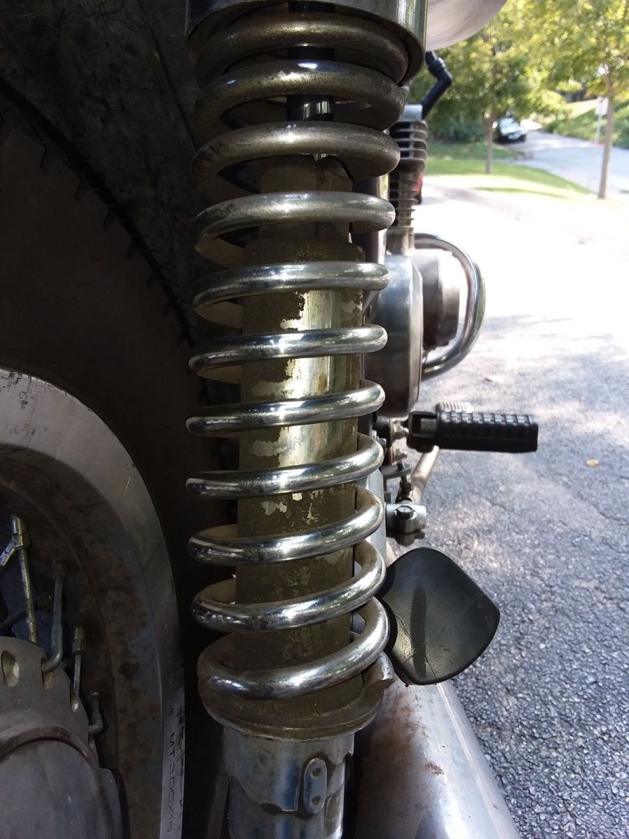

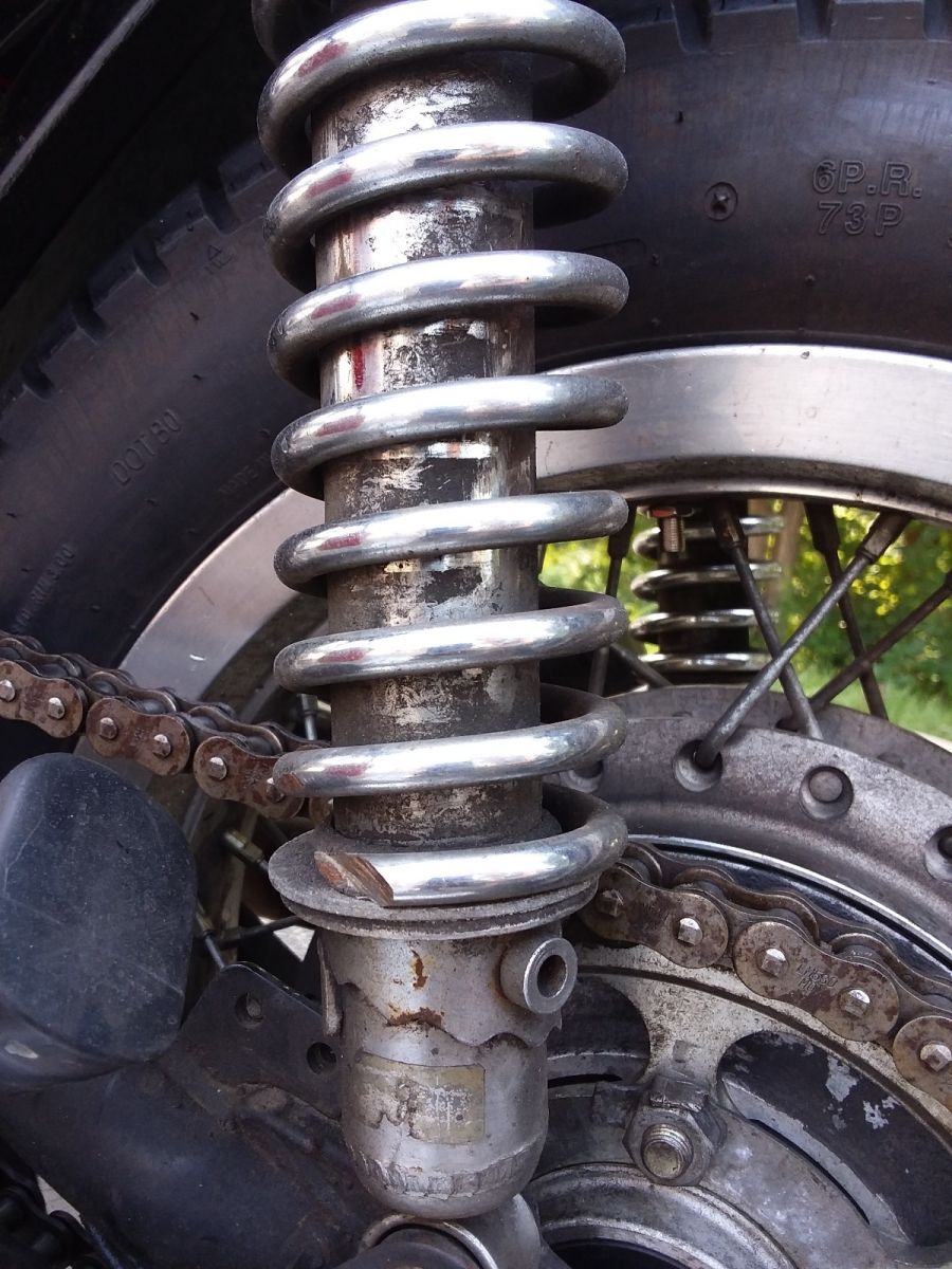

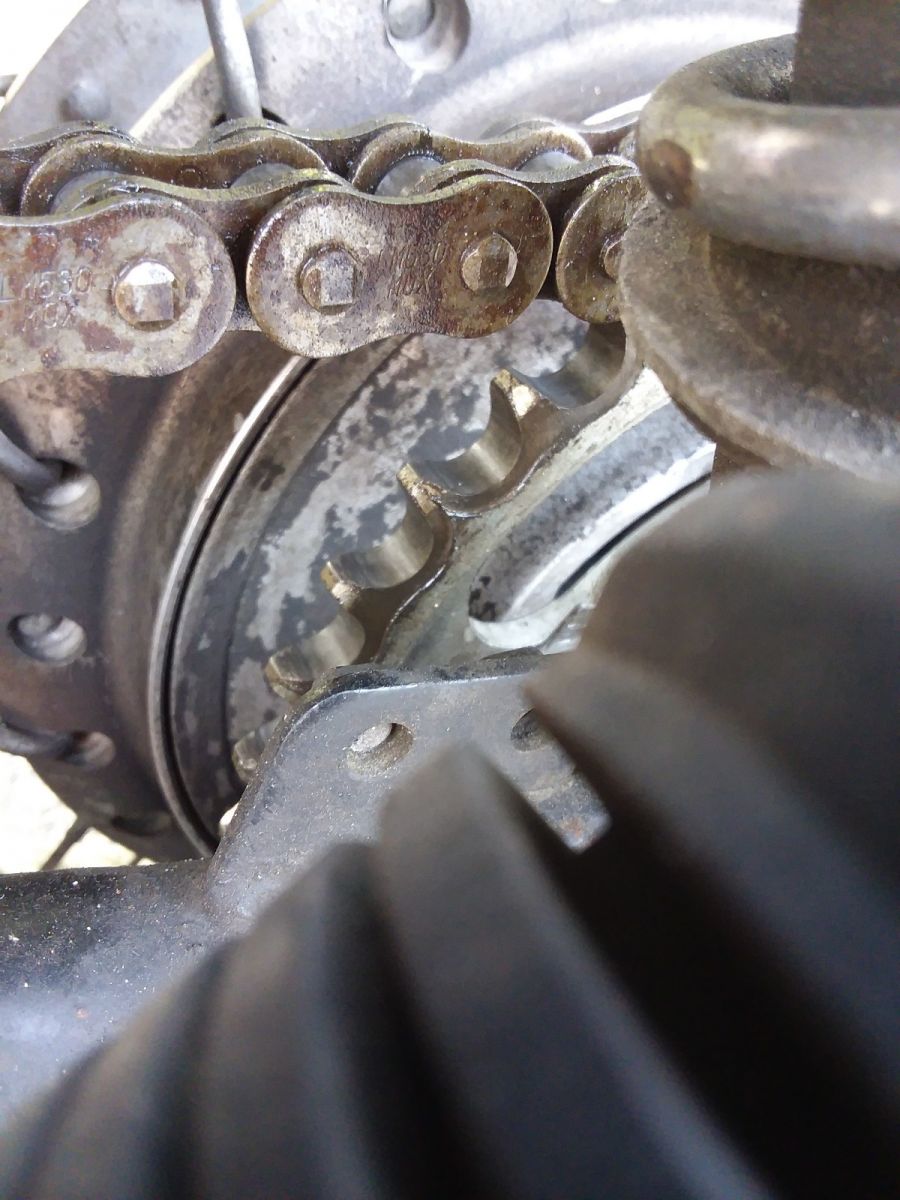

The first is the indents on the sprocket the others are the shocks being cut and kicking out. I did notice today that when I downshift and hit the brake it felt like it "drifted" I didn't look at the axle marks to see if either side moved but i don't think it did. If it didn't move what would be subject to look at? Wheel bearings?

The sides of the sprocket teeth should be beveled, but I can't tell if yours are worn.
You could compare yours to new or NOS sprockets on eebbaayy.
Shocks. To swap shock bushings I used a c-clamp & socket.

As martin_csr determine, the rear sprocket tooth side wear looks like the rear wheel (sprocket carrier) is not proper centered in the swing arm.
I have seen a lot of bikes where the collars and spacer are switch from left to right side and vice versa, internaly missing bearing spacer or replaced with unknwon bike parts, the list to long for a write up...

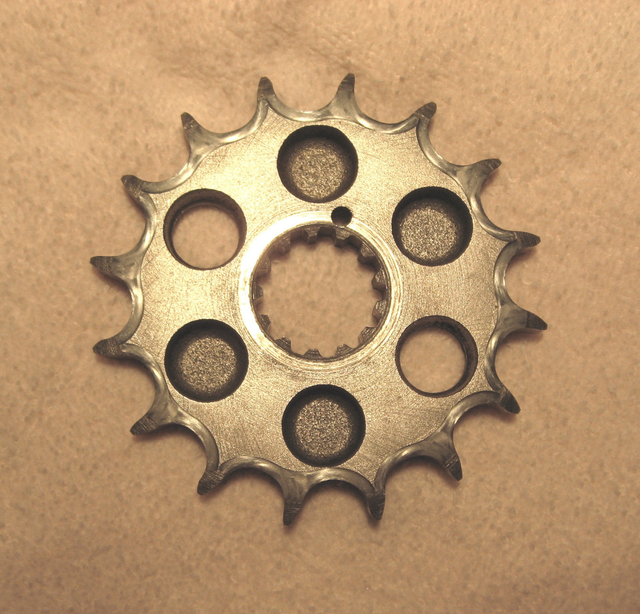

Having the spacers and even the chain adjusters oriented correctly is a must for proper chain and sprocket wear. The picture below shows the condition of the original engine sprocket on my 1977 KZ650-C1. The rear sprocket had similar wear. That photo was taken when I replaced the sprockets and chain at 36,000 miles. I found that the chain adjusters were installed incorrectly, and that error had happened when the bike was new. Unlike some other KZ models, on the KZ650-C1 the two chain adjusters are intentionally different in that one that goes on the right hand side has a spacer attached to it and the one that goes on the left side does not. Since the chain adjusters had been mounted on the opposite sides instead of the correct sides the rear wheel was offset a bit, and that’s what cause the abnormal wear to the sprockets. After finding and correcting the problem I installed new sprockets and chain, and now after 25,000+ miles there is zero abnormal wear to the new sprockets. Ed
