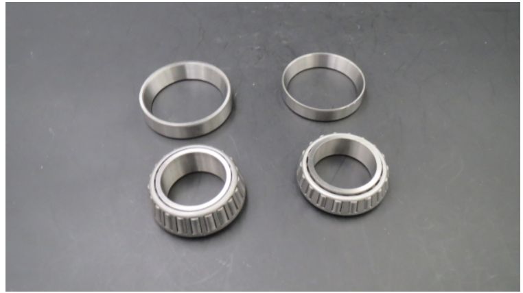

Have to ask, did you check your steering neck bearing Play?
A modern taper roller bearings upgrade is a must have on every old Kawasaki.
www.allballsracing.com/22-1014.html

I have not replaced them yet I will very soon. The extra set I have has smaller springs don't know how much it can or will effect it. Just have to get a bushing out of the existing to put in the new set. And the stearing neck doesn't seem to have any abnormal play I will look into it though

High Speed wooble is the master Problem of the old steering neck bearings, don“t ask how do i know it....
Poor rear swing arm bearings and old stock rear damper effect the same issiue.
