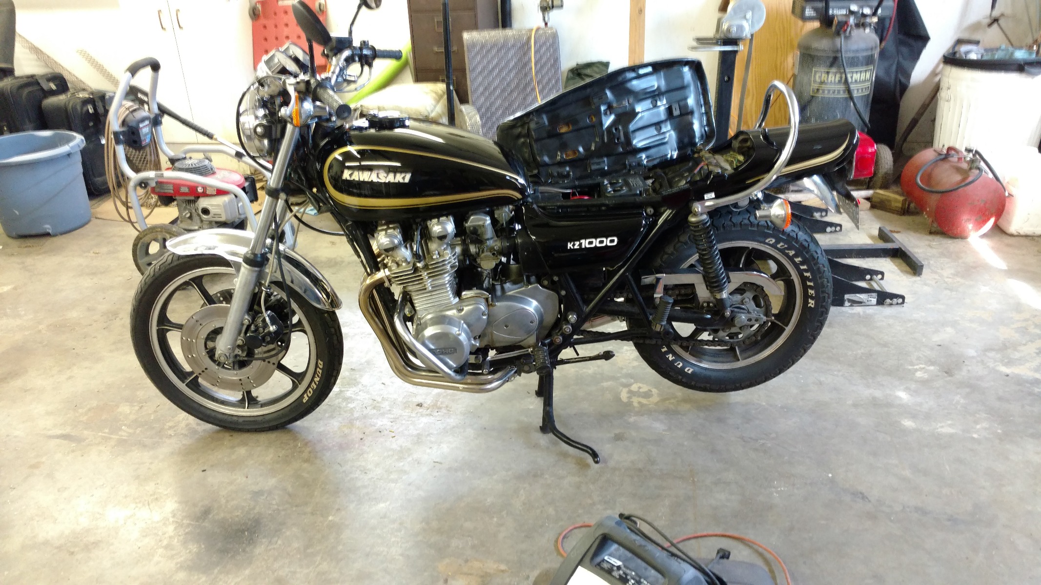

MissionKZ , My bike on the rear and front has no cover. In the service manual I see where it says take off cover on the rear caliper... My caliper is nothing like that one. You do have to take caliper off rear and front..Here are some pictures of my 1978 Kawasaki 1000 LTD u can look at the pictures front caliper and rear caliper there is no cover to take off!! I also see where they say take the front wheel off to replace the pads?? Lots easier for me to take the two bolts on the caliper remove caliper , replace the pads ,then reinstall the caliper instead of removing the wheel then replacing the pads???

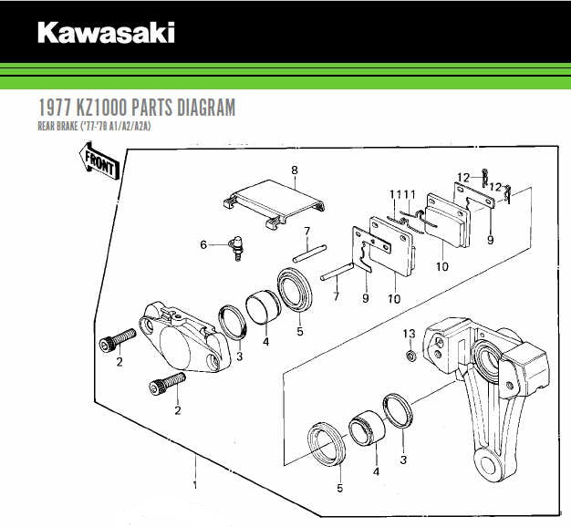

According to the parts diagram, the easier to service rear caliper with the cover came out in 1979.

Re: Taking rear caliper off 1978 Kawasaki 1000 LTD
02 Aug 2018 00:18
I bought my 1977 KZ1000A in late 1976, before Xmas of 1976 and picked it up from the dealership in late winter of 1977. I have been the sole owner of it... always.
It was made in Japan in October if 1976.
The serial number is .... 6828.
It has always had the rear caliper/carrier assembly with the top cover for easily replaceable rear brake pucks.
I have assumed from that point on, they all did.
No idea where that other info about the 1979 on, rear cover caliper/carrier came from, but I can assure you it is untrue in my case and the same with my B model KZ1000 LTD.

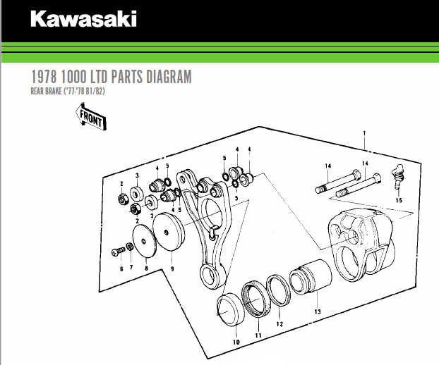

- Thanks: 2830
02 Aug 2018 04:08
It seems odd, but unlike the 1977 KZ1000-A the rear brake caliper on the 1978 KZ1000 LTD is the closed type like my 1977 KZ650-C1. Ed
