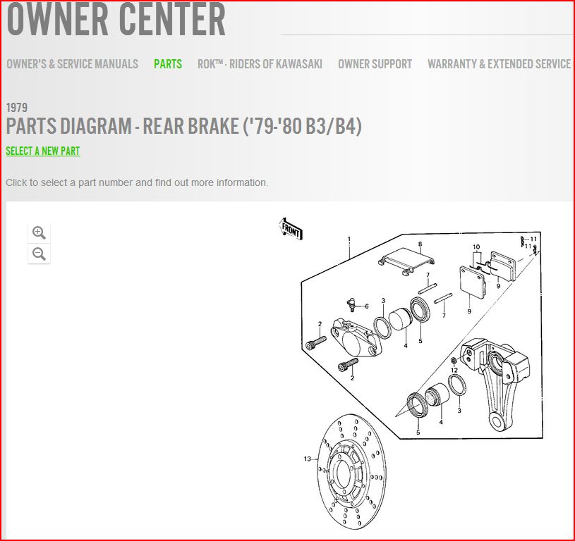

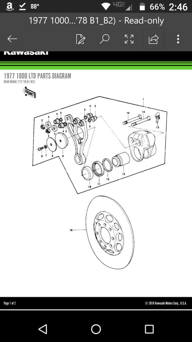

Interesting.Partzilla shows the single piston model for both '77 and '78. I'd be inclined to believe Kawsaki on this one. Also interesting is that Kawasaki evidently went back to a similar, but not identical twin-piston setup for '79-'80.

It certainly looks like the '78 rear caliper was unique, and not in a good way.
As I stated above, the parts diagrams at Kawasaki.com show a twin-piston caliper for 1977 and 1979-1980. The single-piston is shown for 1978 only.

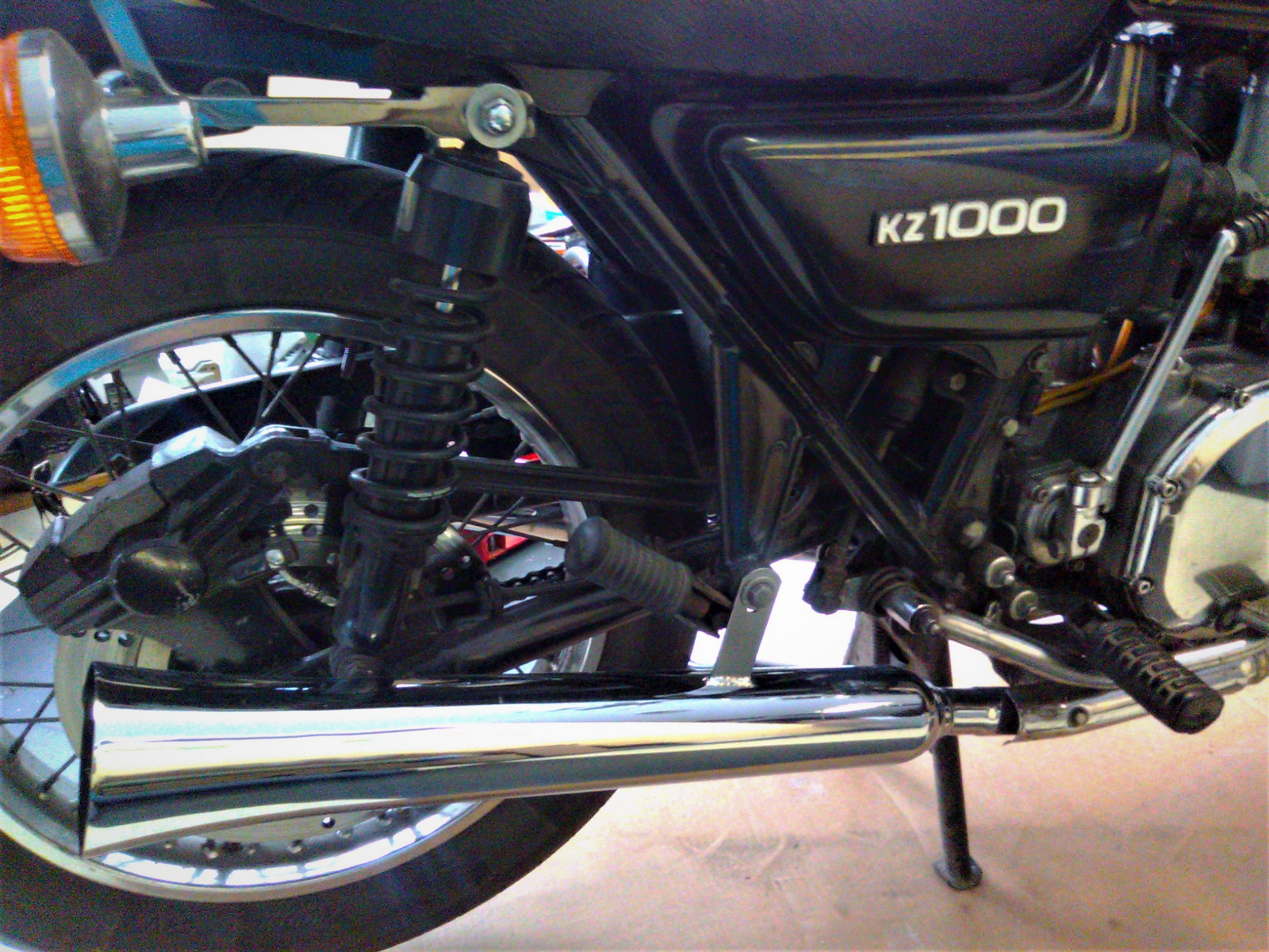

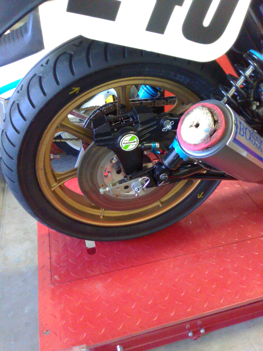

My 78 with a 18" spoke rim has the 2 piston caliper and it is no problem to change pads
I think that they went with the smaller profile caliper because of the 16" mags.
Here is my 77 LTD parts bike.
My 78 standard
My 78 standard
78 KZ1000 A2A

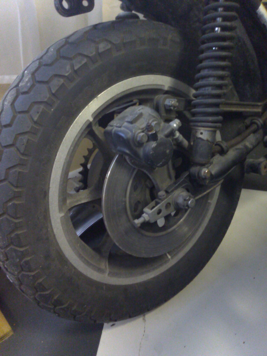

I stand corrected. I looked around at a bunch of old photos and it looks like the rear mag wheel’d LTD bikes, and even mine, did use a closed carrier/caliper!
My memory failed me.
But my 1977 KZ1000A has always had the open top caliper rear wheel assembly, as previously discussed in this thread.
