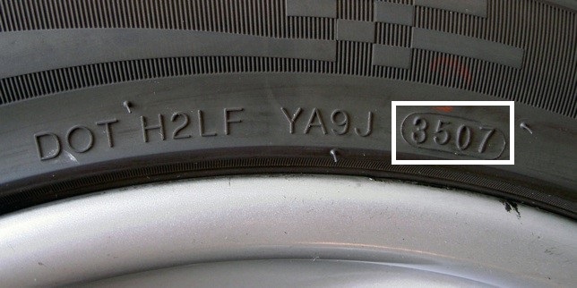

The tire date code is usually in a small oval. week first, then year. for example this tire was manufactured in the 35th week of 2007. if tires are over 5-7 years old its best to replace them.
Last edit: 26 Jun 2018 15:50 by DoctoRot.

Thanks for the replies! I'll go ahead and replace both tires before I do any highway riding. Thanks for showing me the date code. Usually I'd be smart enough to look up something like that, but I was assuming it'd look like a food expiration date. I haven't had a chance to check those dates or fix my alignment yet, but I'll give that a try next time I'm home.
