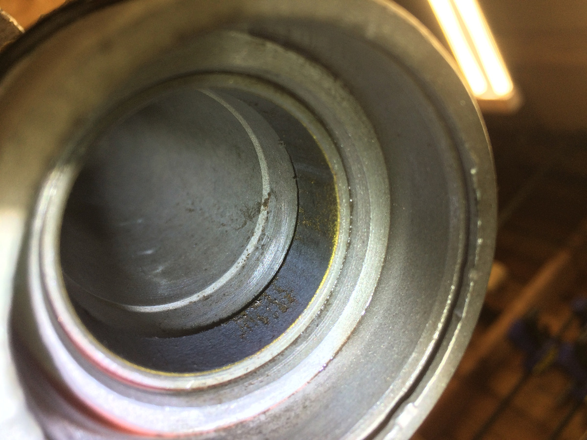

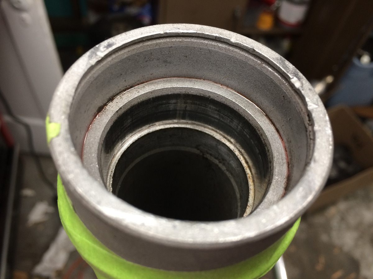

I recently had a set of 1978 kz1000 fork lowers powder coated. despite my CLEAR INSTRUCTIONS they did not mask off top of the fork tube. I'm pretty pissed about this because I literally wrote "NO" where i wanted them to mask. They only masked for powder not the sand blasting. It doesn't seem like the sand blasting got into the tube too far, but it did peel a bunch of Teflon off the bushing at the top of the tube where the inner tube rubs. There is now quite a bit of play between the fork inner and outer at this location. This coated bushing is not shown in the parts diagram, nor is it mentioned in the service manual. It looks like Racetech has a bushing that has the correct dimensions that may work (36x12x2) I have another pair of forks that I could use but the caliper mounts have been machined on these for my caliper conversion; something I would rather not do again.
how do I get this bushing out? there is very little lip on the backside, probably less than .5mm. Also its in there pretty deep, my seal puller won't reach it.

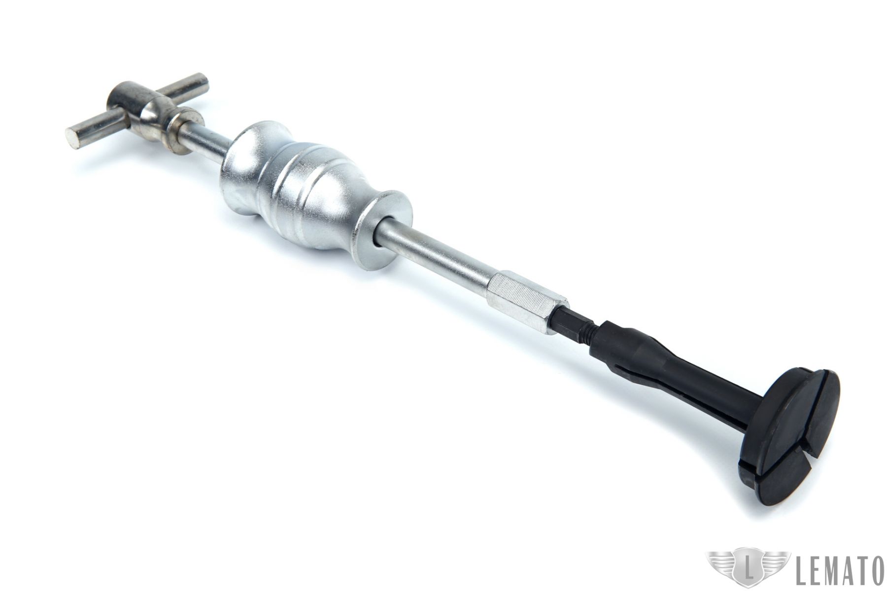

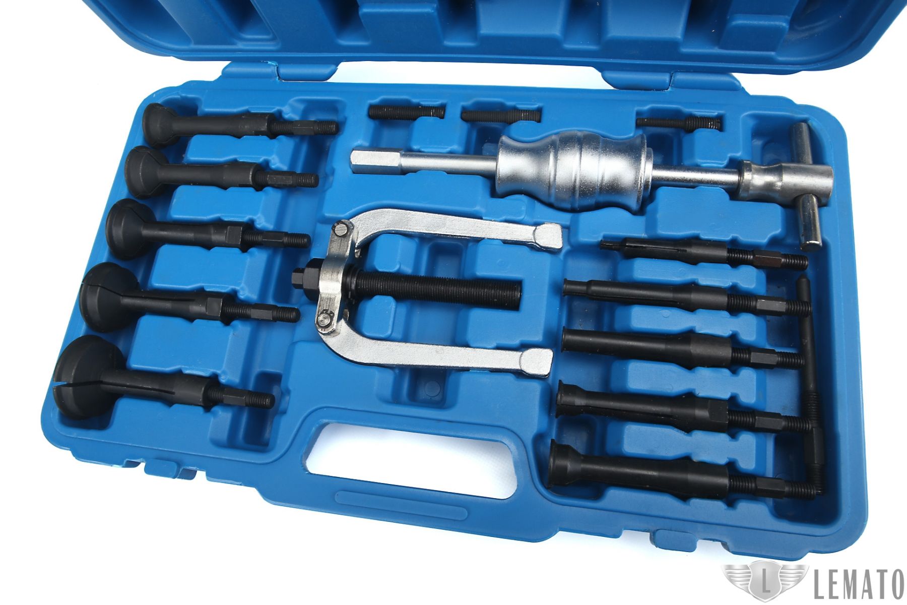

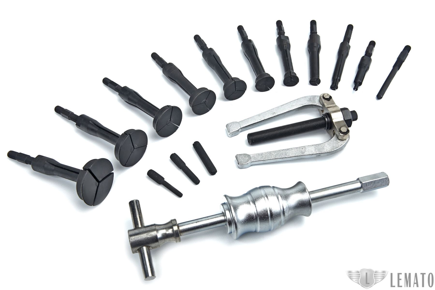

You need a inner bearing puller, 80 Euro this set.
lemato.nl/product/hbm-17-delige-binnenlager-trekkerset-11-58mm/

Doc, an autoparts store that lends out tools might have a 'blind hole puller' as they are frequently used on the pilot bearing in the flywheel of manual trans cars and trucks. Those are far smaller in diameter, but if the tool comes in a kits as shown above, you may have a solution.

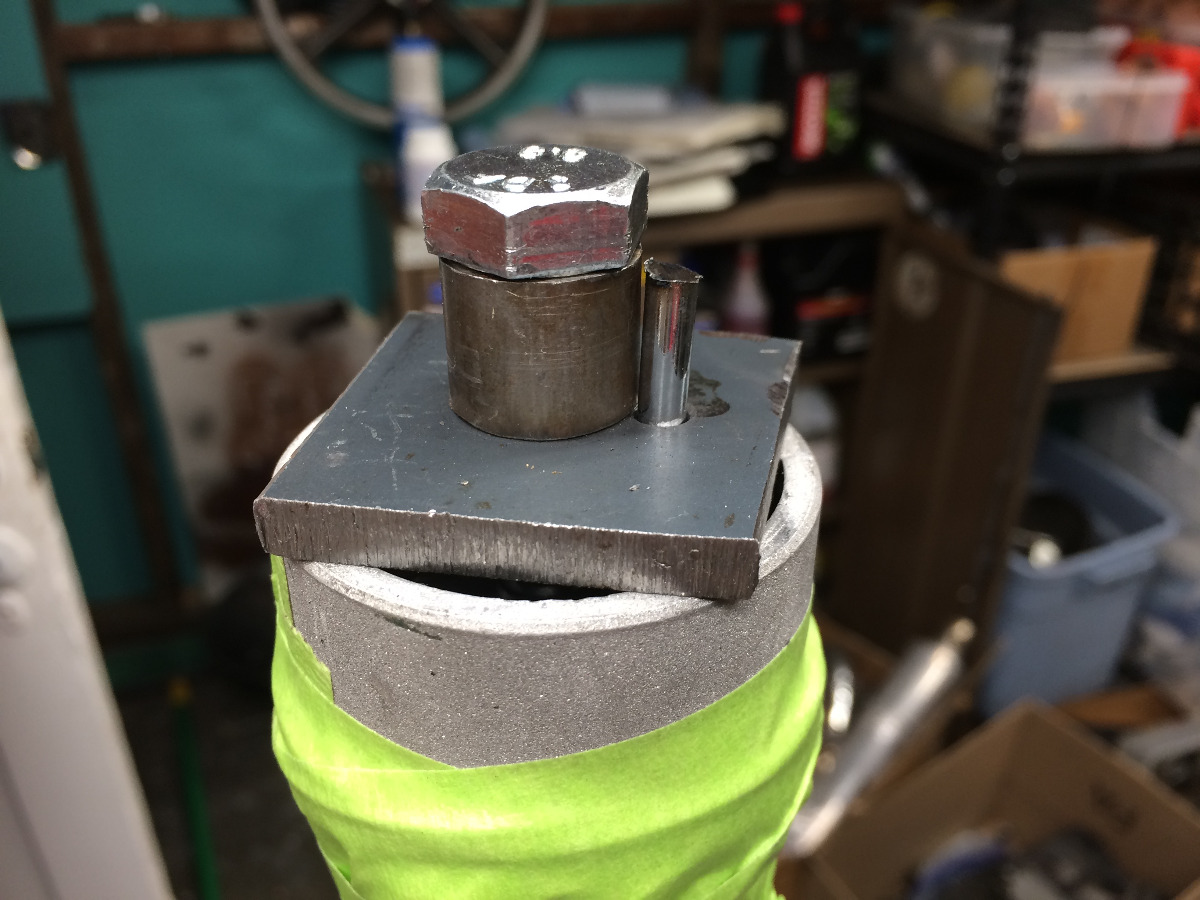

Through some fugly butchery I was able to extract the bushing. I first turned a 37mm washer that was 1/4" thick. Drilled and tapped that and flatted two edges so it could be passed though and reoriented to catch the bushing. it pulled out easy. The small bolt is to keep the washer from spinning. just waiting on new bushings and the forks can go back together. best part is it cost me nothing but and hour of my time
