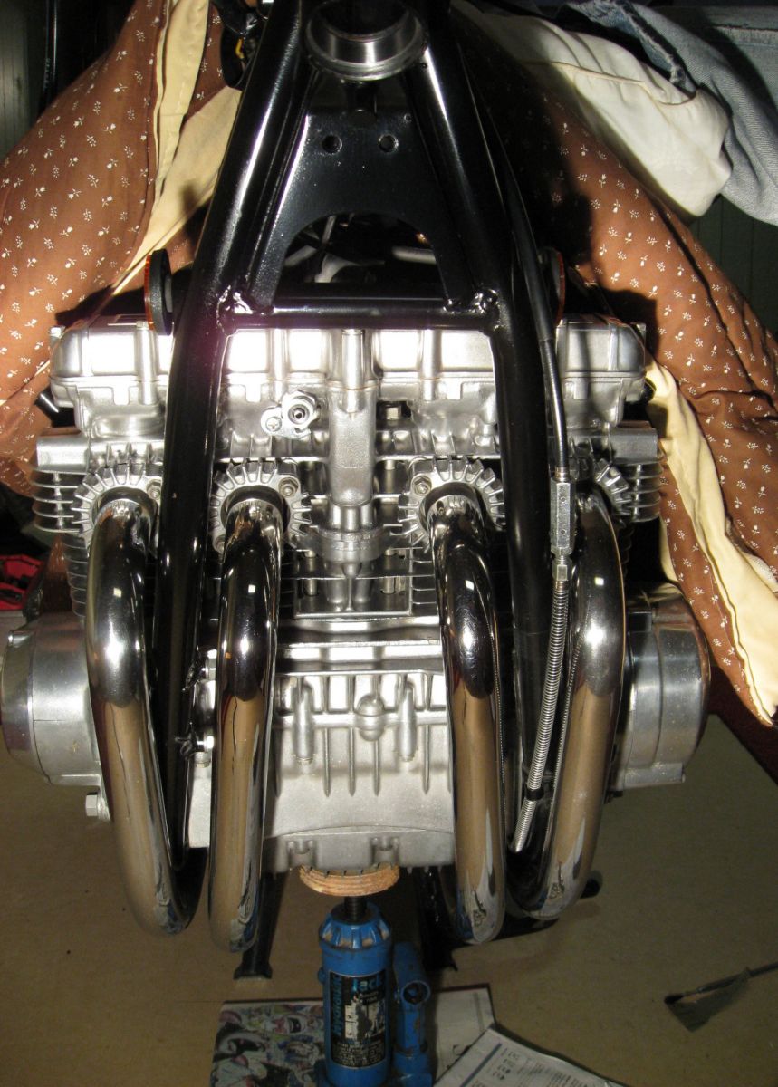

Since your bike has a centerstand you should be able to use a bottle jack under the front of the engine with the bike on the centerstand to raise the front tire off the ground. On my KZ650-C1 I put a small piece of wood between the jack post and the oil pan to ensure the jack didn't damage the pan and made good contact with the pan. Then I gently pumped the jack up until the rear tire just barely touched the floor - don't pump the jack too high or you can lift the bike off the centerstand and the bike will fall over. Then I removed the front forks without a problem (see pic below). Be sure to do this on level ground, not a hill . Ed

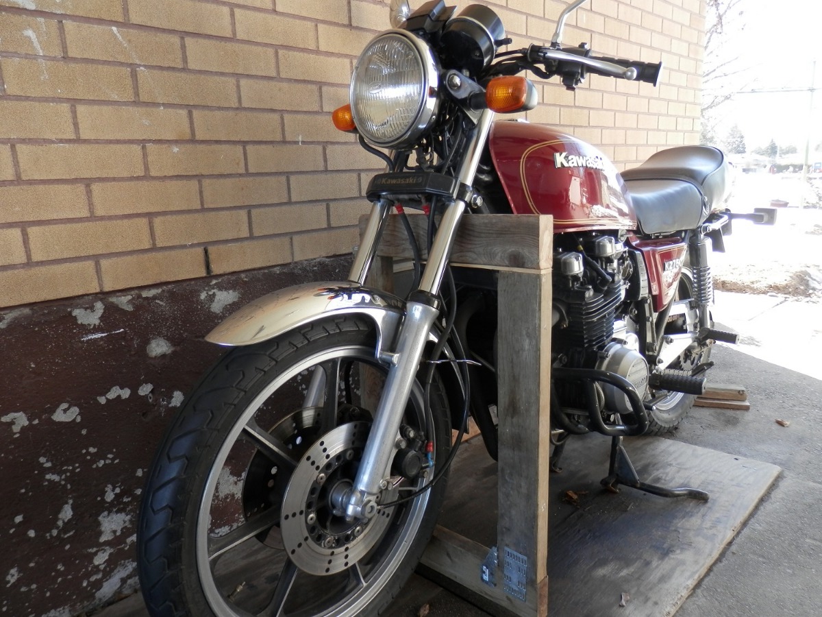

with center stand on a bit of 1/2 inch plywood I slip wood frame under the triple tree. The top horizontal 2x4 slides in and out and is sometimes replaced with a longer length when further leverage is required

That is pretty darned simple and ingenious JR.

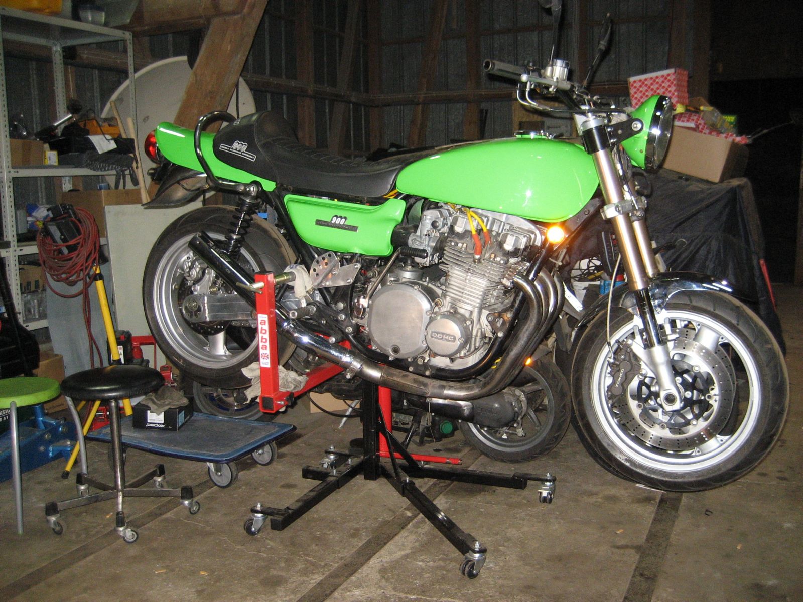

I managed to get both wheels of the ground with my ABBA bike stand.
My back is very happy about this.
