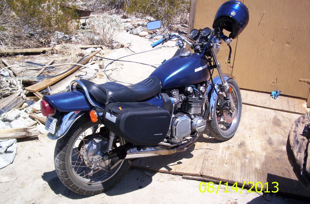

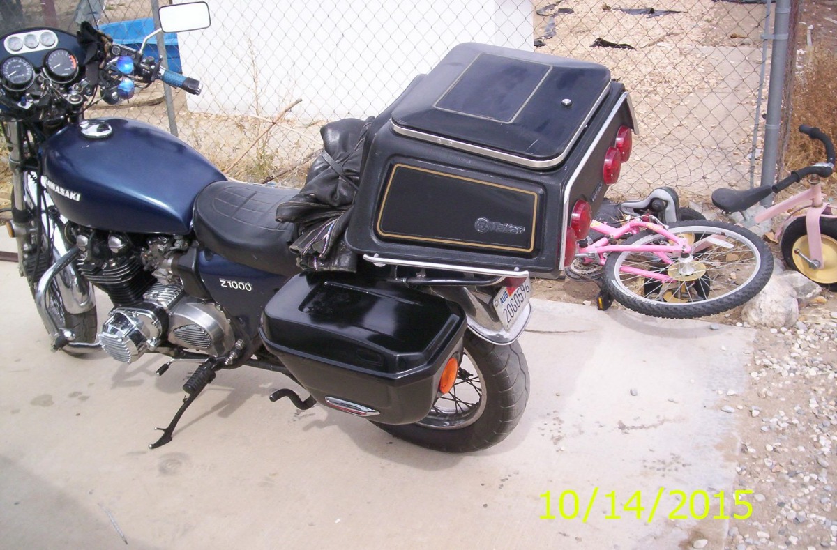

I got some but they started fading the first season. I liked them but I knew they wouldn't last. I go visit my grandchildren almost every month so I carry a lot of gear and tools. My bike laptop rides in the top box along with other things.

I'm not too concerned about fading, at the moment I'm just trying to figure out how they're supposed to be mounted and such. I have that seat pan and plan to make a custom seat at some point. On my last bike I went through a couple of seat covers that kept ripping apart at the center hump so I finally made my own with the proper allowance to fit over the foam. I found some marine-grade vinyl that held its color for about a decade before I sold the bike, so I plan to use the same material in the future to make the new seat, a backrest, and possibly some custom saddlebags. Unfortunately there's already too many projects stacked up for this Summer so it will be awhile before I get to any of that. In the meantime I'm trying to see if I could buy a couple of smaller bags off ebay and somehow strap them up to the bike.
I'm surprised at how far forward your soft bags sat. Did that ever cause problems getting on and off the bike or just putting your legs down when you stopped? I see a foot peg poking out underneath in one of the pics so I guess that eliminates any possibility of a passenger.

The bags were soft so I was able to make a dent in them for the signals moving them rearward. They have Velcro straps and quick disconnect straps that go to the frame. I didn't want the "Bagger" look but what I have works for me.
