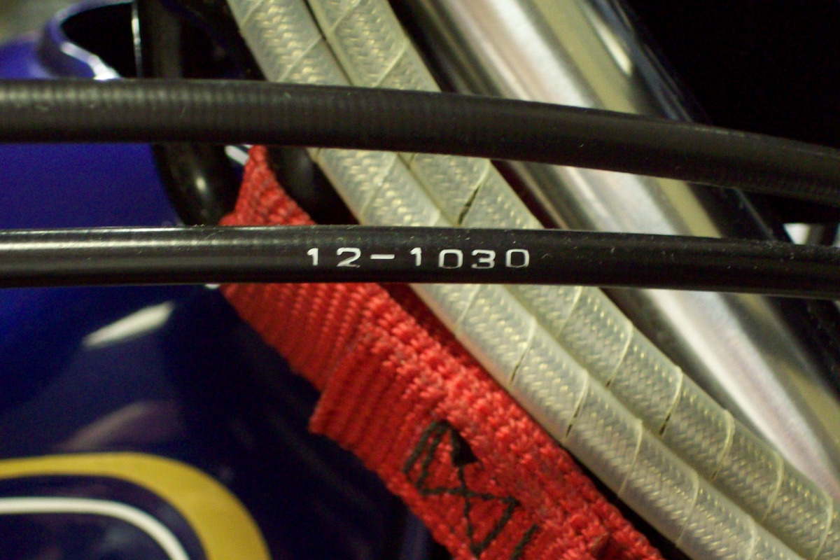

This might help you identify what cable you have on your bike. Kawasaki always marks their cables with part of their part number right on the cable. Look up near the top of the cable, and see if you have in little white letters like "12-XXXX" That is most of the real Kawasaki part number you need!! Throttle cable part numbers are like 54012-XXXX back then!!!!
See that 12-1030, that means it is a 54012-1030 part number cable.

Cool, thanks. I'm going to be pulling the cable out after work tonight and taking the whole assembly to the dealer, but I'll see if my cable has a number or not. It's a frankenstien and the PO seems to have just thrown together every part they had laying around their shop, so by now I am completely unsurprised by every incorrect part I find.

The number on the cable (after much squinting and a few eyes looking at it) are 12-1089. The dealer looked it up, said that number has been superseded, and it is NOT something they can get any more. They were also completely certain that the throttle control pictured above, which I had removed from the bike along with the cable, was absolutely not a KZ part and all of the 1981 KZ1000 models used a push/pull pair instead of a single pull cable. Well guys, I've been looking at pictures online all day, and half the bikes I found clear pictures of did in fact have a single pull cable for that year, including both the J and K models. So I'm rather disappointed that their reference material seems to have had no information to indicate both styles were used around this time period.
What I *wasn't* expecting was for the KZ1000M to come into this discussion... However after looking up the part number and finding many of this exact cable for sale on ebay, it appears that this particular throttle may have indeed come from an M. And I already have several parts from the police model installed on my bike. So I guess my frankenstein now covers all four models of the '81 KZ. I don't know if I should laugh or cry, but I did do my best to pick what I felt was the best quality compatible part whenever I had to replace things to get her running again, so I'll live with that.
One interesting thing -- I decided to pull off the side cover from the throttle, and discovered it DOES have the 90-degree elbow inside the case, as part of the cable. And what I have appears to match exactly with the pictures I'm finding for that part number. If I had a full lookup resource available I would probably try to find a cable that is an inch or two longer than this one, but nobody gives any actual numbers for the cable lengths. At least I know I can route this one without pinching it anywhere so I'm safe getting another of the same.
The dealership DID point me in the direction of another motorcycle shop in town who has the equipment to custom-build cables using the end fittings that I have. So the question becomes whether I should do that, or buy one of the many NOS original parts on ebay which won't be here until next week? I'm leaning towards being patient and getting the NOS part since I don't what quality I'll get from this other place making a new cable.
Anyway, seems like I found the right replacement, so thanks again for all the help.
