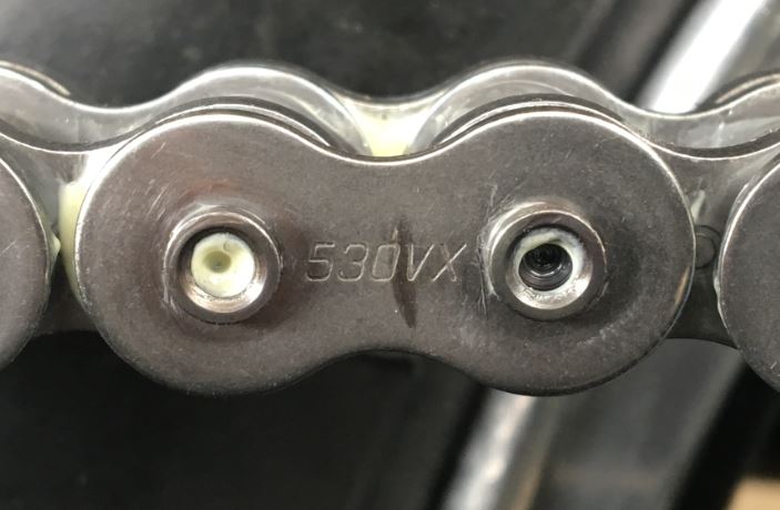

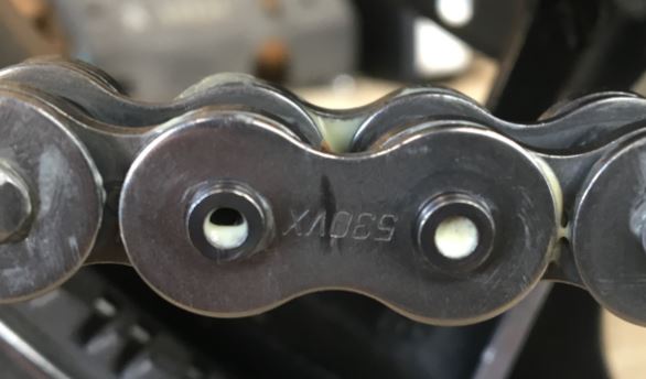

I installed the chain today, I think the lock is mounted correct and looks good?
I have attached some photos below.
My first time, so just wanted to let you see what you think, not good if it falls off...

You have to peen it over being careful it's not too tight. Best with the tool or done on the bench.

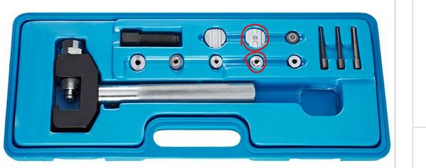

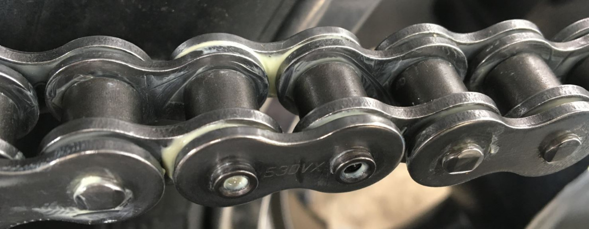

Do you have picture how it looks like when It`s finish ?
I have these tool, I have used two of the tool, marked with red circle. What tool shall I use for the penning?

It must be these toll I shall use?
I read a place I shall flair the diameter with 0,5mm ? so I need to measure the diamater first and then try to hit +0,5mm, is that correct ?

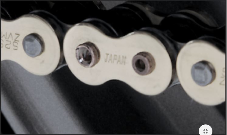

Your chain is made by DID so the head needs to be peened over in the way DID specifies.
Found this page about the DID tool... www.didchain.com/chainTools.html
According to this info the head needs to be flared to between .217"-.228"
Below shows what the pin should look like after flaring/peening (left pin flared, right pin still needs to be done.)

For me it looks like the insert I posted above shall do the work?

I'd give it a go; try your tool and measure the flare using calipers. I'd target the .228" flare diameter. Just be careful that you don't flare too much and bind up the chain.

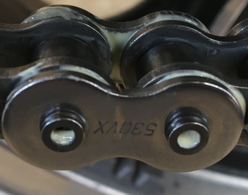

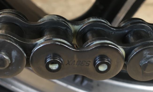

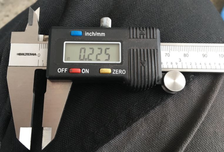

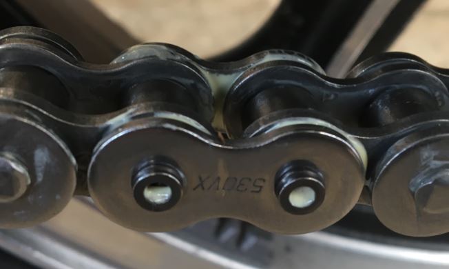

Today have I flared, please see attached photo, both is the same. The flaring was stopping by it self, I was not able to go further.
Maybe the tool is made for making a spesific flare, but I think it should be good now ?

.225" should be fine. Did you verify that the chain still flexes at the rivet link?
I think you can just run the chain with that white lube on it. After a few hundred miles it will make a bit of a mess though. Once the sprockets start to look dry then lube. The chain is lubed mostly from the inside but the lube outside is for the rollers and sprockets.

21 Apr 2018 14:59Nessism wrote: .225" should be fine. Did you verify that the chain still flexes at the rivet link?
Thank you, yes I checked the flexiblity, actuely it was more flexible after the flaring.
