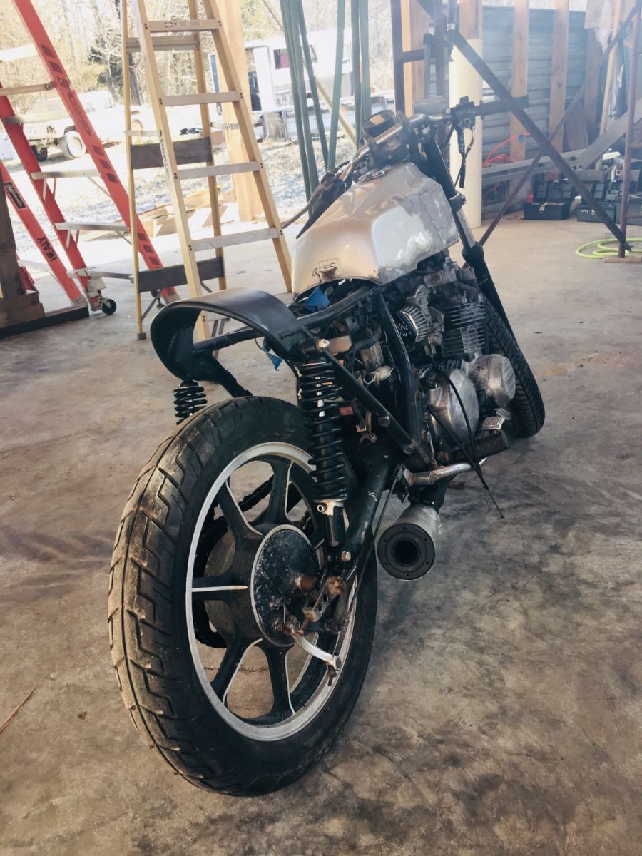

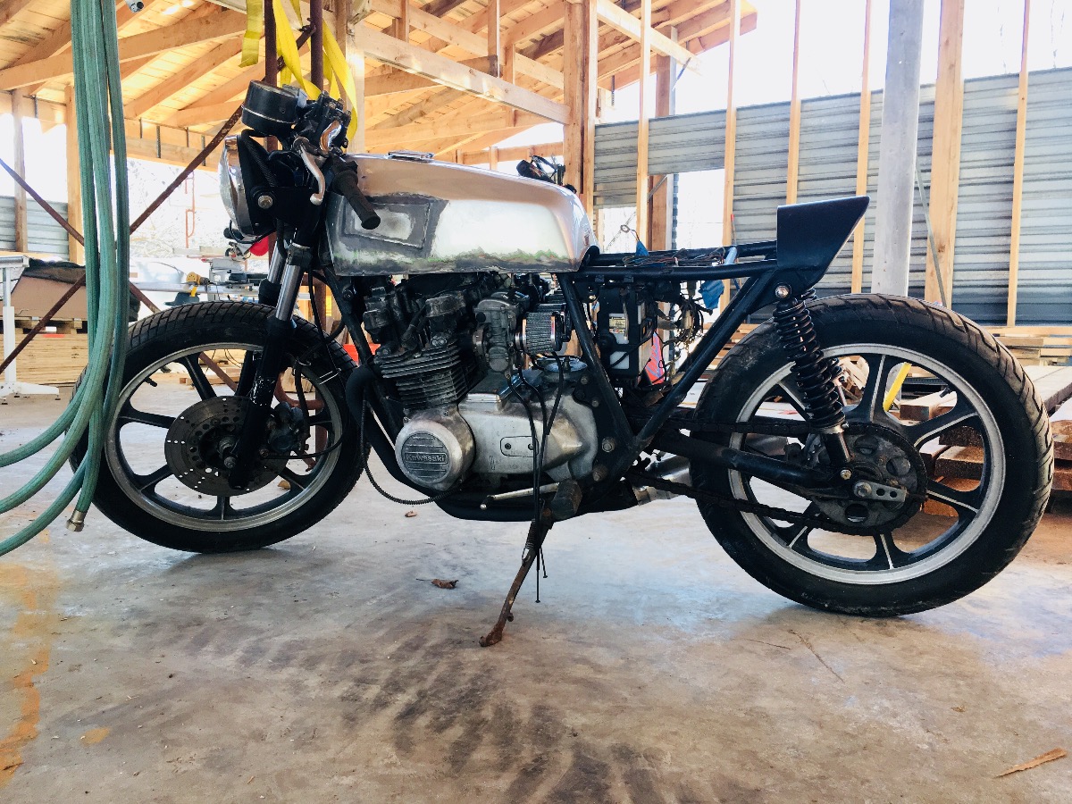

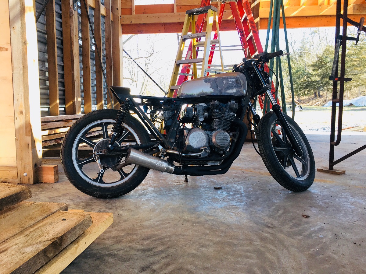

- axel
- Posts: 23
Re: KZ1000 rear wheel on KZ550
08 Apr 2018 06:58 - 08 Apr 2018 07:09
thanks to all for the insights!
i now feel confident that sticking with 120/90-18 is the optimal choice.
below are some pics of exhibit A.
still a work in progress, currently designing a seat and just finished rebuilding fuel tank(had to cut the bottom off and weld a new one because of rust).
also wiring needs to be organized and tucked away.
but completing the workshop build is priority. the bike is my mini vacation when i need a break from sawdust production. kind of funny that they’re in about the same state of completion.
the current rear tire is a 110/99-18
