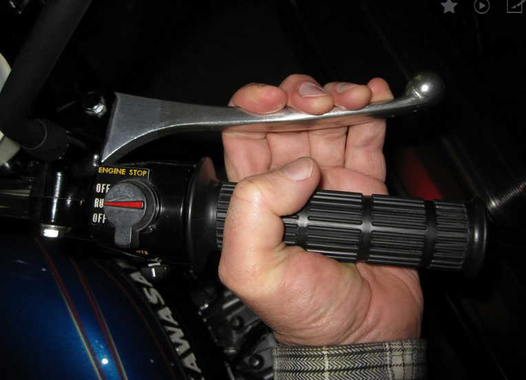

You might have to bleed the master too. I replaced the Brake Fluid on my C14 (I know different bike all the way around) I use a Mity Vac to remove old fluid which will drain the reservoir quickly if you are not careful which I was not. So I refilled the reservoir keeping a much closer eye on it and bled the calipers till the cows came home. I removed all the bubbies and still had a brake lever as you describe. Sometimes if one ties the brake lever tightly to the grip so the brake is applied over night, air will work it's way out of the little bleed hole in the master. After a night of that, the next day resulted with no difference in the lever. So I punted and bled the master. Ended up with a great brake handle with a ah ha moment.

You might want to try pumping up the hand lever and then squeezing as hard as you can, then strap the lever back against the grip. The idea is to create as much pressure inside the system as possible so the pistons move closer to the discs. Leave the bike with the lever pulled back for 24 hours and see if the lever firms up.

Nsssism, I've often heard the process you describe above. When I've heard it before the cap was to be left of the master cylinder reservoir. Cap on or off make any difference?

23 Mar 2018 20:18ajsfirehawk wrote: Nsssism, I've often heard the process you describe above. When I've heard it before the cap was to be left of the master cylinder reservoir. Cap on or off make any difference?
Doesn't matter.
