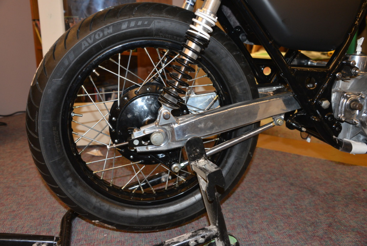

IIRC the bigger diameter axle has more to do with the width it is spanning. Most vintage bikes are spanning 9-10 inches at the axles while most modern bikes are spanning 12+ inches. this requires a larger diameter bolt to retain rigidity, also larger diameter bolts allow the axle to be hollow allowing for weight savings.
I put a '78 kz650 rear drum (17mm axle) on my '80 kz750twin (20mm). I have a modified GS1100E swingarm and because it is much wider I kept the 20mm axle. I found appropriate sized bearings for the hub to retain the 20mm axle. Then had the brake plate, and sprocket carrier spacer to bored out to 20mm. I also made a new internal spacer for the hub. Worked great.
