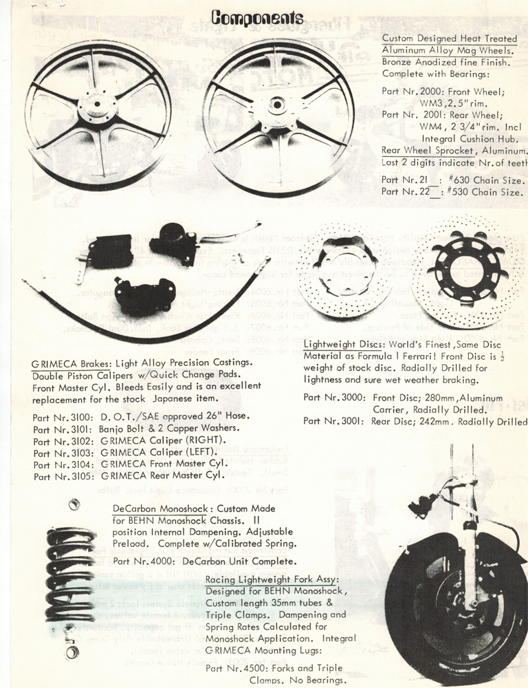

EPM (sold through Magni) had both aluminum and magnesium rims similar to the wheel in question. You could probably tell which it is by the weight.

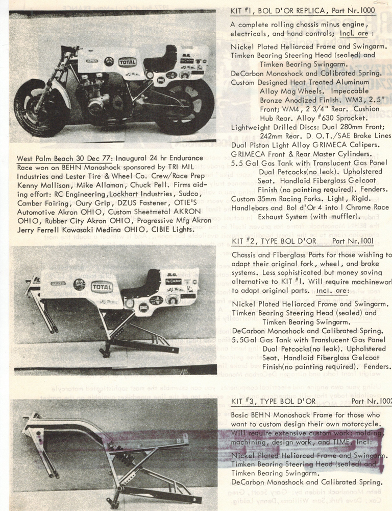

You guys are legends!
Looks like you could be right. Since the bikes a American import... could be someone at some point fitted the wheels and brakes?
Couldn’t find any recent links to r b racing? Would really need to get hold of that rear mastercylinder.
As you can see, the bikes a bit of a mash up...

Man that bike is cool though if a bit mismatched. If that is rear caliper indeed a p108 which I'm 99% sure it is, any 15mm master cylinder should work, do you have a brembo MC on it now?
