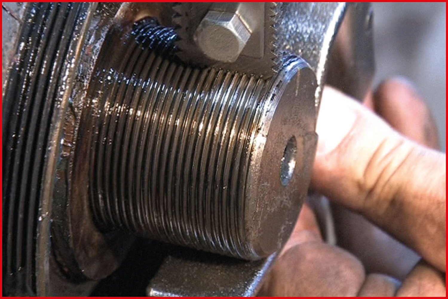

There is threat re-cutting tool up to 16 – 38 mm / 5⁄8″ – 1.1⁄2″
No need to remove the damaged rows. A good machine shop should do it easily in less a minute.

That's exactly the kind of file I'm using on the cap. The tube is where I'm having a tougher time. My goal is to be able to dry fit it before I assemble the forks. The material that's left in the tube is stuck in the threads and keeping the cap from spinning in.
Is there a file or something that will help clean out the threads?

If you cannot pick out the old thread debris using a dental pick you may want to use a thread chaser (not tap) to clean the threads. Ed
