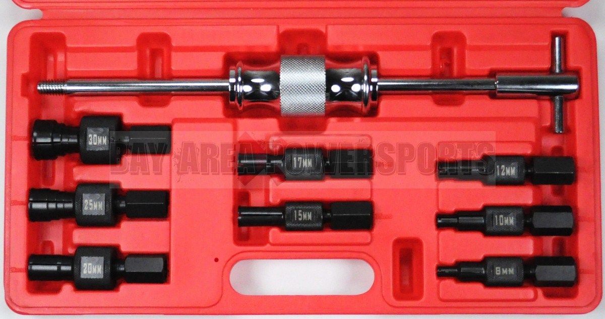

I use a blind-hole bearing puller and lots of heat.
It’s the only way I could get those roller bearings out of aluminum swingarms without destroying everything in the process.
They are invaluable for removing the wheel bearings as well.
Autozone has them in their free loaner tool program.

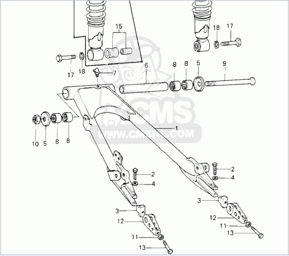

One question more, on partzilla it`s indicated two bearings one on each side, but as fair I can see are there 4 on my swing arm 2 on each side?
You need to get the tool beyond the bearing, but how ?
Sorry for not understand.

Hmmm, the parts diagram for the 1979 650D2 clearly shows 4 bearings.
www.kawasaki.com/Parts/PartsDiagram/143145/1979/KZ650-D2

To your understanding for the recommended tools, (bearing puller)
www.cmsnl.com/kawasaki-kz650e1-ltd-1980-...t/57284.html#results

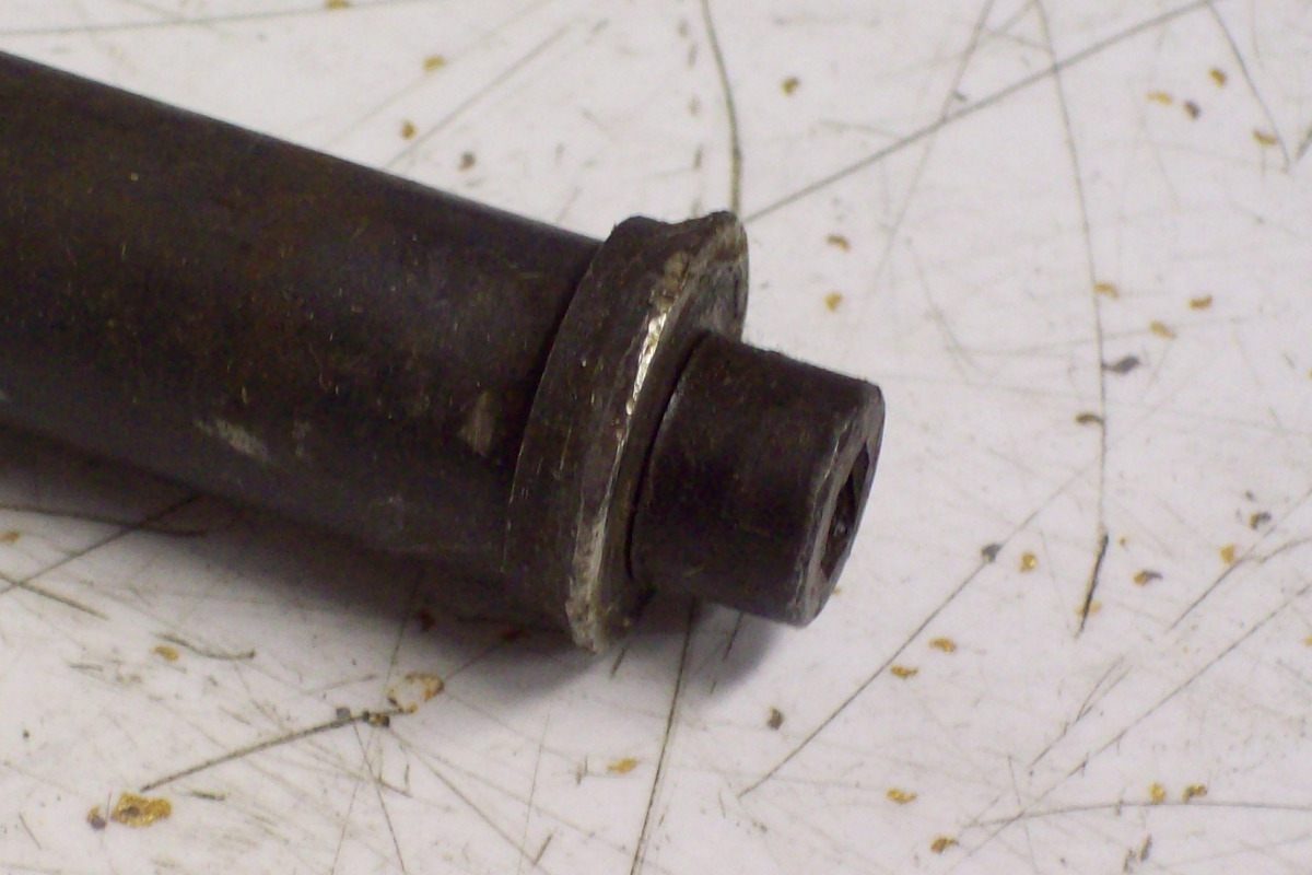

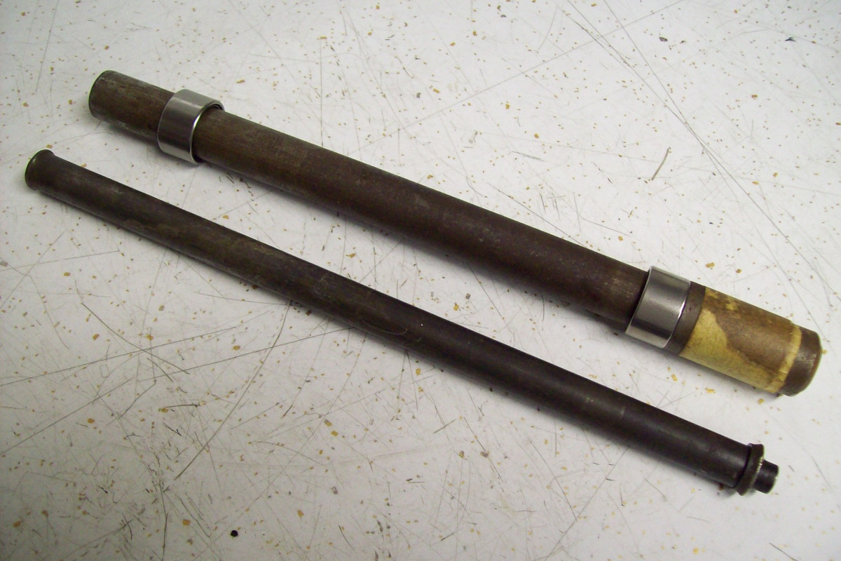

Best way I found to get the swing arm bearings out is make up a nice long tool that comes in from the opposite side of swing arm and catches on the lip of the bearing. Then with a good size hammer knock them out. The tool that I had made does not normally leave a groove when removing the old bearings. If you have any type of grooves or gouges inside the swing arm, you will have a real hard time getting the new bearings in place. The bottom tool in photo is the tool I use to remove the old bearings. If you do have any type of grooves or gouges, I would sand the inside of swing arm to it is smooth again.
The other tool is what I use to install the new swing arm bearings. Notice this tool distributes the force of pressing the bearing in place on the whole 360 degrees of the bearing edge. I insert this tool through the swing arm with a new bearing, and place a new bearing on the other end of tool to make sure the new bearing is centered as I install it. I have never damaged a new bearing when I used this tool to install my swing arm bearings. After you install the new bearings make sure the inner needle bearing spins freely inside its outer cage. If not, you have to start over with new bearings!!!!
