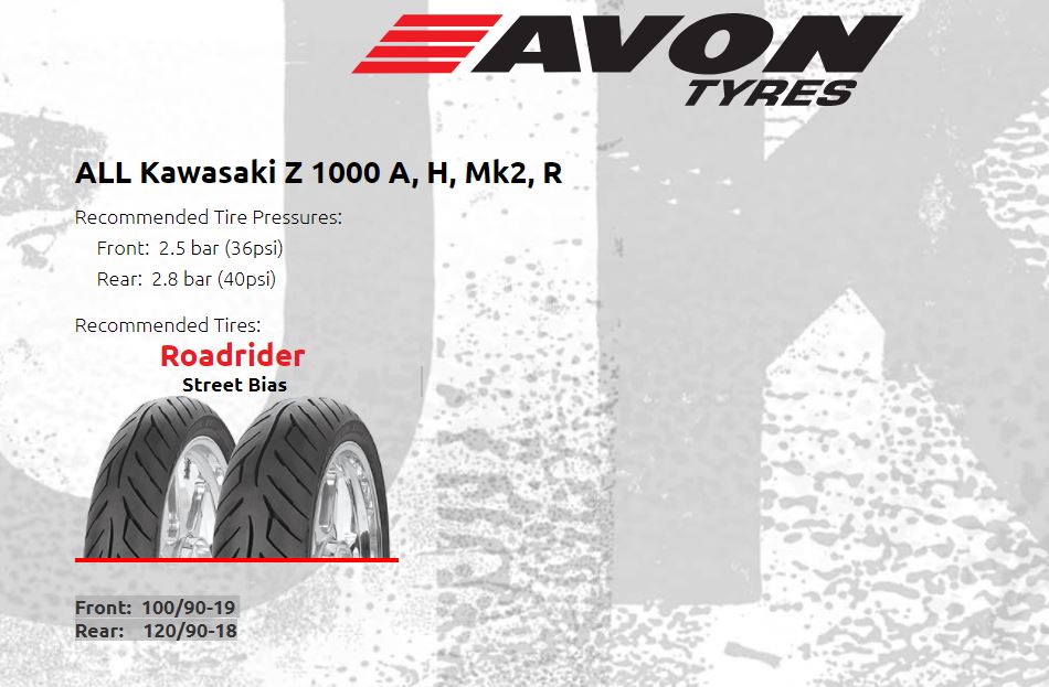

suggested rim size for that tire off Avon's website is 2.15-2.75 but that likely will be fine as 100/90/19 recommended size is also 2.15-2.75.
OUr bikes were designed for a different tire design, a 3.25x19 tire being the OEM size. they have a different sidewall structure allowing a smaller rim. Avon still sells the old sizes. I have them on my kz750G
www.avon-tyres.co.uk/motorcycle/roadrider

Avon recommends these sizes for the KZ1000. Changing to an 18" front just changes the diameter, not the width.
Front: 100/90-19
Rear: 120/90-18
Front: 100/90-19
Rear: 120/90-18
Last edit: 21 Oct 2017 12:01 by Nessism.
