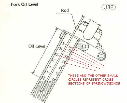

Yes, It says to elevate the front wheel off the ground, then insert a thin rod down into tube and measure the distance from the top of the inner tube to the oil level. The distance is 426 mm. My question is to measure that, do you remove the spring ?

The KZ1000-A2 etc. manual shows the springs in during measurement (see image below). Check your KZ1000-A1 manual to see if the drawing shows the springs in. Ed

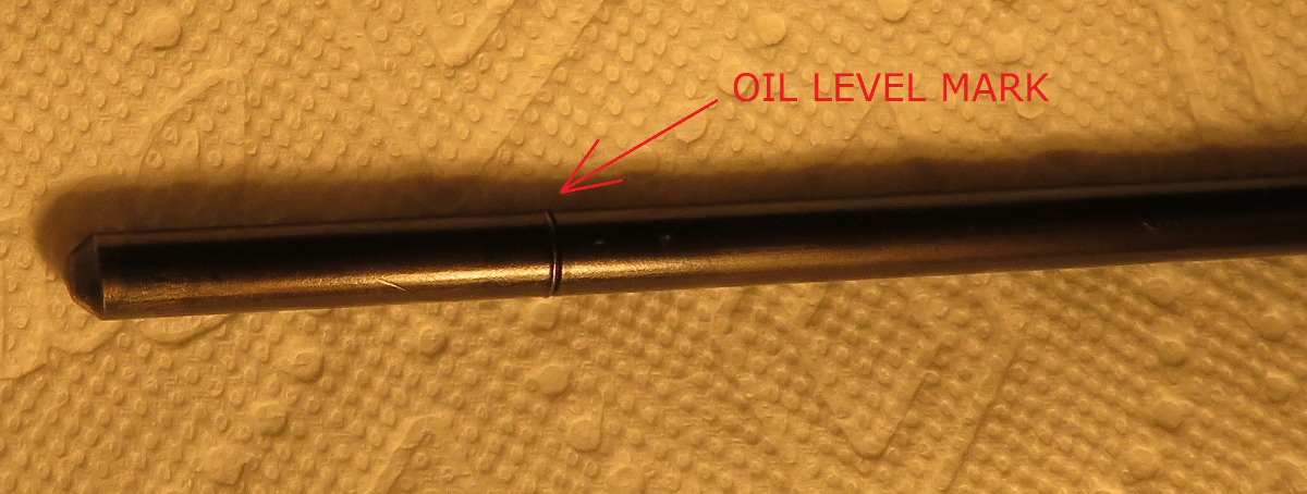

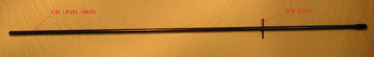

12 Aug 2017 07:36kzdcw wrote: Ed, I'll have to find some sort of Rod that will fit thru the fork springs and will touch the oil. Any suggestions ?
A wooden dowel or metal rod will work fine. Make a mark near the top of the rod and a second mark the specified distance down the rod then hold the top mark even with the fork tube top when measuring.
I modified a metal rod by inserting a smaller metal rod through it near the top, measuring down the rod the specified length from the manual, and marking that distance near the bottom end of the rod by scribing a line around the rod using a tubing cutter. Because the small metal rod fits flush against the top of the fork tube I can just drop it in the tube and pull it out like a car’s dipstick. Making it took a little bit of time, but now I can accurately measure the fork oil level very easily. Overkill for sure, but it was raining outside the day I made it. :laugh: Images below. Ed

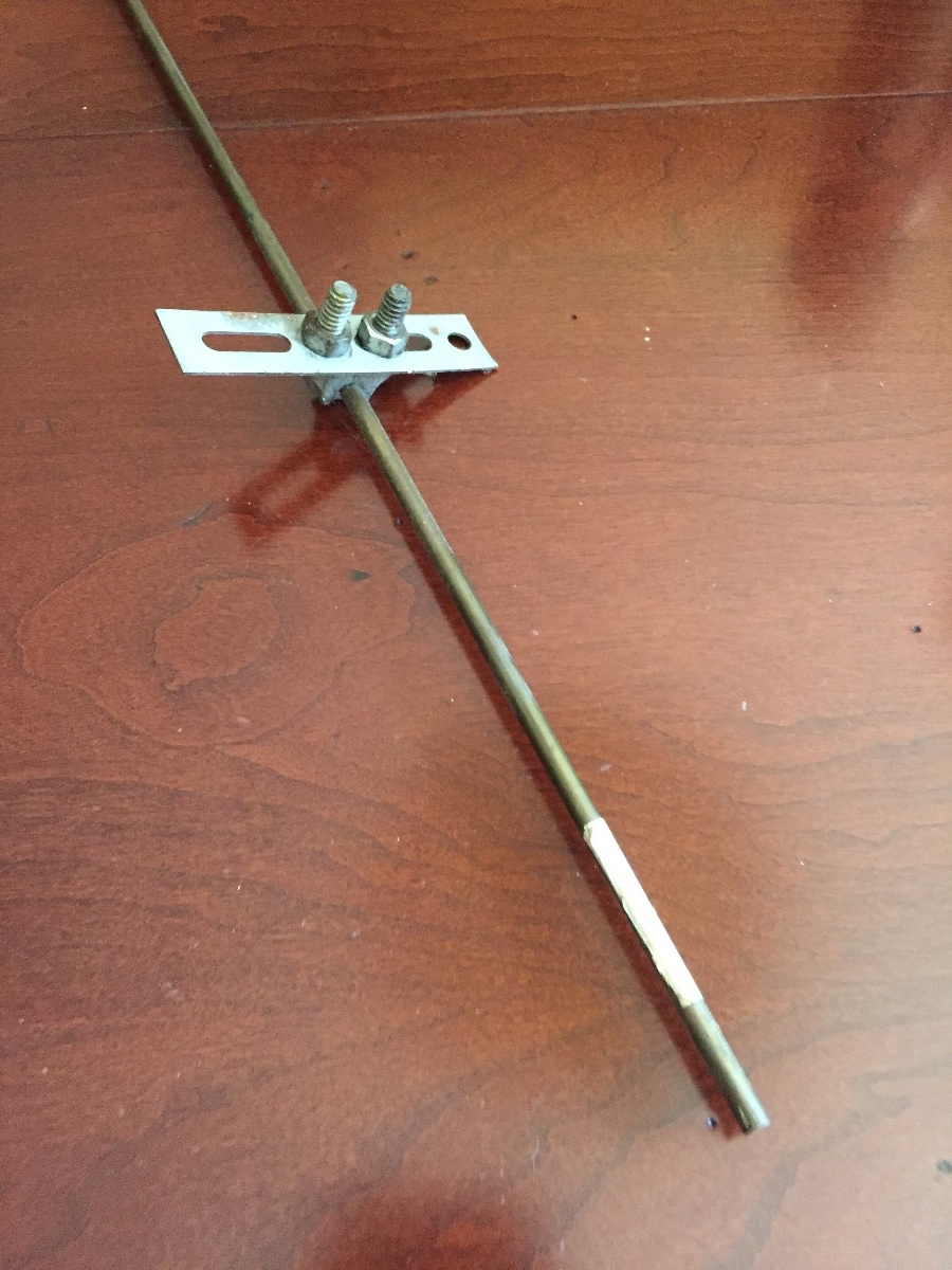

I use this less elegant tool. Tape marks the desired oil level. The u clamp lets me adjust for different bikes. It is a brass rod, a u clamp and a piece of plumber's tape.
