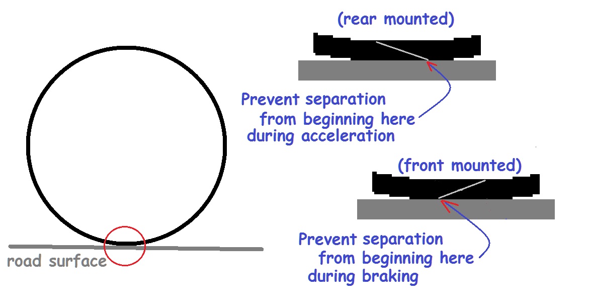

I believe, but am not positive, that when manufactured, the area where the tread connects is an overlapping area that best resists separation from acceleration force in one direction (on the rear) and best resists separation from braking force in the other direction (on the front). This refers to pressure applied to the tread connection area by the road surface during acceleration or braking.
If the tire at hand is intended for a different rotation on the front than is currently fitted, I would have the tire remounted to comply with the prescribed direction. Because the "V" slots are likely designed to promote traction in wet condition by channeling water away from the tire when rotating as prescribed by the manufacturer.
