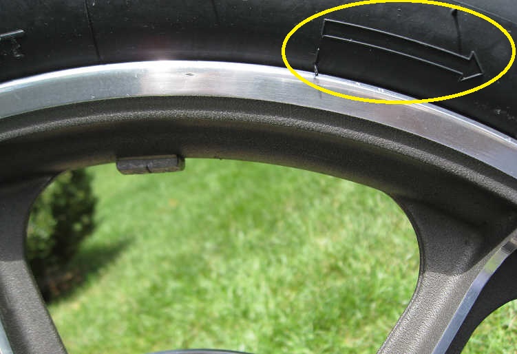

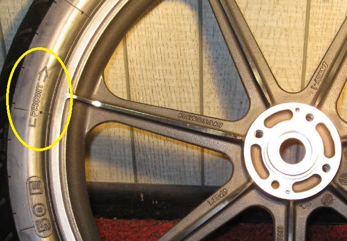

Look for an arrow that shows the tire rotation. Different makers use different arrows, but you should be able to find them. Here are a couple examples of what to look for. Ed
Pirelli Sport Demon
Michelin Macadam
Pirelli Sport Demon
Michelin Macadam
